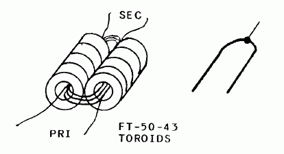

has anyone ever considered balun type transmission line transformer instead of toroid. I think these type transformers are a little easier to wind and have very little leakage inductance. Primary is usually made of copper tube onto which toroids are stacked, secondary is then wound through copper tubes. Because of large ferrite cross section only one turn (tube) primary is necessary, for push pull one can use even half turn by using fork type winding (right side of picture).

Aha it's very simple. I used the glued double toroid (rectangular profile) in the my DIY car audio class D amp .5Kw, 84% total efficiency (93-95% are amp efficiency, and 89-87% SMPS) and cloned it about 10 times- never seen any problems. Stacked toroids with ellipsoid profile, i've seen in the MTX 500D car audio class D amplifier in the output filer coil, but for transformer these will be worse vs rectangular, however not so much. Actually, art component is pretty poor in the car audio SMPS (<1Kw) theme, and i'm impressed by posts quantity&quality on this thread
