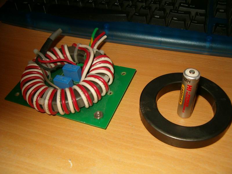

For secondary magnet wire selection take into account that more air-exposed wire area allows for more dissipation with same temperature increase. If you had 1.5W for each primary with 6x 0.2m=1.2m total lenght of wire, you may allow 3W for each 2m secondary. If primaries are somewhat internal and secondaries are somewhat external you may also allow even higher dissipation on secondaries
Remember to wind it as thight as possible to reduce secondary wire length and leakage inductance
If you are planning to test the amplifier with 2 ohms at full power [ie: bridged], I recommed increasing wire cross section of both primaries and secondaries since my initial calculation of 35Arms per primary was for 4 ohm per channel operation [winding and board-mounting the transformer with more magnet wire will be somewhat harder]
Actually, that's about right, because each of my two channels pulls about 230 watts in 2 ohm. I realize that I'll have to put more than 460 watts in to get 460 watts out, so I decided to stick with the six-.8mm primaries though you mentioned that I could use less. I really have only planned on using 37V rails on my circuit, but I am shooting for 40 because you always seem to get less voltage under real world operation. Does that sound reasonable?
Also, I could send you some of these diodes if you have a special project in mind, I think you deserve it, you're one of the few that actually stick with people until they get it right.
See if you can avoid these types of crossovers, IMHO.
You may try to wind the secondaries turning two or three times around the entire core, instead of just one time, to increase wire tilting. It will also require more wire lenght but leakage inductance won't increase
Another option is to divide the core in two or three equal sectors and wind two or three independent primaries [one for each sector] connecting them in paralell externally
Wire crossovers are ok as long as you coat the core with varnish, epoxy or something consistent but flexible that allows some dilatation but avoids wire vibration and/or displacement. Otherwise, once the amplifier is installed in the car and exposed to vibrations, you will get random shorts between turns/windings in the long term [this happens also in some brands of commercial amplifiers]
Also, I recommend glueing heavy components [like big capacitors] to the PCB since vibrations cause stress to the leads and this produces fractures or bad solder joints in the long term

Your thoughts are good. If turn number 3 of one winding strand shorts to its counterpart, then the result would not be a shorted turn and catastrophic failure. But as Eva mentioned, if the enamel wears off at the contact point, it can cause a little variation in the transformer behavior. A cross also pulls the winding away from the core a little, slightly altering the coupling, and usually with each cross, another cross must bring the winding back into proper position. It would be worse with more than one layer. The crossed wires take up much more space.
A trick I use before I wind toroids is to start with about a 1 to 2 foot length of the winding and then bend the wire back in half and spiral it back down along the 1st length. Keep going back an forth so that you end up with a stick of spiraled wire. Each spiral twists in the direction opposite to the one below it. You now have a wire stick to feed around and around the toroid unraveling it little by little as you add turns. This method is most helpful for winding large toroids with many turns--mostly irrelevant for SMPS power supplies for audio.🙂
probably. anything will work as long as it's thin and insulative. I've even seen some toroids with woven fabric on the primary in addition to the enamel. Enamel probably is polyurethane, I'm just not worried enough about it to notice when I select my magnet wire.
