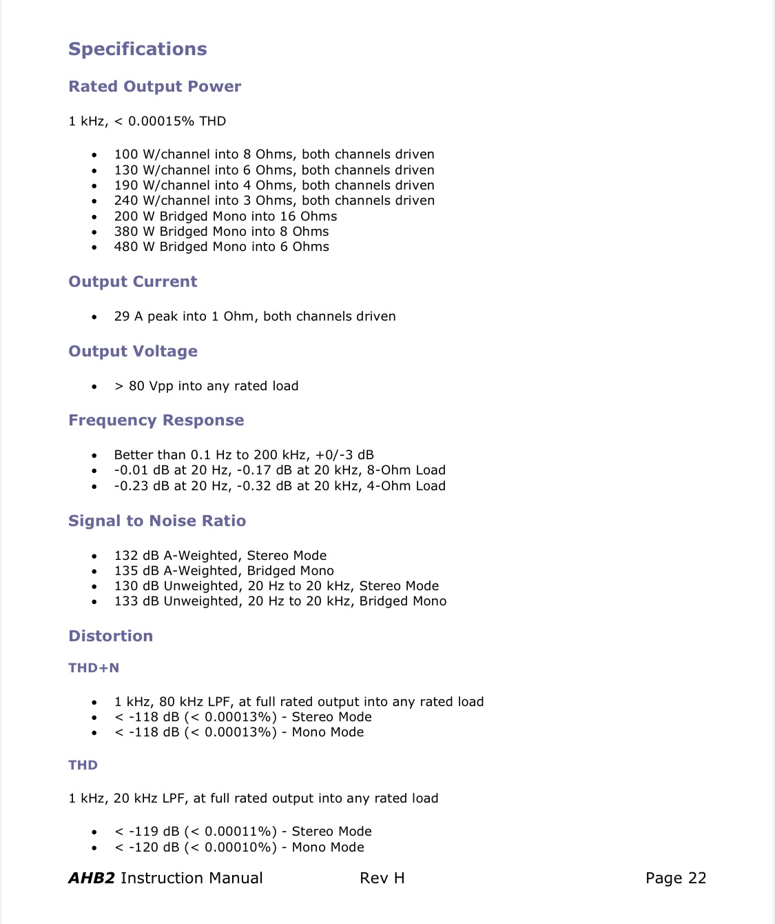

Lowest noise of a power amp available. By far. But I'm not sure if there is a source which has low enough noise to 100% benefit from it ...So what’s the benefit B100 in comparison?
The speakers that I have need at least 20W amp drive as recommended by the manufacturer. Tried that level in the past with diy amps of that rating but sounded a bit thin at typical levels. Then switched to AHB2 and this shined with authority and the low distortion levels. Occasionally, I turn up drive to punchy levels (not particularly loud)
The point is re:B100, I don’t want something pretty at lowish power and then trips all over the place at higher drives
A mid-fi Yamaha met its power ratings without difficulty. Surely, a high-end amp should do the same.

Most people have no "feeling" about crest factor from music and what amplifiers really need to deliver for listening to music.I was hoping at least around 40W continuous drive at these levels of low noise
Brutal modern mastered music has a crest factor from 10-12dB, so roughly peaks are 3-4times higher as RMS values. That's already pretty dead and actually not that easy to achieve when it should still sound like music. Pink noise has about 10dB crest factor.
10dB crest factor needs 3,162 times the voltage or 10 times the power between peak and rms value.
Your 40W continuous amplifier needs to deliver 400W peaks to reproduce dense mixed music!
4000W for dynamic/live music and even more when you listen to unmixed signals during recording.
Of course it doesn't work that way - we have a maximum power of the amp and depending of the music it needs to deliver more or less rms power when turned up fully. But rms power is ALWAYS WAY smaller as the needed peak power!
Topping B100 with a low impedance, low sensitivity speaker will get into troubles - you need to buy at least the B200 in this case. But for more relaxed situations it will work just fine.
Therefore it's great to have all these measurements so we can determine the use cases - on measurements, not on "feelings".
p.s.: Amp power is widely over and underrated at the same time. Listening at good living room level (about 80-83dB) will often just need 1W or less on RMS power, peaks are no problem. Just rising to loud (>90dB) will use 10x the amplifier power with peaks >100W needed. Listening beyond that needs a speaker with good sensitivity and a high voltage amplifier to get enough dynamics to not run into power compression/clipping.

I am looking for something similar to AHB2 specs in B200s before making a decision for a more expensive productTopping B100 with a low impedance, low sensitivity speaker will get into troubles - you need to buy at least the B200 in this case. But for more relaxed situations it will work just fine.
