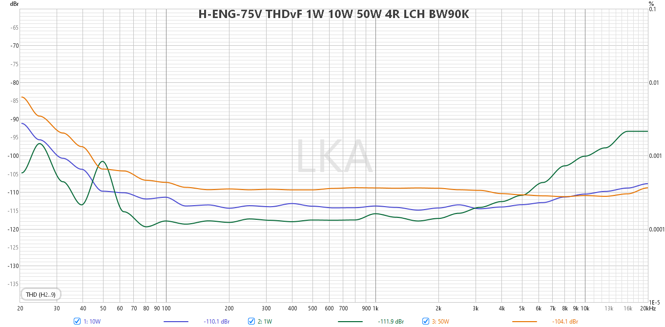

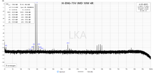

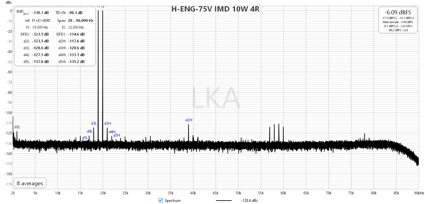

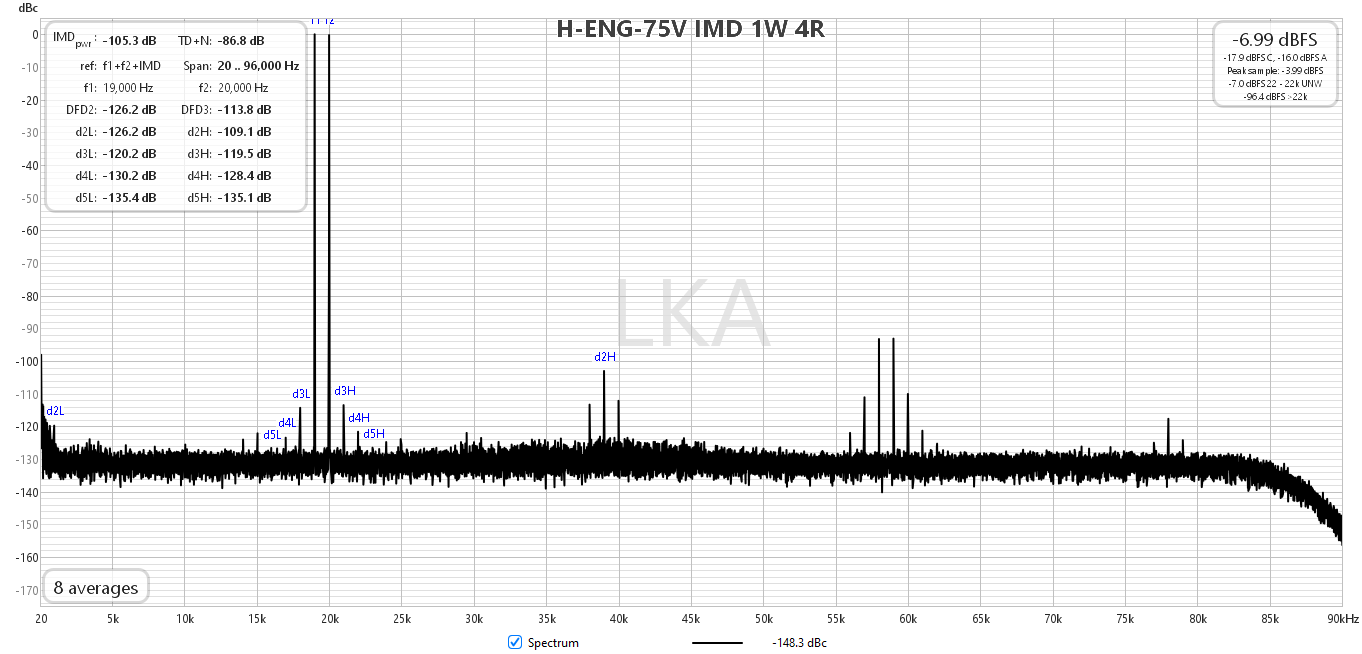

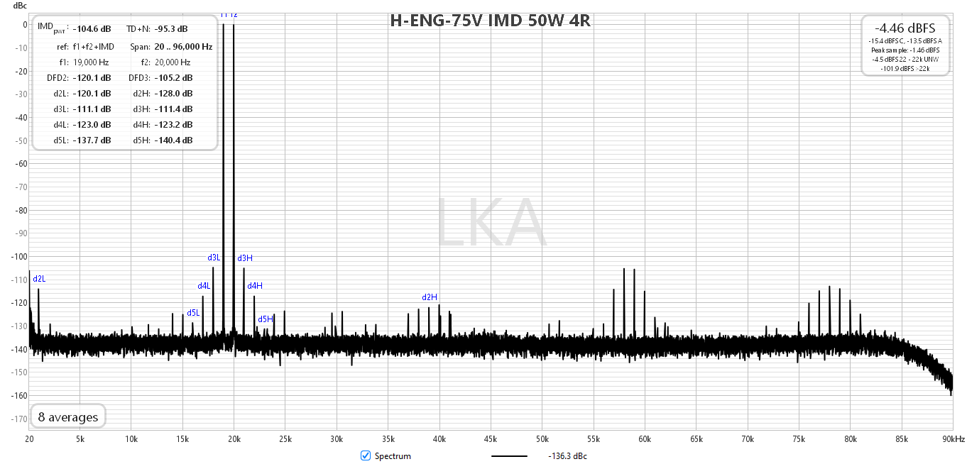

example, discrete power amp
single supply 75V, 100W/4R, output capacitor, overall power consumption at idle 3W (one channel), no emitter resistors, output transistors idle current 3mA
What is the 40K + 60K , SMPS "garbage" ??discrete power amp
80K with load ??
Hi LKA
aha...............here is your monster😉

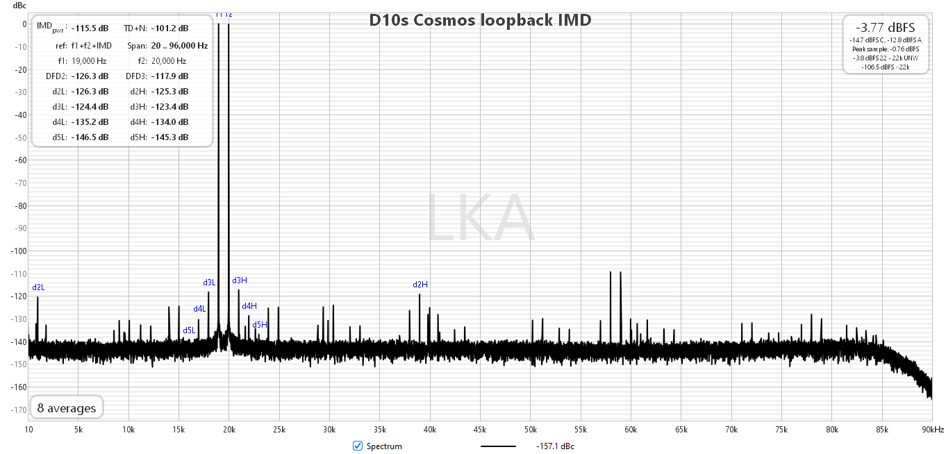

I think Cosmos ADC issue, see loopback D10s -> Cosmos

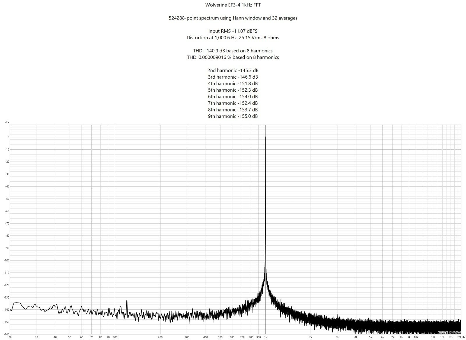

Into an 8 ohm load, 20 W seems to be in the stable operating range of the B100:
- https://www.audiosciencereview.com/...ping-b100-amplifier-review.57036/post-2146653
But 8 ohms fixed is unrealistic load. There is no multiway passive speaker with impedance remaining above 8 ohms in all passband, and even many raw woofers with 8 ohms nominal impedance actually have minimum impedance dipping below that numbers.
So here we have a perfect product catering for uninformed ASR minions with their obsession for 5W SINAD number and cheap construction with an excuse that crest factor of actual music is typically much smaller than sin wave, so there is no need for continuous signal testing
