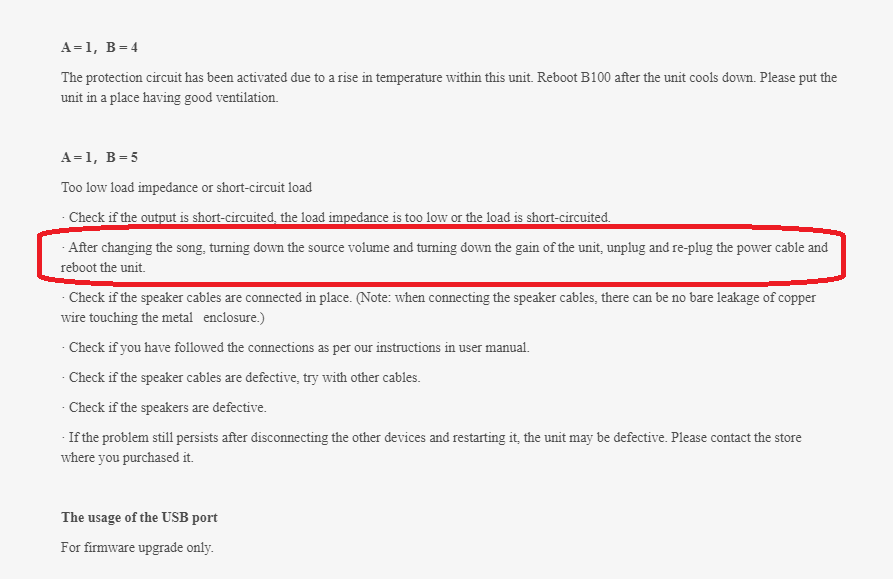

I'm sorry to hear that and was wondering if you tried using a lower gain level.My little boxes went into protection during 'normal' use several times.
In the spirit of contributing to issue solving and not knowing if it has already been said I was just wondering if you tried using a lower gain level.
The protection issue was also reported in this thread and in the same page it seems that with a medium gain the power reaches 86W.

By the way, the highlighted procedure seems to me a bit particular, though...

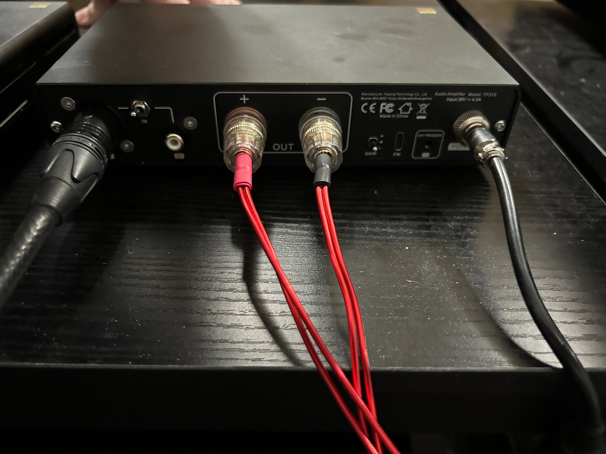

May I ask what the sensitivity of your speakers is? How are you driving the B100? Cinch or TRS input? If TRS, with a true balanced signal or with an adapter?FWIW - My little boxes went into protection during 'normal' use several times. They should not be allowed to advertise these as 100W amplifiers, IMO. I won't be trying out the B200 based on my experience with the B100. Topping kind of let me down with these. I had high hopes. I cannot recommend them, because I am now of the opinion that they certainly do not "work as advertised" like I thought.

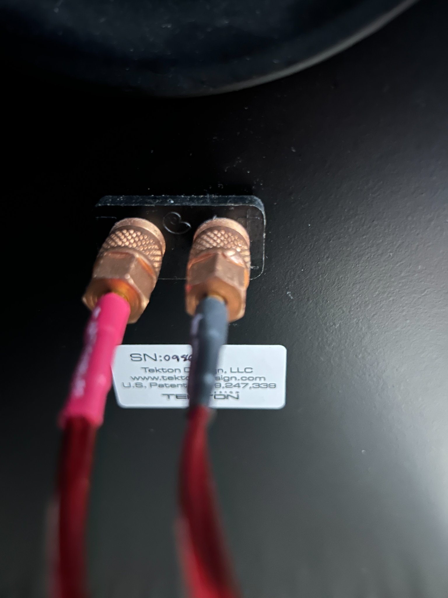

2 - Sure they're cute, but when a fairly typical pair of speaker cables drags them off the rack... it's annoying. Anyone using spades will likely be quite irritated.

^ Thank you! Always good to 'RTFM', which admittedly... I did not. But...
My pre-amp is set to 0dB gain (at the moment) b/c I didn't want to over-drive the B100. Source will output a clean 4Vrms through balanced output at 0dBFS. Many times I drive an amp straight from the source (old AKM D90). I am particularly averse to clipping, so I tend to do everything I can to avoid it. Plus, it's only on rare occasions that I need a lot of voltage swing.

I am in MN, USA. The units are in my basement on an open-top rack. The ambient temp is ~20C. So... let's call that 'normal'.

Tekton DI are 'rated' at 98dB / 2V8rms / 1m. 4R nominal. Never seen a decent published impedance curve. My gut says they're rated fairly ambitiously. If someone has a reliable source for a plot, I'd be grateful. I generally think they might dip to 2R in the bass region. One of these days, I'll learn to measure it.

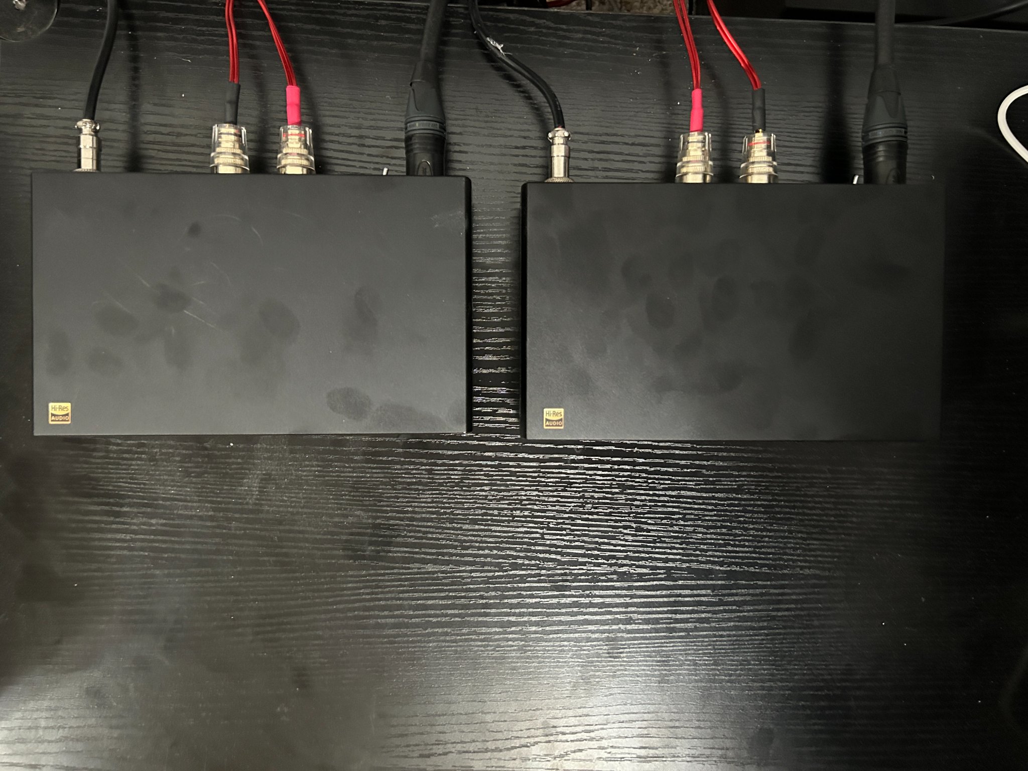

Quick pics of the mess. 🙂 They're playing now... again... they sound 'nice to me'. I've got the DIs hooked back up.

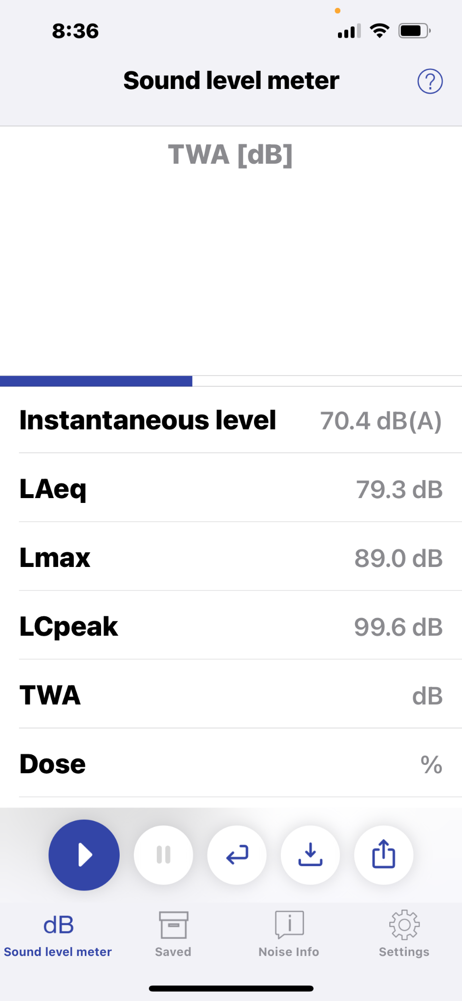

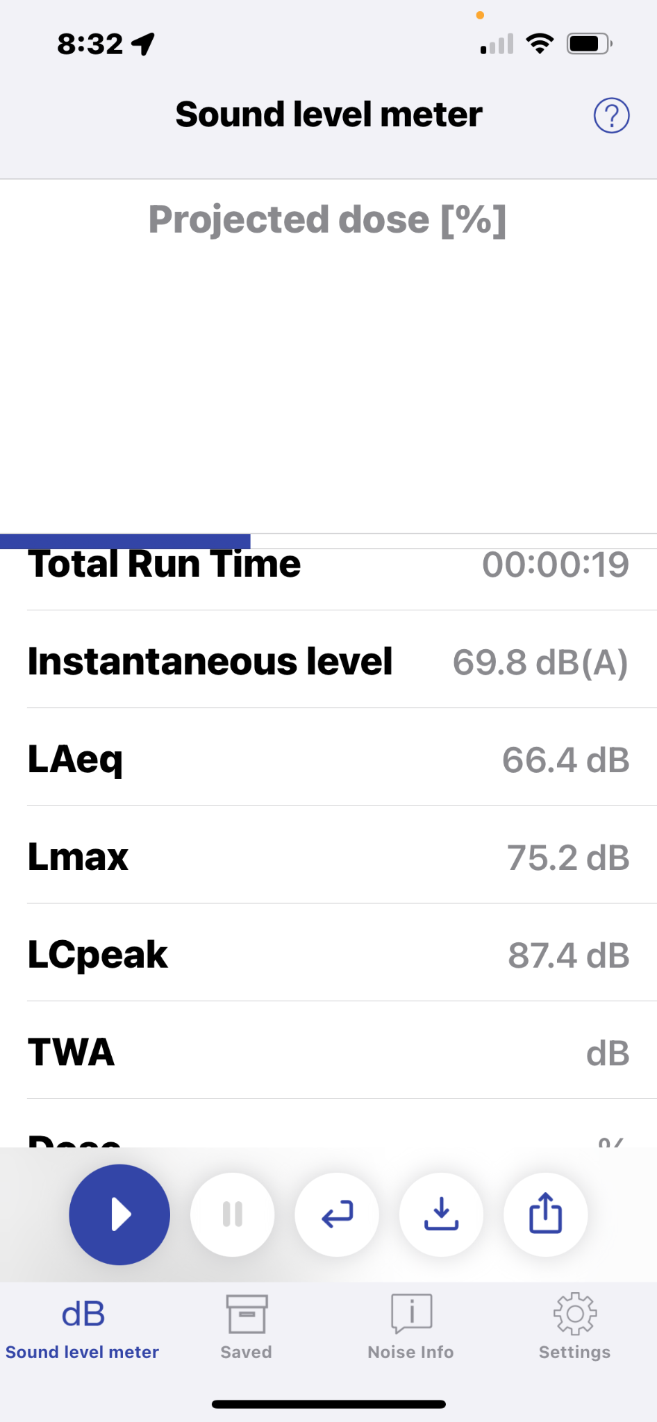

Here's some 'reference' points. This is all with NIOSH SLM app on an iPhone and a complete dolt at the controls. So, grain of salt. Song will be noted as something "typical" that I might listen to at that level. I ran each for about 20s or so during a "normal" part of the song. Readings were 'reset' between each b/c it averages. So scientific, I know. <sarc>
With DIs -
Had tunes at my 'normal quiet' level. At listening position (WAY off axis at the computer) about 2m from the left driver and 4m from the right.
Frank Sinatra "Witchcraft" - I tried to get the horns b/c that section 'seems' loudest to me.
At chair -
Doesn't hold it, but glancing - max instantaneous level - ~70dB(A)
LAeq - 66.4dB
LMax - 75.2dB
LCPeak - 87.4dB
TWA - N/R
Dose - N/R
Projected Dose - N/R
Screen shot attached b/c I really don't have a clue what I'm doing.
Same song 1m (est) from left speaker ear height sitting -
Doesn't hold it, but glancing - max instantaneous level - ~80dB(A)
LAeq - 79.3dB
LMax - 89.0dB
LCPeak - 99.6dB
TWA - N/R
Dose - N/R

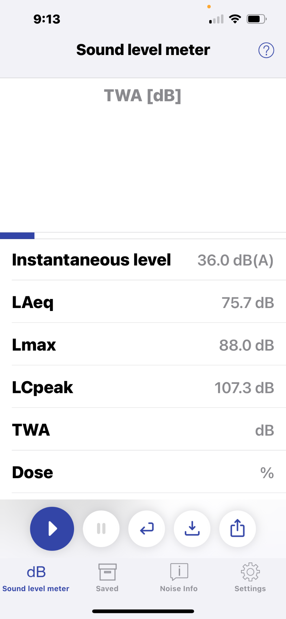

Quickly! Did something to show what I MAY do on occasion if people are over. Plus... wifey may smack me over the head with a headset (and she's a floor up and on the opposite side of the house).
Song - Bela Fleck - Flight of the Cosmic Hippo - (b/c I know it has bass)
Went into protection at at about 1:10s (1 blink then 5 blinks) into the song on a bass drum kick. Took a quick video of 'error code'. Oddly... only right channel this time. Was this 'loud', yes. Was it ludicrously loud, no. Do I expect to be able to go to '11', yes. Was I able to hit pause on the SPL app to capture properly before I hit pause on the music, no.
Did a reset of both amps (just in case)... and knowing about where this song kicks it in... wanted to repeat it so I could get numbers.
LAeq - 75.7dB
LMax - 88.0dB
LCPeak - 107.3dB
TWA - N/R
Dose - N/R
Again, that's at "the listening chair". Didn't want to try it again at the speaker. Screenshot attached. Oddly... the left amp went into protection this go around.
Hope that helps.
Not going to intentionally send them into protection again. I'll wind up keeping them, so I don't want to damage them.
Note in all screenshots the meter is "paused" but still shows the active "instantaneous" reading. Those aren't really relevant in the screenshots, when I remembered to look down at the phone and remember the instantaneous posted highest peak I saw... I jotted it above.
tl;dr - yep, even with DIs, they still go into protection under an atypical for some, but expected for me, use case.
Edited to add since above is pretty darn long - at 1:13 in or so... the bass drum kick will send the amp(s) into protection at a level I find "loud". I don't often listen that loud, but I sometimes listen louder. Also, that song is streamed from my NAS burned from CD. I don't use level correction (sometimes) in Roon. So, one other practical consideration is even if I keep the level down enough for THAT song to not go into protection, I'd almost guarantee that any song I stream from Qobuz if I don't have levelling on will put the amp(s) into protection if it comes after Flight of the Cosmic Hippo from my NAS.
Once again, I hope that makes sense from a practical / use case scenario.

Went to my workbench - about 6m from the speakers off axis to right.
Witchcraft again
LAeq - 72.6dB
LMax - 82.4dB
LCPeak - 94.0dB
TWA - N/R
Dose - N/R
LAeq - 75.7dB
LMax - 88.0dB
LCPeak - 107.3dB
TWA - N/R
Dose - N/R
Hope that helps.

Anyway, please note that in attached pictures of the two power amps, the speaker cables of the right channel seem reversed.

They sound very nice (to me) at all volumes where they work. They 'stop working' at a level that (to me) is not acceptable for an amplifier that the manufacturer would like us to think is "100W". Given that there really is no working standard (at least in the USA) for this, I can't call the claim deceptive, but ... it seems very careful.
There may be a standard for amplifier power in the USA (again) soon, from what little I understand. That will hopefully help.
So, I don't feel "cheated", but I certainly can't recommend these amps to people if they feel like they need a "100W" amplifier.
It is too much of a pain to send them back to the retailer, and I can use them for other things. So, I will keep them. If I could take them back to a local store and get all my money back, I would.
Other people may feel differently about the power claim.

Tell me about it! 😀I type a lot.
It's not you, it's a limitation of mine that I can't read (the translations of Google) for too long.
However, just out of curiosity, why are the right amp cables colors reversed?

OH! I forgot to answer that in your earlier post. They were/are reversed at the amp on that channel. They are/were wired in phase though. The DI's don't have a clear + - on the back (that these tired eyes can read). They're very small and in the same color as the backing. I should mark them with a white pen. When I hooked up that channel first, I realized I did backwards at the speaker... Dark corner of the room, and I was lazy. So, I just connected the amp the same for that side. 🙂However, just out of curiosity, why are the right amp cables colors reversed?
If you zoom in, you can barely make out the + / -
I went back and swapped both... just to be proper. Thank you. 🙂
