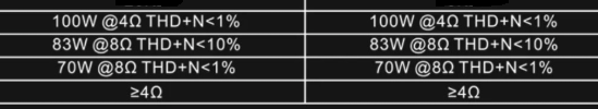

The manufacturer claims 70W into 8 Ohms and that the load should be greater than or equal to 4 Ohms.
Some sites selling in Europe state 50W into 8 Ohm and 100W into 4 Ohm which seems (more) realistic.

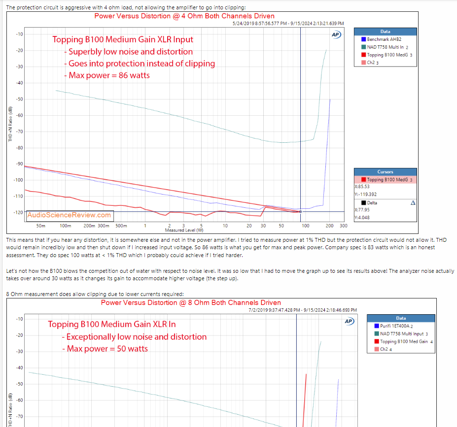

The performance measured by ASR seems simply extraordinary, then it seems unlikely that it could sound bad, right?
My guess is that the extremely low level of both distortion and noise leads the listener to turn up the volume, but the device is designed to go into protection instead of clipping and so it still deserves the attention that many give it.
Clipping as in reaching max output voltage? The protection triggers way earlier, at less than 12 V RMS into 4R, which is about 34 V pp
It seems to be load dependent, and I don't know the source of your statement or I missed it. 🙂
However, for what it's worth, the following are related measurements from ASR website
Topping is certainly not the first manufacturer to claim a bit more power, but Topping doesn't say anywhere that B100 is a 100W amplifier into 8 Ohm.
There was quite some discussion about this in the ASR thread. You get those high power levels only for very short bursts. Amir apparently uses only 20 ms long bursts, which is less than the cycle time at e.g. 30 Hz. Pavel used 800 ms bursts. I used continious sines which the amplifier is supposed to sustain for 5 minutes. In my case, about 2 minutes at 10 V Rms = 28 V PP were fine, but going to 11.6 V tripped the protection within 2 seconds and permanently damaged the amplifier.

Honestly I can not understand why some people still try to defend this product. Firstly, it does not get to the specs it advertised, which is 100W/4Ohms. Even when they reach near that 100W number, 86W/4 Ohms, it go to protection mode in very short time, which is bad and will not pass either IEC 60268-3 (for EU) or FTC (for US). Thirdly, it is a bad product for their targeted customer. Their typical customer will read ASR, own a 2way or small three way bookshelf speakers like Kef LS50, R3, ... or the likes with their sensitivity lower than 86dB/W and difficult impedance dips. With those kinds of speaker, if you push harder, protection mode will kick in. For me as an electronics designer, this one is a not a good product since a good product needs to work properly 95-99% of the time. A well-measured product is not a good product if they do not work.
It is a toy amplifier (in term of output power), but advertise as an adult amplifier. This is for me a huge red red flag about the integrity of this manufacturer. There is nothing wrong about a toy amplifier, like diyaudio Pass ACA or Schiit Aegir as they have their space in powering very high sensitivity speaker, but at least they are honest about it.
Well, it is certainly the best measuring amplifier reviewed by Amir. And I am not just talking about 5 W, 1 kHz SINAD and HD. Even 15 kHz THD+N is excellent over the full power band, as are multitone and two-tone IMD. That is no small feat.
