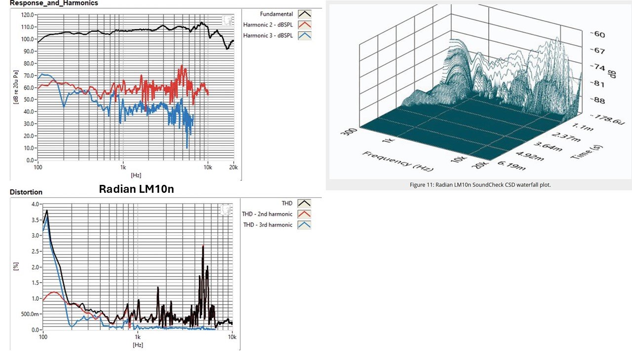

Gets to the core of the issue I'm trying to figure out.
Your comment "using the LT10 below about 600Hz is not advised because this is where distortion is starting to rise and dipole losses are getting larger." made me recheck Dickason measurements, copied below.
Help me understand: on the left, H2 and H3 exhibit significant rise until 300Hz and lower. But the CSD does show something is going on between 300 and 1000Hz. I'm confused as I would expect distortion to increase aligned with CSD, or CSD to behave below 1kHz as it does above 1kHz, but not one going one way and the other in the opposite way?
@LewinskiH01 Oops, I made a mistake! What I bought, tested/measured was the Radian LM8k not the LM10n! I only realized this after going back and looking for my measurements to post here. So the LM10n might be just fine when used lower than 600Hz. But for the PT5010, which I believe is similar to the LM10n, the FR is falling off and the distortion rising already around 500Hz (for a nude application). After you boost up the SPL to match the higher frequencies, distortion will also rise and this is why I (in my memory) felt that 600Hz was a good "not lower than this" limit the the usable/practical frequency response.
But overall this doesn't really change my feeling about planar midranges and OB/dipole applications. Moving coil drivers can go lower, take more power input, often have lower distortion, and IMHO are more reliable. But it really depends on exactly what you want/need to get out of the midrange and where that band stops and ends in your own design.

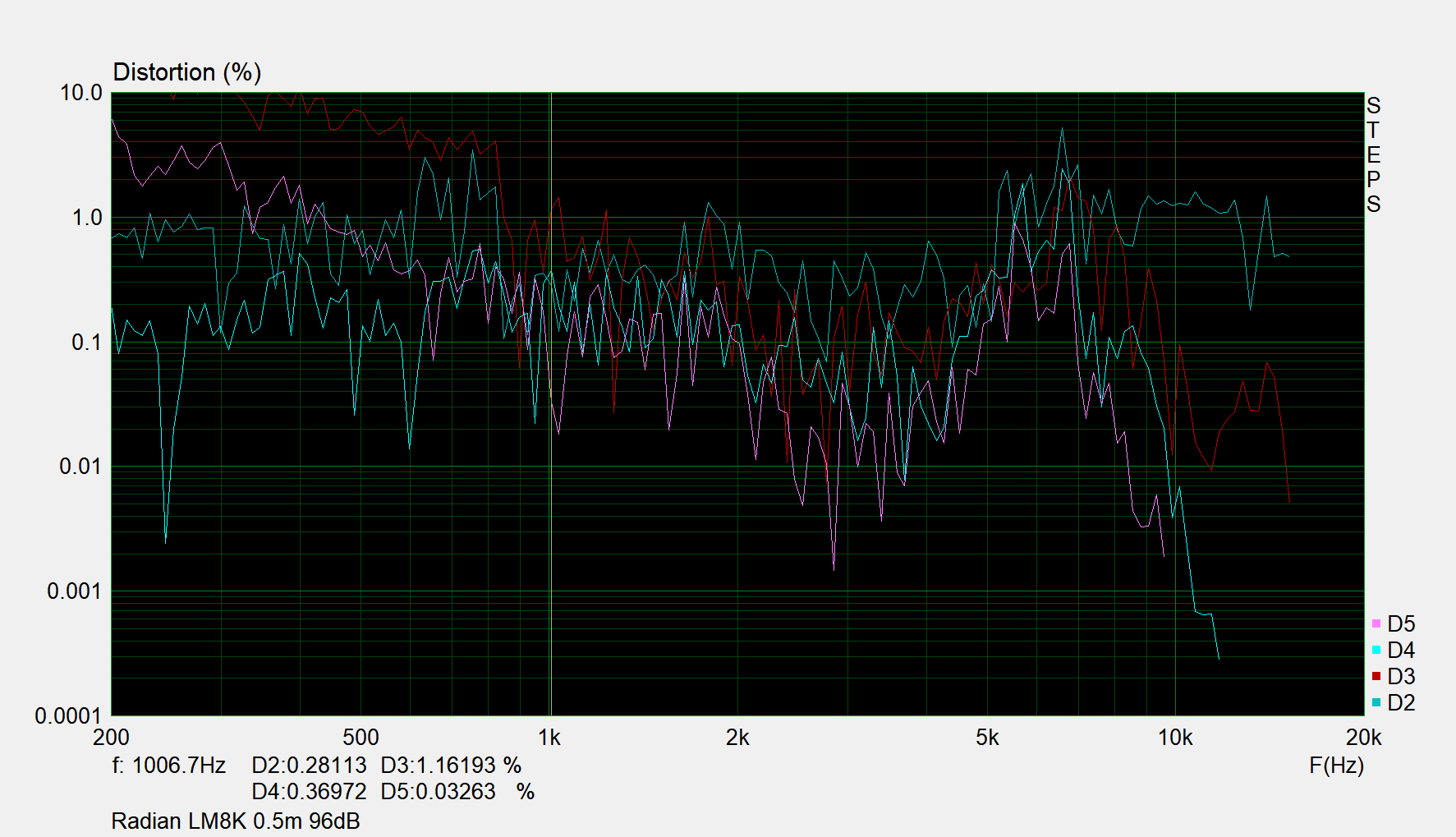

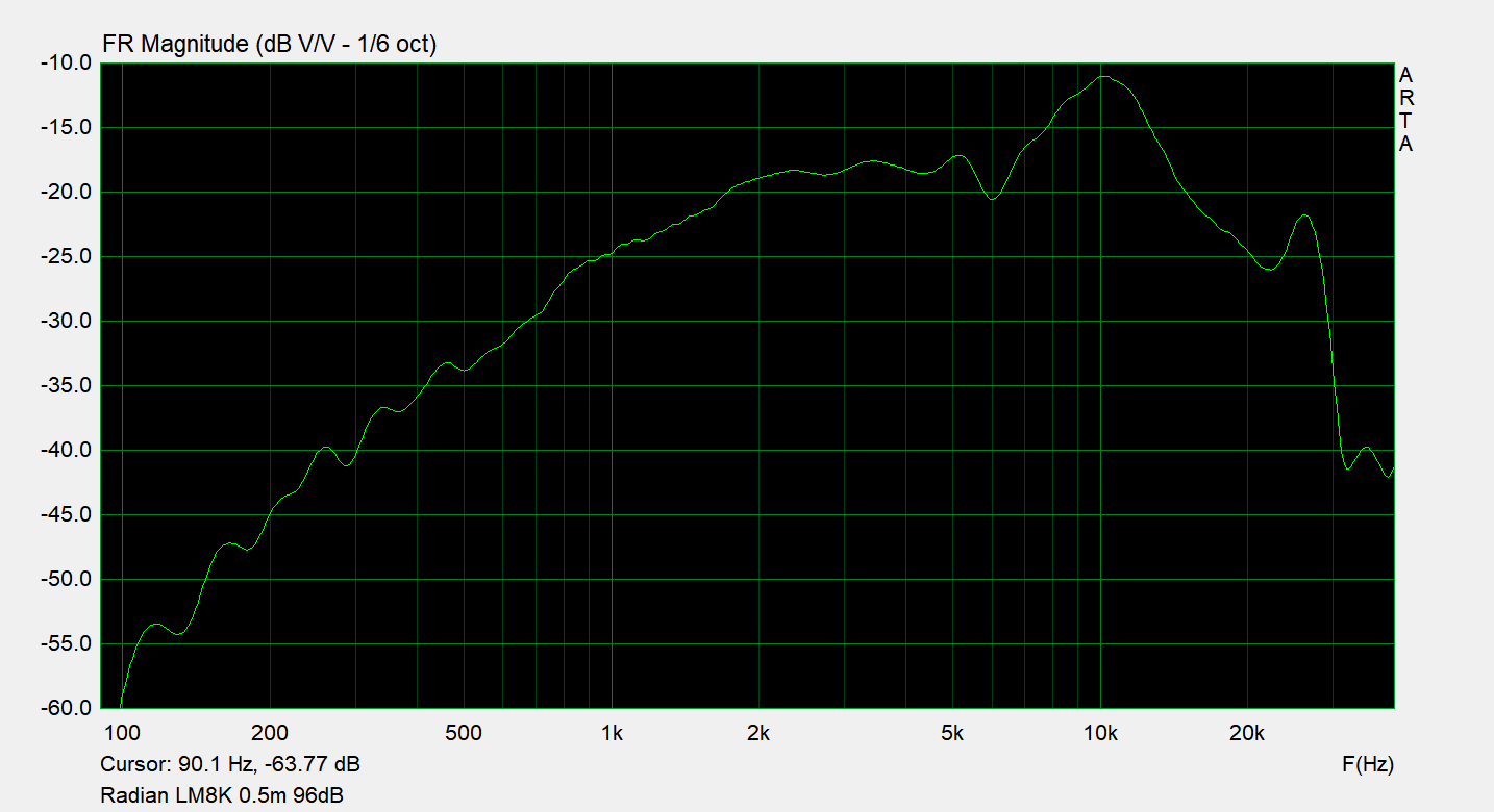

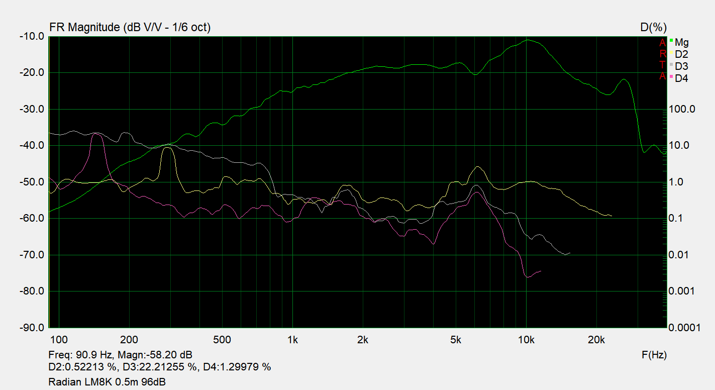

OK, but I did buy the RADIAN LM8k and measured it, just not the bigger one. The RADIAN design is definitely beefier/heavier but it hasn't really changed my mind about planars.
Here is my data on a nude LM8k, taken at a moderate SPL level... it's already exceeding 1 percent distortion around 800 Hz and getting worse below that. I do not expect the LM10n to be any better below 500-600Hz but I have not measured one myself so I can't say with 100% certainty. Yes the RADIAN units are better built, but the performance seems to be on par with the original B&G designs and not breaking any new ground IMHO.
