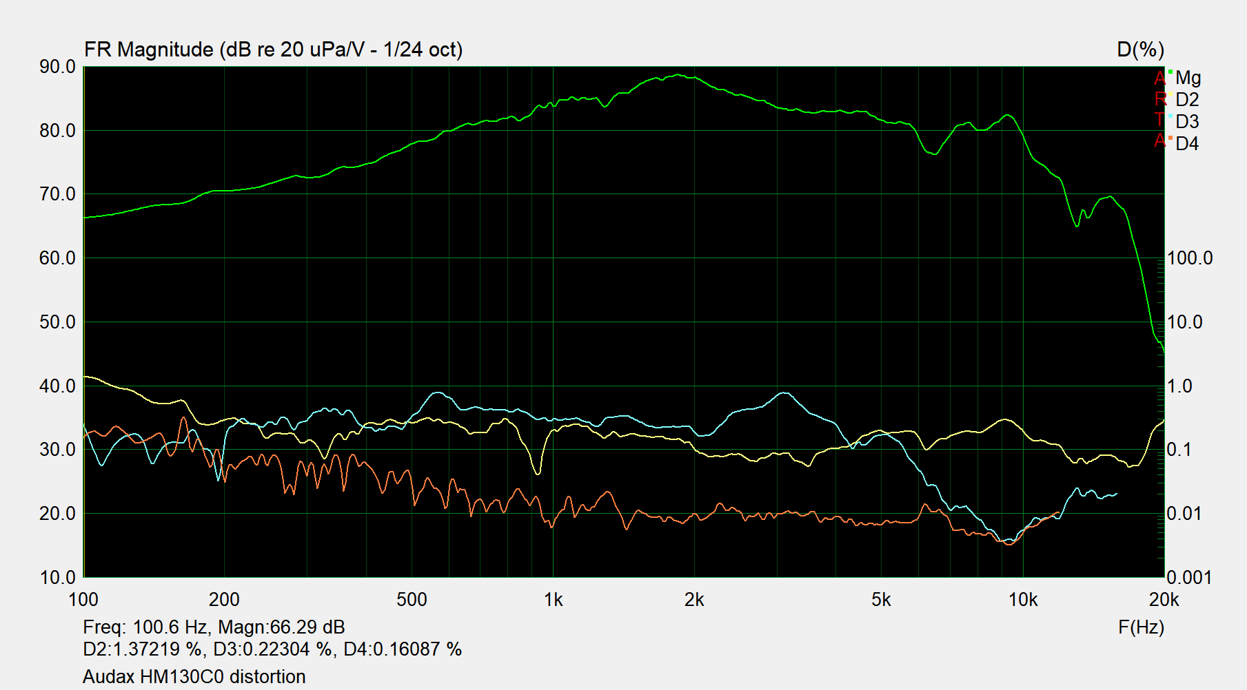

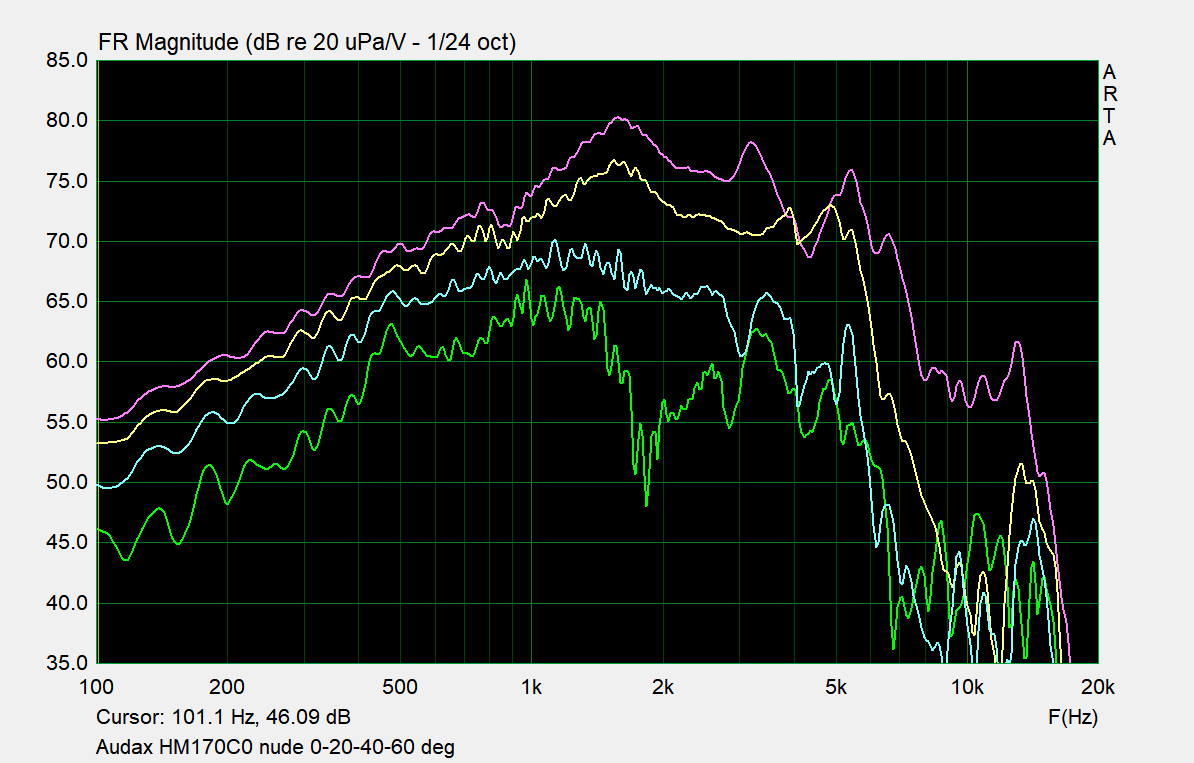

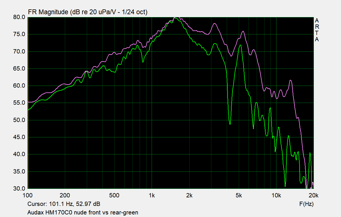

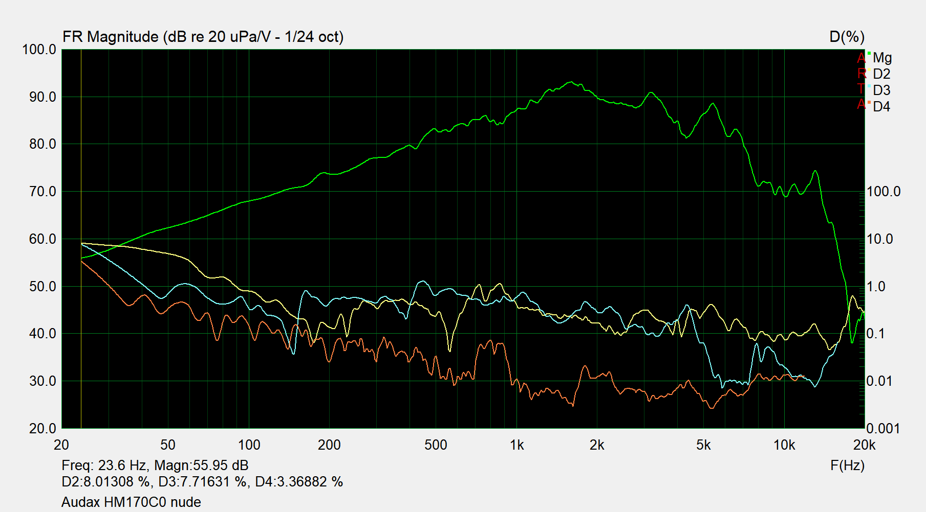

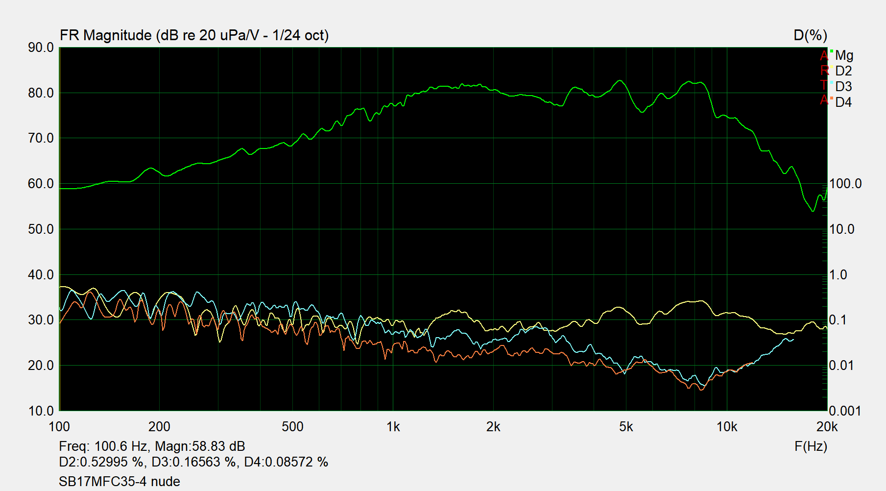

This driver is not bad. I measured it as a nude midrange a couple of years back. The FR is usable, but it definitely has higher distortion than the SB17MFC. See attached measurements of front on and off axis, harmonic distortion, and front vs rear (0 vs 180deg) frequency response.I like the Audax HM170CO for all sort of midrange applications, even OB. The midrange upper end is excellent up past 4k with its highly controlled, gradual breakup and good sensitivity.

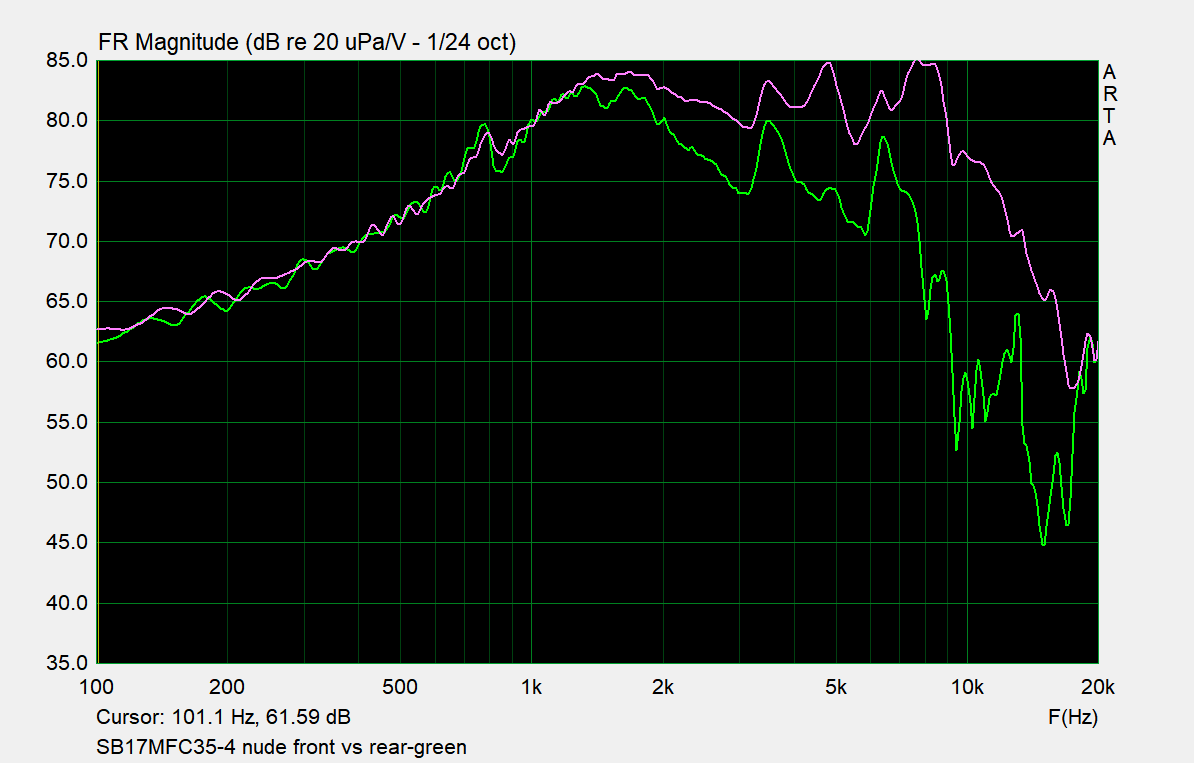

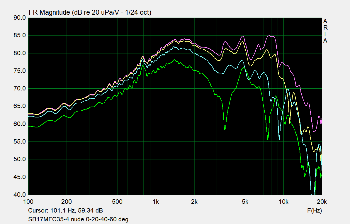

For comparison I am also posting my measurements under similar test conditions of a nude SB17MFC. IMHO the FR is smoother and stays together from 1k to 4k compared to the Audax.
I also measured this driver and used it in a system once, but I cannot find the measurements data now. IIRC distortion was relatively low but FR not as smooth as either the Audax HM170 or the SB17MFC. I am glad that Peerless is resuming production of this driver and it will or should again be available for DIY purchases.and the Peerless NE180W.

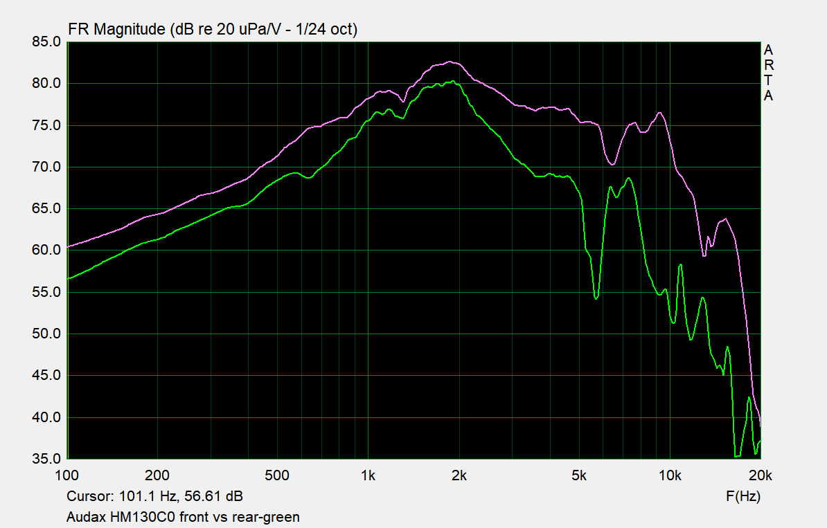

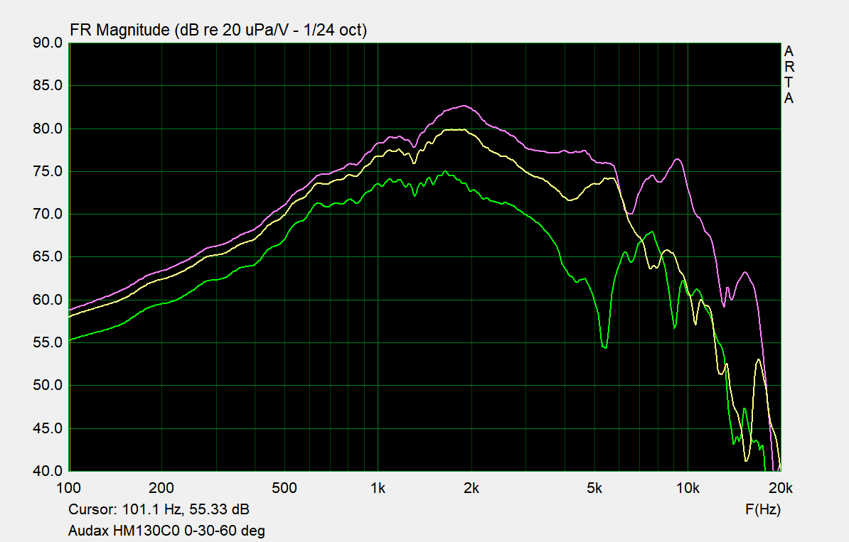

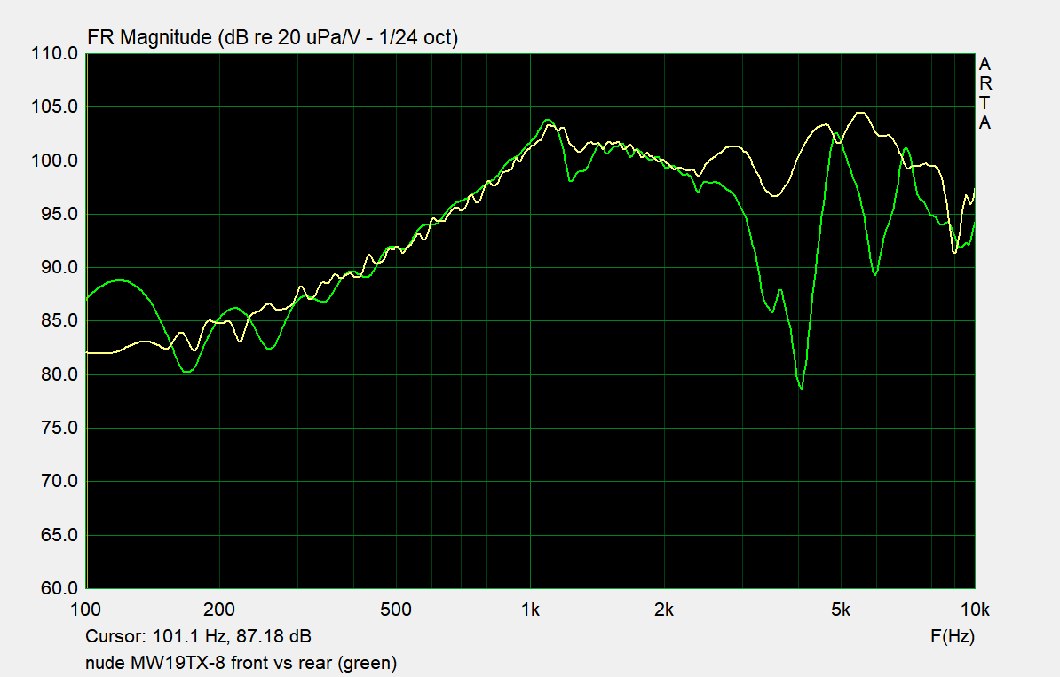

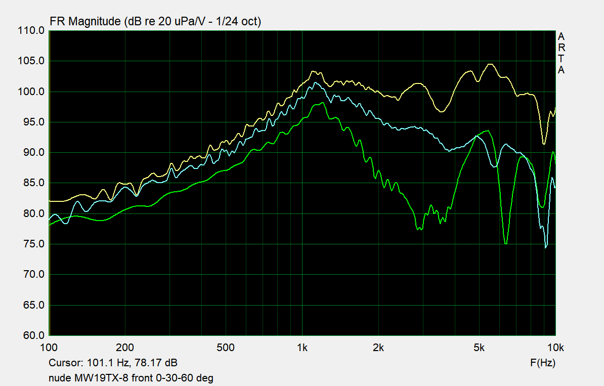

While we are talking drivers and nude midranges in particular, another good one is the little Audax HM130C0. FR is great in that application (beautifully controlled cone breakup!), and only the distortion performance is a little worse than other drivers (it has the same motor design as the HM170). It is a 5.25" class driver, so it can work a bit higher in frequency when used nude, but on the low side should probably be crossed over around 700Hz. So the next driver down in frequency must be able to crosso over that high. For comparison, I use a 6.5" class driver down to 350Hz and this makes is possible to build a 3-way dipole speaker, whereas the 5.25" drivers probably must be used in a 4-way system.
See attached plots. For the front vs rear plot, I forgot to match the levels but you get the idea. The driver is built like a tank and is not all that expensive. Looks cool, too.
@CharlieLaub Those are interesting measurements. The last time I measured the HM170CO, it was lower in HD than your data. That was likely due to the baffle size (or lack of it in your case). Its also possibly due to more of the driver being exposed, with the entire chassis contributing to the measured response, "warts and all".
Many drivers emit all sorts of weirdness when the entire chassis backside is exposed. Because these aren't necessarily the conditions a manufacturer intends for their driver to operate under, its going to show some increase in HD compared to a driver measured in an infinite baffle with the microphone placed and listening only at the front (cone axis) of the driver.

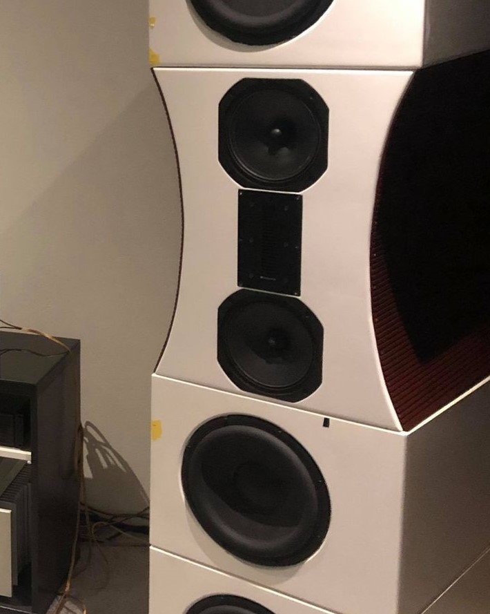

Nice driver, as you wrote, but 700Hz xo won't work with my midbass section.
BTW, I'm doing 4 ways:
4 sealed subs (12" Rythmiks in DIY boxes) up to 60Hz
SLOB with 8x 6.5" up to 470Hz
B&C 8PE21 on a 12" open baffle up to 1.1kHz
Beyma TPL-150H open back
In an active setup using Acourate for xo and filters, so linearphase steep xo are easy to do.
For now I'm considering the subs and midbass "done". Looking to improve midrange and tweeter. So the midrange needs to xo at 470Hz max.

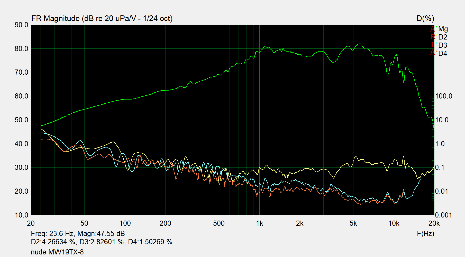

After reading HiFiCompass on MX19TX, PTT6.5M08-NFA-01, SB17MFC35-4, I'm thinking the SB is a very nice driver but performing a step below the other two maybe because it's a bit older design.
The MX19TX looks very good. As you mentioned, clearly allows for a lower xo point (that I won't benefit from), and dispersion past 2kHz might not allow for good integration to a tweeter. Distortion levels on par with PTT6.5M08 that is referred to as top end in this regard.

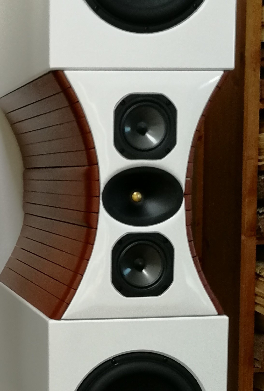

I have use both of these in MTM with Mundorf AMT and WG twee, and its really great!
Are those MTM open in the back? Must make for a quite large panel as they look deep.

No the mids is in closed box.Are those MTM open in the back? Must make for a quite large panel as they look deep.
But i think they will great also in a OB.
