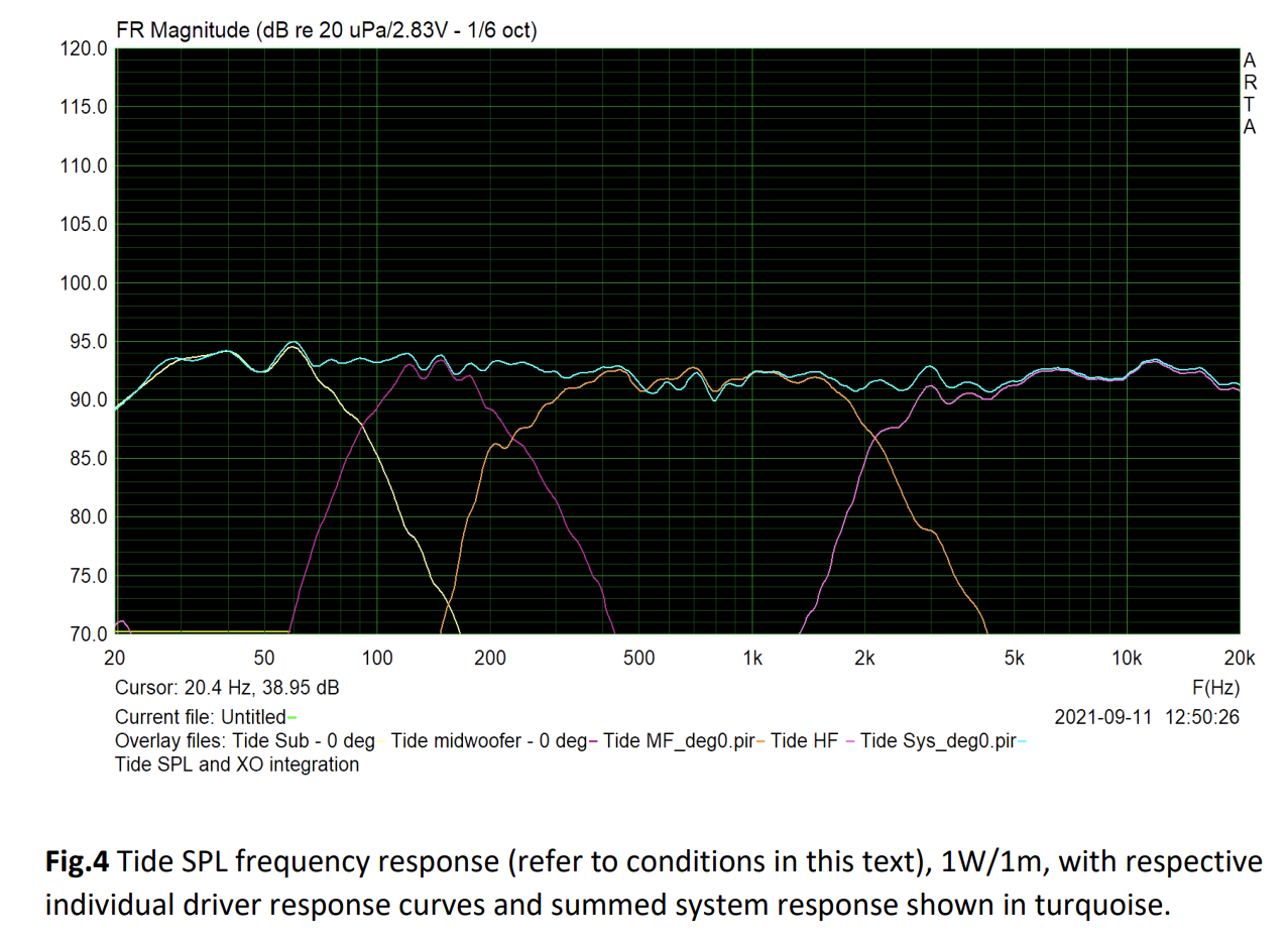

Here is Tide individual responses, from their brochure that is very informative. Still polar measurements are missing...
XOs 90/250/2200 LR4 acoustic

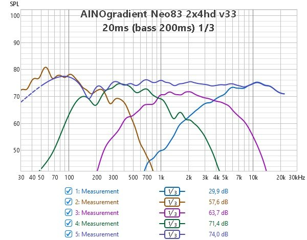

And my AINOgradients (indoor) - 10" sub, 12"cone low mid, 8" planar high mid and 3# planar tweeter
XOs 180/800/3500 LR2 acoustic
What does he know that we don't?
Well, for one, he didn't suspend the drivers on springs. :nownow: They are on a damped stiff, non-resonant, baffle with damping at the edges of the drivers, front and back. Ref: CONSONUS Tide design story and technology, https://cdn.prod.website-files.com/...f293c08e1_ConsonusTideDesignAndTechnology.pdf
Also, the cone drivers are anchored similarly to what Linkwitz proposed here: https://www.linkwitzlab.com/frontiers_2.htm

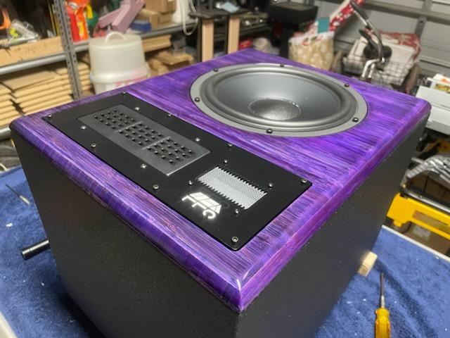

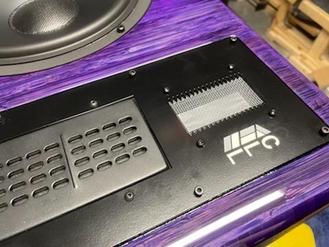

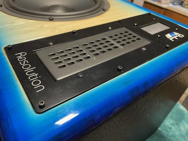

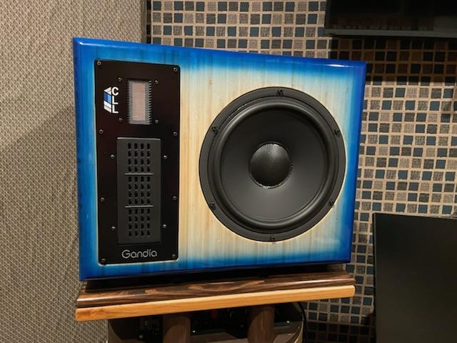

BTW, what's the RAAL tweeter you use with the plannar midranges? I saw one trapezoidal OB speaker you showed that had it, and your avatar here also looks like another speaker with plannar mid and RAAL tweeter.
The large open baffles are dual BG NEO 10 plus Raal 140-15. The studio monitors are BG NEO8-S with Raal 70-20. I cross the dual NEO 10 at 300-3k. The NEO 8-S at 350-3k. Using a custom faceplate on the monitor to hold the NEO and Raal as close as possible.

Just bits and pieces here and there. Not a full build thread. So far we've got blue pairs, black, this purple and a natural to blue fade out in studios.
Those are dead sexy! :nod: I'm very much interested in monitors like those. I want to downsize my 7.2 system to a very good three-way or WAW. I plan on getting rid of my subwoofers and going with a real woofer that goes to 35-40hz. Any info you can provide would be great. I've looked at Troels bookshelf design and it looks great for what I want to do, Your system seems to take the small three-way up a notch or two. The woofer seems to be the most challenging thing for me to find. I have a tendency to derail threads, so any links would be better than a conversation, thanks!
