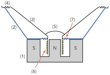

A moving coil motor with a conical driver membrane has several elastic components which resonate - spider (7), surround (4), cap (5) and cone (3). Also the frame (2). Each has has more or less mass and one or more fundamental resonances and harmonics. Total mess... Some think that the magnet or the frame is the best part for firm attach, some say it should have elastic mounting... Nearfield measurements can tell the differences in response, distortion and decay.
A planar electrostatic or magnetostatic driver has very low mass membrane that is actuated differently, much less moving parts and inertia. But they can not produce high spl at low freq.

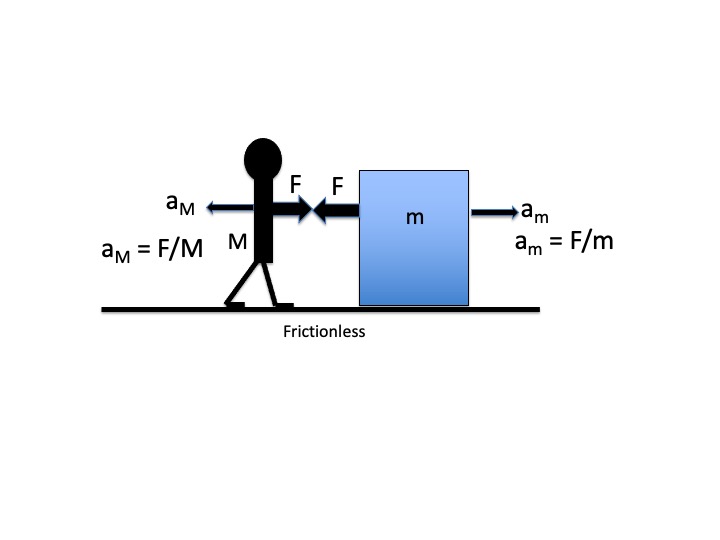

If it helps, this physics question and answer describes the same sort of problem:
https://physics.stackexchange.com/q...sh-something-standing-on-a-frictionless-floor
Because the driver is hung by wire and it not touching anything, movement is "frictionless" (you can ignore friction with the air around it).
See second answer, containing the image below, as well as other answers down that page. You can think of the stick figure with mass "M" as the cone and VC, and the blue block with mass "m" as the rest of the driver. Note that m >> M.
OK, I think I get it now. You're saying that the wire-suspended driver isn't going to act as a pendulum if it gets an AC impulse (well above the natural pendulum frequency), because the wires are floppy, essentially. I see that now. If they were stiff rods, it would be different, but the wire's not stiff..

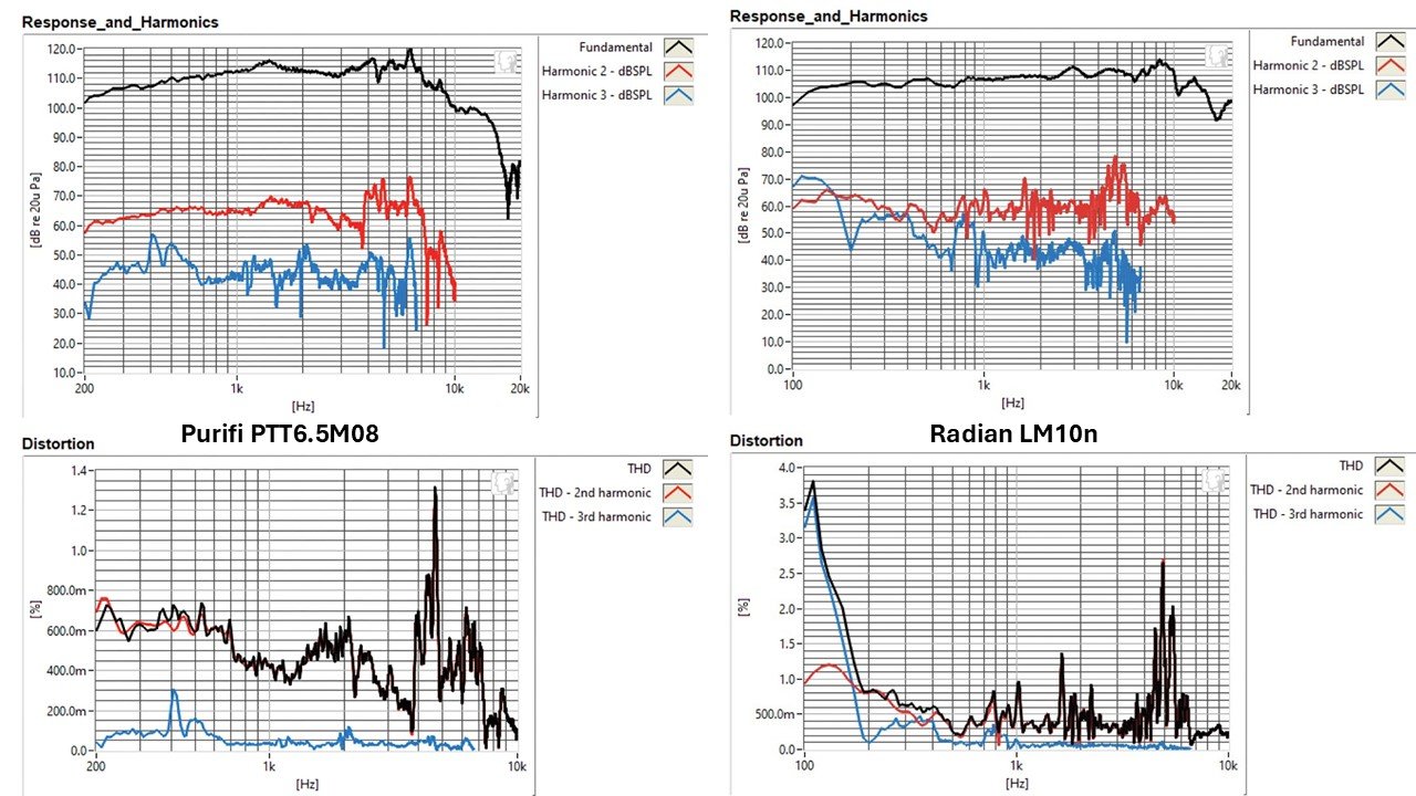

I found Vance Dickason reviewed the PTT6.5M08 and LM10n at Voice Coil, which is great because he uses the same measurement approach for both and hence easier to compare results across drivers. I wish HiFi Compass had measured LM10n!!
To measure distortion, Dickason mounts the driver rigidly in free-air, sets it to play at 94dB SPL measured at 1m with pink noise. Interestingly, the PTT required 4.2V to geth there vs LM10n requiring 2.63V. Both shown below side by side.
Would appreciate your thoughts on this. 2nd harmonic seem to be very comparable, while PTT has lower 3rd harmonics than LM, although LM still shows very low 3rd harmonic level. Note the range I'm looking at is 400/500 to 2000/3000Hz.
