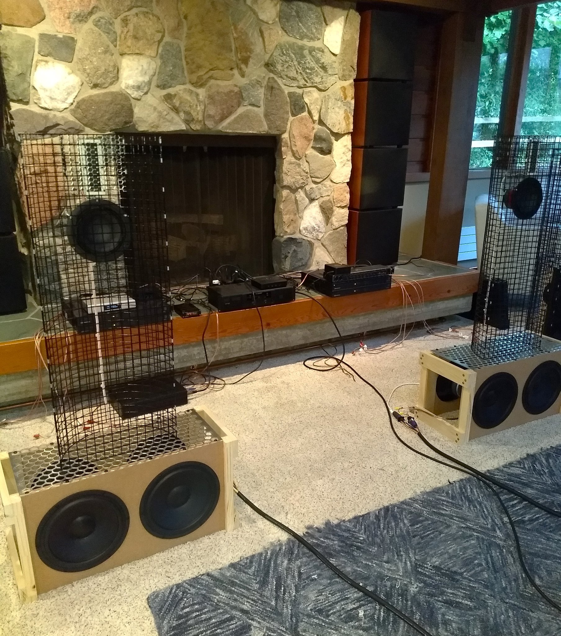

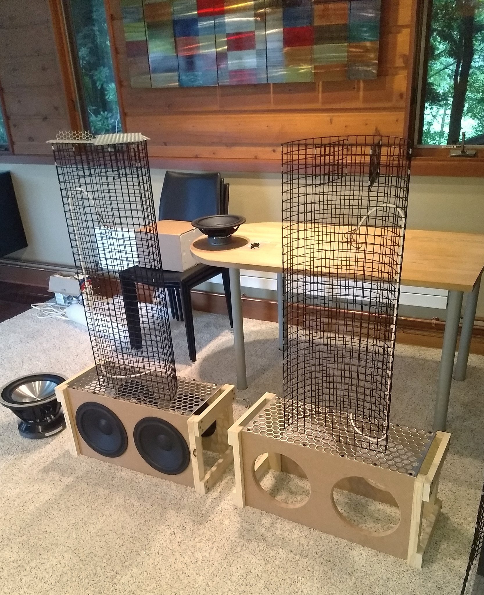

Regarding the dip... My most recent designs are 3-way dipole plus sealed subwoofer(s). The dipole part is designed to minimize the floor bounce like this:
  • The woofers are used from 60Hz or 70Hz to 350Hz. I use multiple smaller drivers, typically four 8" or 10". There are two pairs per side. Each pair is in a relatively small baffle, for example for 8" drivers the baffle might measure 12" high by 24" wide. The two pairs are placed (as viewed from the listening location) on the floor and are separated in the front-back direction by about 12-14 inches (see attached pic). By placing the drivers very close to the floor like this the floor bounce cancellation can be moved up in frequency above 350 Hz so that it is out of band. By using four drivers I get more Sd*Xmax swept area. Because the baffle area is not enough for these drivers to deliver high SPL below 40Hz, I use the sealed subwoofer for the lowest notes.
  • There is a single midrange operating from 350Hz to as high as I can take it, which is usually no more than about 2kHz. The midrange is used nude, about 30 inches or slightly more above the floor.
  • The tweeter (a dipole AMT type) is also used nude and located directly above and as close to the midrange as possible.
With this sort of "compound dipole" woofer setup, if you measure the response at 3m (e.g. outdoors) on the ground and then about 40" above ground (typical listening height) the response looks identical except at 40" the SPL is about 1.5dB lower. There is a wide dip in the response around 500Hz or so IIRC that limits the upper frequency for the woofers, and this is why I cross over somewhere around 300-350Hz.
I ignore any floor bounce effect from the midrange (I just measure its response in a quasi free field type way, far above the ground). This is because (I believe) that our hearing system is designed to recognize a source at some height above the ground and at higher frequencies and will sort of "compensate" for any floor bounce effect as part of the natural hearing process. This is different at lower frequencies like for the woofer.
This type of driver arrangement seems to integrate very well at most any distance. I like that I can "tune" the sealed subwoofer Q and Fb using a Linkwitz Transform so that the low frequency bass energy sounds correct and I still get the nice low end of a monopole. I think this is not too different from the setup that @Juhazi uses for his speakers, with some differences in how he implements the woofer section.
I will definitely build more speakers using the above concept.

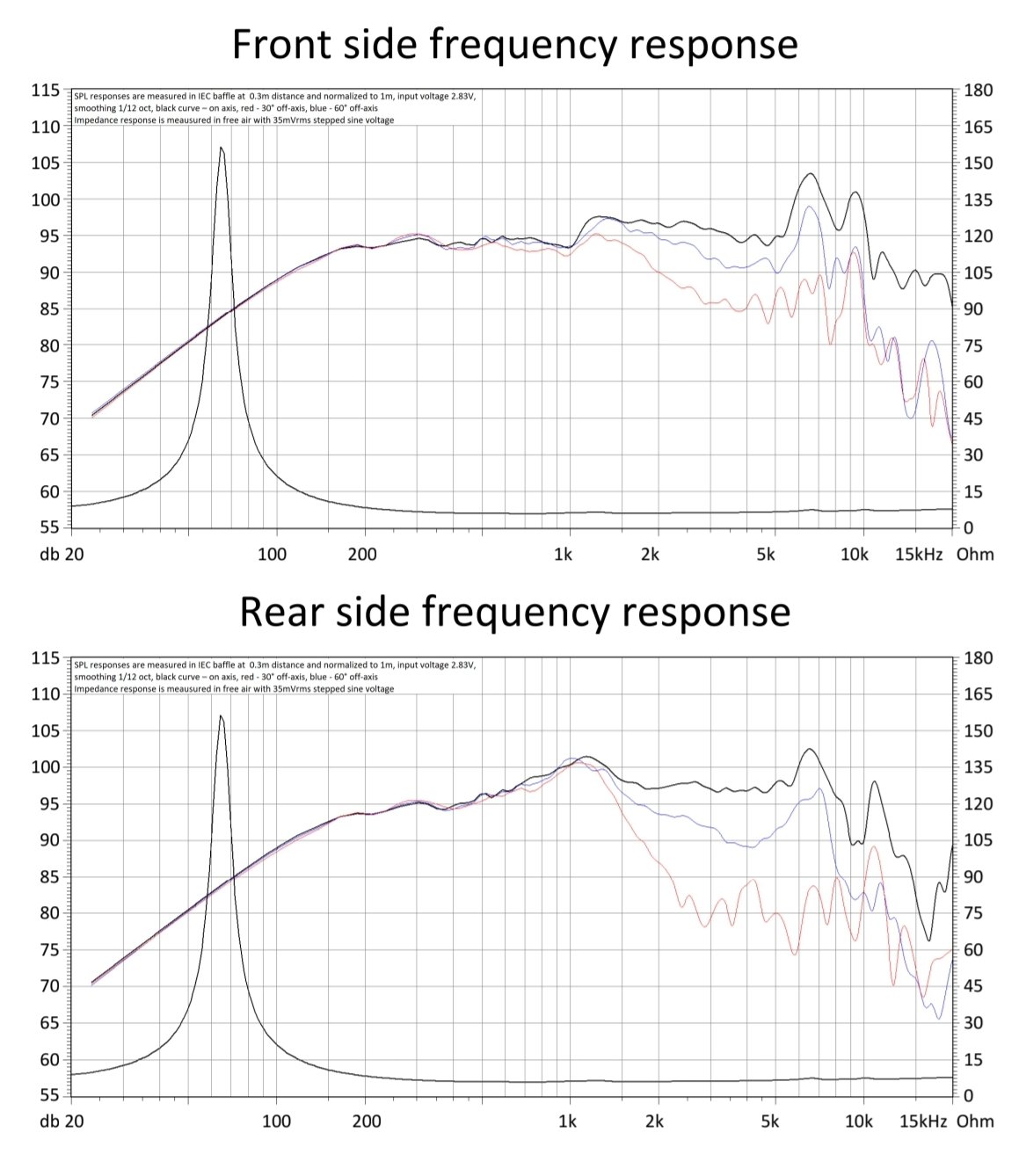

There's always the Bliesma M142A, which has a huge advantage as a OB mid due to its highly unrestricted rear chassis. The rear emitted sound is very even and balanced. Its not cheap at about $1000/pc, but IMO one of the best current OB mids avaiavailable.
Are you saying this from first hand experience?
I toyed with the M142, aluminum or texTreme. Of course it's expensive but not necessarily out of reach. I exchanged with a member here who has experience with this and other Bliesma drivers, and while he thinks very highly of them, he didn’t think the M142 would be great in OB. Paying top price and not getting top dipole performance didn't come across as fully compelling.
I also exchanged with Bliesma and they said the driver works well in OB but couldn't share more info.
Bliesma provides front and back side responses in their product literature:
We can see that off-axis the back side response drops fast post 1.3kHz or so.
