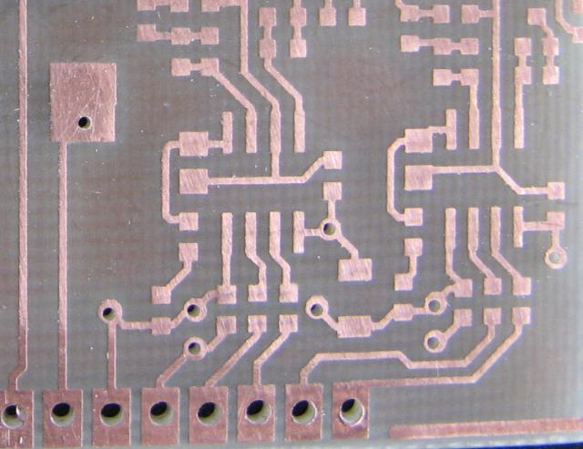

Here's a section of a double sided board I just made. The traces are 15 mil wide. I could easily have used 8. The via pads are 50mil dia. I used a Club Toyata magazine page for the toner transfer. The board was etched with copper chloride, which never needs to be disposed of.
The printer cost $40. The laminator was $30. They already paid for themselves after 2 boards.
