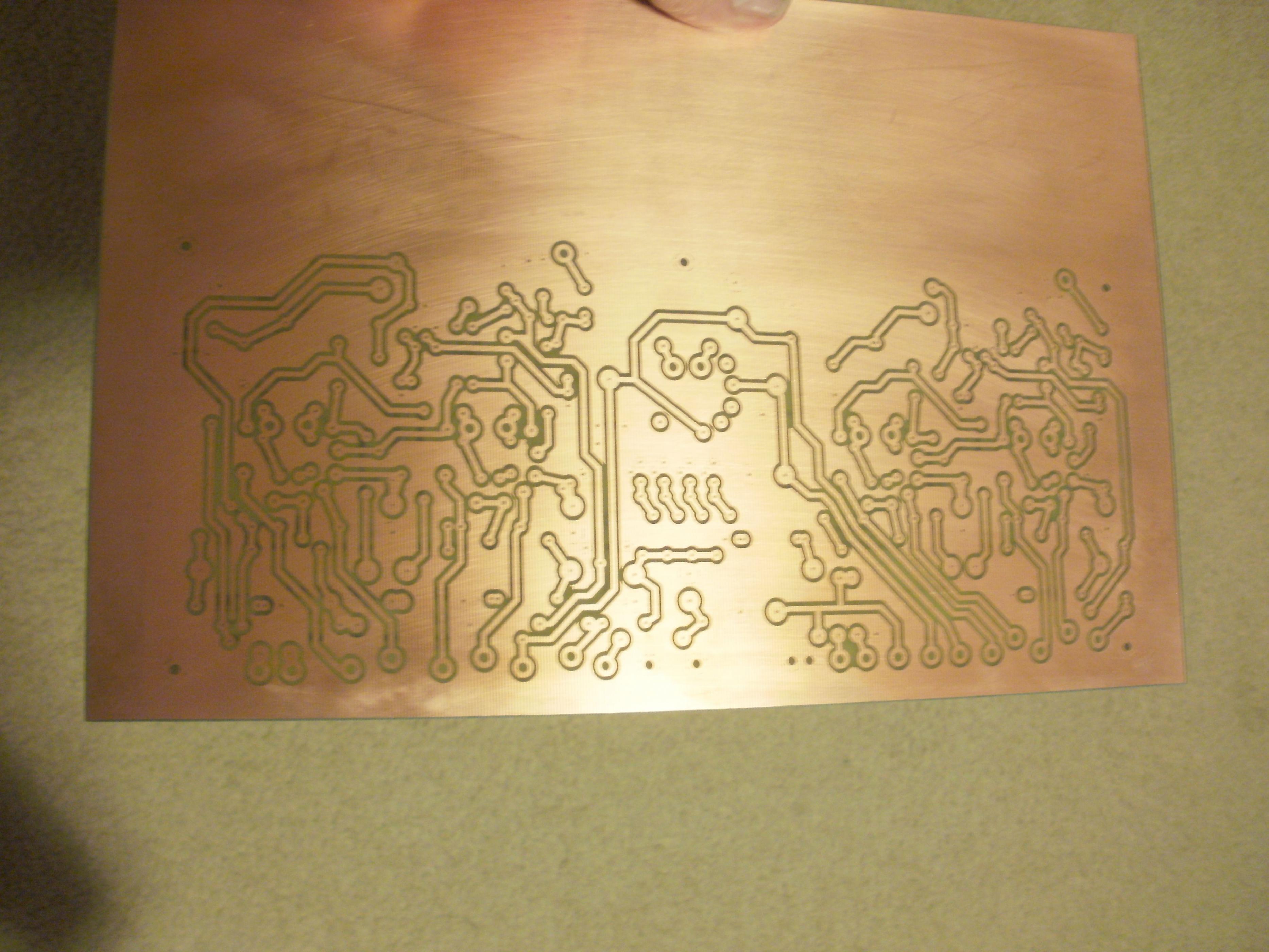

It is electro-less tin plate liquid:
421-500ML MG Chemicals Solder, Fluxes & Accessories
Just steel wool the copper to be bright, remove any steel wool residue then drop into a ziplock bag with liquid tin and agitated for 5 minutes. I've been using the same stuff for over a yr now and it still does a quick plate. about $35.......
Be advised that liquid from MG deteriorates over time, and is expensive. I just called them yesterday, and they told me that the shelve life is about a year or at most 2... I will buy some mix as need off of ebay if I can find it, it makes more sense to me.

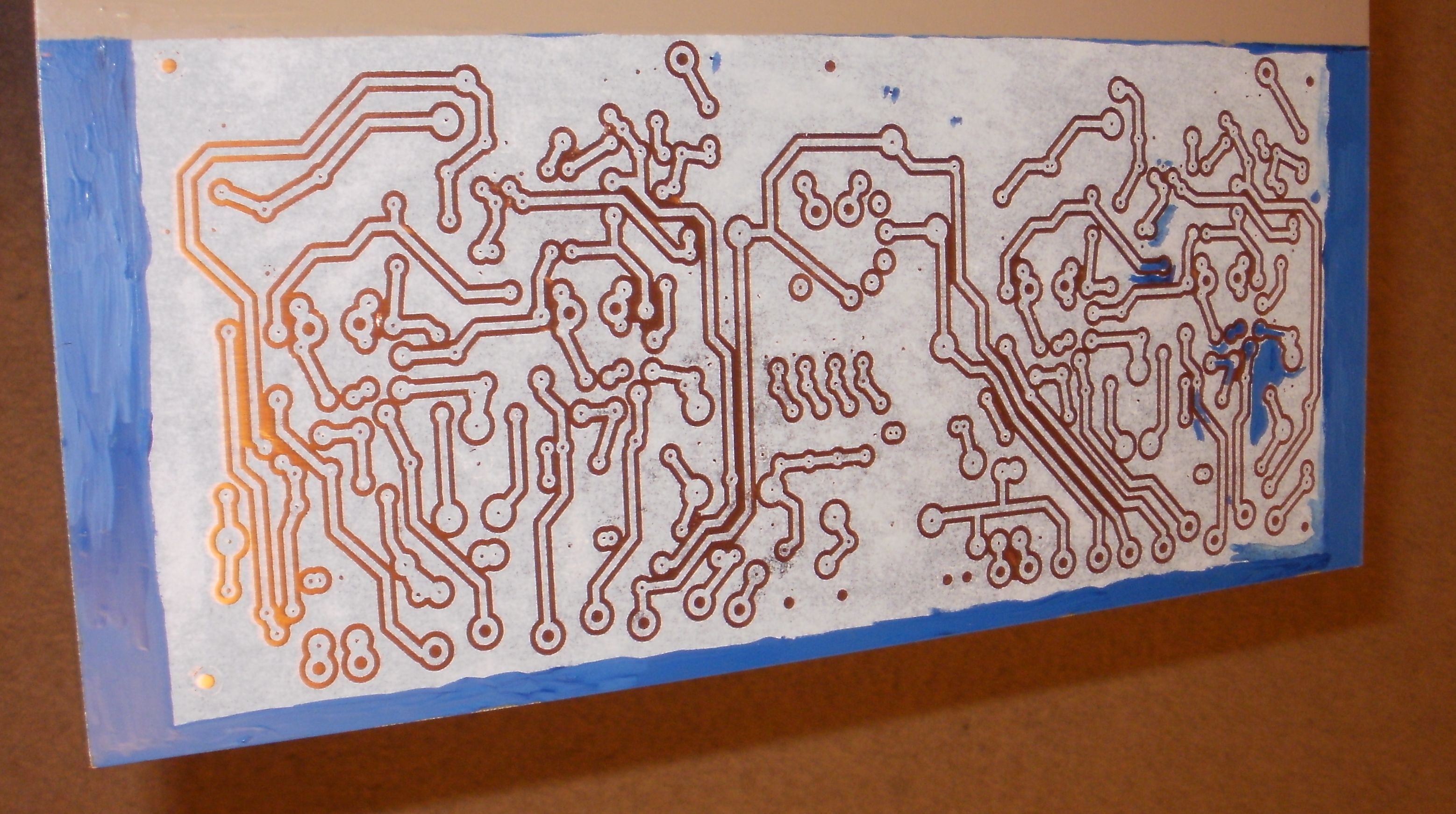

I've been using HP LASER PRESENTATION PAPER, Q2546A with good success. By using max ground plane, there is minimum etch area so it lasts longer. I always tin plate to protect the copper.

I know this is an old thread, but I thought I would tell people about the recent paper I have just used. I used to use an Epson photo paper that transferred well and when soaked in soapy water would peal off in a matter of seconds. They stopped selling this paper, and after running out of it recently, I ordered some of this:
http://www.amazon.co.uk/Epson-Premi...PMZ4/ref=sr_1_2?ie=UTF8&qid=1361477631&sr=8-2
Epson Premium Golssy Photo paper - S042167
It transferred well, and after a 30 minute soak, you can gently peal the paper away. I am very pleased with the final results of the boards after etching.

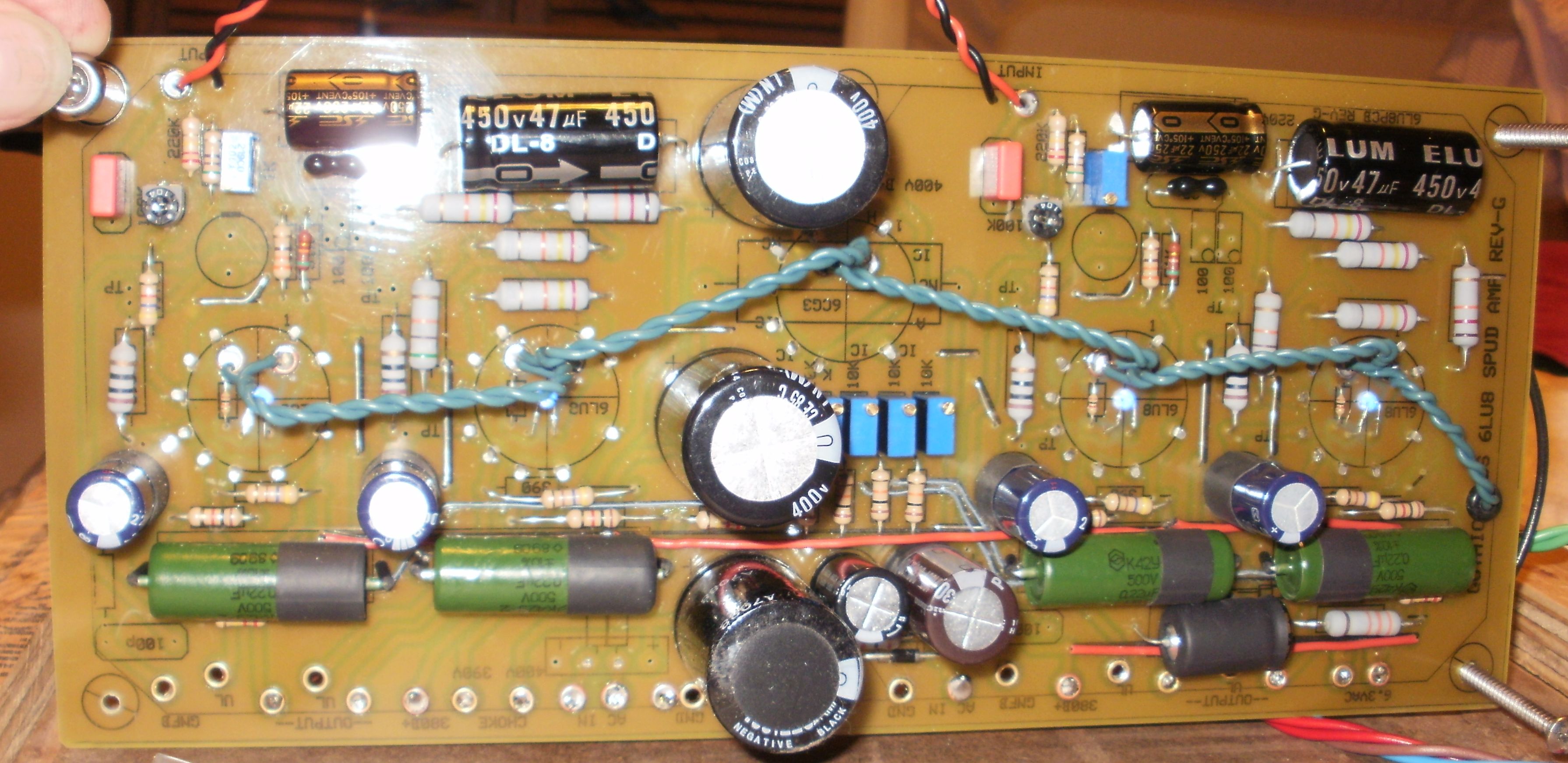

I always add the twisted heater wires running them at least 1/2" off of the PCB to minimize coupling. Where I anticipate multiple wires being installed and reinstalled I will use brass eyelets for durability.

I know this is a little late, but could you tell us more about the silver plate solution that you use?
I use tinplate myself, from chemicals bought off of ebay, and while it plates quite well if you solder the PCBs right away, they don't have a long shelf life. Typical of tinplating, the traces start getting difficult to solder after awhile.

I'm not a fan if Tinnit as it needs to be heated to 60 deg C (AFAIR) in order to work. MG Chemicals Liquid Tin works at room temperature. The tin plating created by the Liquid Tin is generally pretty good, though, lately I've been having some issues getting it to plate evenly. Perhaps because the bottle I have is near the end of its useful life.
The best product I've used is still Kontakt Chemie Lötlack SK10. It's a form of conformal coating that contains flux. It protects the PCB from oxidation and you can solder through the coating. I haven't seen it at any of the US component distributors, but it's available in (Northern) Europe.

I would also be curious about the silver plating, however, I'm quite certain that it has it's own issues. I once saw an amplifier that had been built years ago, and had been soldered with silver solder. Every joint on it was black; a real mess!
I use "Tinnit" to plate board traces, and also found some difficulty with soldering. The problem, I discovered was that I didn't leave it in the plating solution long enough, and at a high enough temperature. I now heat the solution to about 160F (higher temperatures increase the activity of the solution), and for the recommended 20-30 minutes. Originally, I saw the color change that occurs within 5 minutes, and figured that it was "good enough". It isn't. The increased plating depth significantly improves solderability.
I think I will try warming the solution and leaving it in longer. I have been using it at room temperature and taking it out five minutes or so after the color change. Incidentally, the solution I use, which I found on the homebrew PCB Yahoo Group has been kicking around on the internet for several years now, and is as follows:
