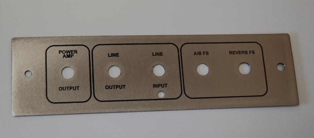

anyone done any transfers onto wood?
I have, it works well on closed grain (or filled grain) wood.
Here's it on stainless steel:

I'd be happy to do a side by side. What is the SKU or Staples item number of the HP paper? I can't see it in your link.

Are you using iron when you transfer from the paper to the metal?
