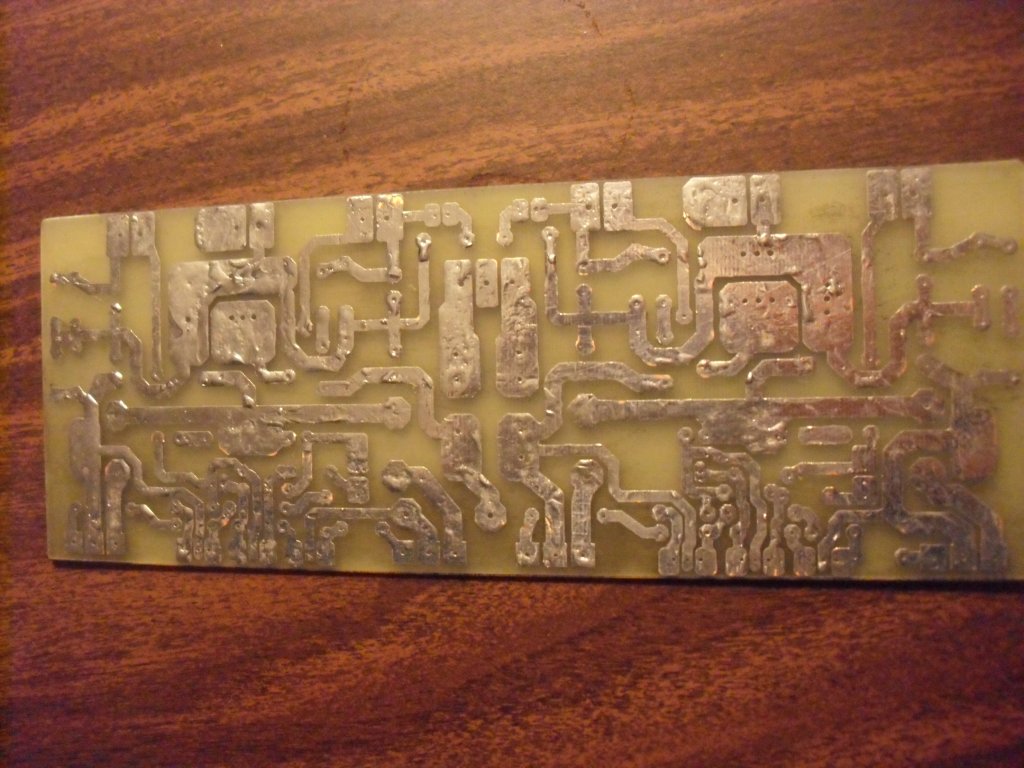

The newer Staples Photo paper sucks for Toner transfer ...... Ive been useing Kodak Professinal photo paper , this stuff is awesome , I just iron it on , then cool it and it just peels right off just like PNP , so there is no soaking the paper till it disolves ......
I got 100 sheet pack for about $50 which is still 25% the cost of PNP and works just as good ......

I see , UPC Code , well i don"t have the Package anymore , but I have even used the cheaper KodaK stuff and had no problem .... I believe the reason why it works so well is because it isn"t really paper , it is a type of Plastic or plastic coated paper , it is totally water resistant and will not absord any water .....

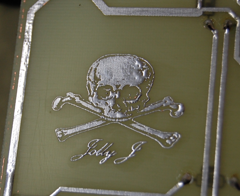

Why is everyone bothering with all this paper ?? ANY high gloss magazine page will do a perfect transfer with my HP P1005. I do whole 300mm X 300mm boards (12 amps) at a time , just a couple micro "touchups" after the transfer. The magazine paper disintegrates within seconds in warm soapy water , the pro papers I've tried can't even come close to the magazine. Any "pits" on the original paper transfer are cancelled on the second transfer to the FR-4 ... I have 0-1 pit per board.
I've even successfully etched the target lines at 1 pixel wide .. talk about resolution !!

I think a lot has to do with the printer .... Ive tried the Magazine paper before and it worked OK but it was far from foolproof and I spent a lot of time doing touchups , with my old HP lazer printer I could use any type of Paper , even plain copy paper and get a good transfer so it seems what works well in one Printer isn"t necessarily going to work well in another printer .....

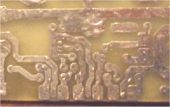

Specially if you use Muriatic acid you have to do good job , otherwise that liquid goes under the toner (protector film)!

I tried the blue plastic transfer foil (specially made for these purpose) I purchased 8 sheets even the Staples paper work far better! Unfortunately that paper no longer same quality.
I will never buy that blue transfer foil. It is useless. Some ink on the copper clad some remain in the plastic.
If you go higher heat the blue plastic just deforms.
