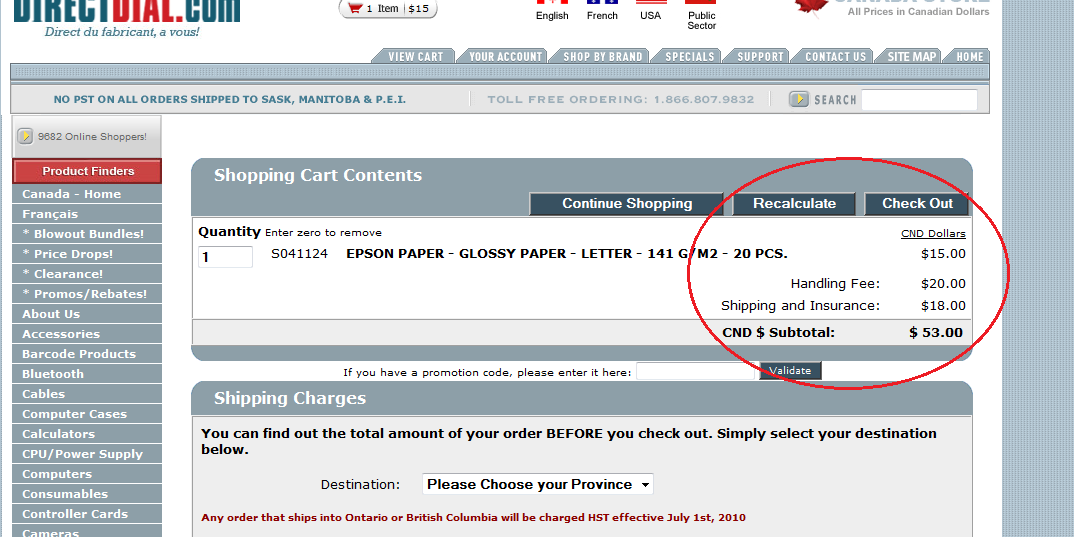

I found the HP presentation paper at one place in the US that will ship to Canada - $45 for UPS shipping. Gee, they really want to sell to us up here, right?
John, I don't have any pic of a board I've done with the Epson paper but I'm planning on building a UCD amp soon - perhap this or next week . The boards (3 or 4) will be done with this paper and I plan on documenting the process. The paper doesn't just fall off but a nice soak in warm water for ~5-7 minutes will most certainly release the paper from the board. The quality is close to the board you've posted perhaps a tad inferior. BTW: here is a Canadian supplier S041124 - Canada : Epson Paper - Glossy Paper - Letter - 141 G/m2 - 20 Pcs. - Product Details
That link:
Nice price.
I order stuff from Digikey and the shipping is $8 if the order is less than $200. If more, it's free shipping. UPS has the order at my door the next day.
Where TF is the disconnect here? Why so much disparity? Any online business that charges more than $20 for shipping or has some BS handling fee is NOT interested in selling. Period.
Nice price.
Sorry about the ** from that link MJL21193. I just did a quick search with the Epson part number and Canada as the search terms; what a rip off! I really thought they would charge $5-10 cnd for shipping.

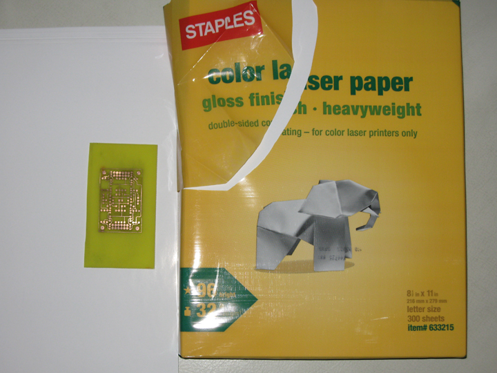

OK, after my post the other day, I tried my toughest board (the Nelson Pass based UGS board) using magazine stock - it failed, pinholes and bad traces.
I went to the web. I made my own release paper by making Dextrin glue and silicone paper. The transfer was terrible; I didn't bother to etch it.
Very frustrated, I went to Staples to buy the HP Glossy laser paper. They were out of stock, but they had a Staples brand paper that looked promising. One of the reams was open, I asked the manager for a piece to try. He offered me the open ream for half price.
I am ecstatic to report this paper is "The One". I printed the UGS pattern. I ironed using the "Linen" setting. I put the board in warm water. Five minutes later, the paper peeled away and left pretty clean traces - much better than any magazine effort has ever yielded. I etched the board (2oz copper) in HCL-H2O2 and the outcome was perfect, and I mean perfect.
This paper is the new king of the Toner Transfer method.
Its Staples item 633215.

could you post a pic of the Staples wrapper?
Andrew:
The Staples website has this picture:
Staples® Color Laser Paper, Glossy, 8 1/2" x 11", 300/Pack | Staples®
Hopefully, we will get confirmation that this is indeed the right paper.

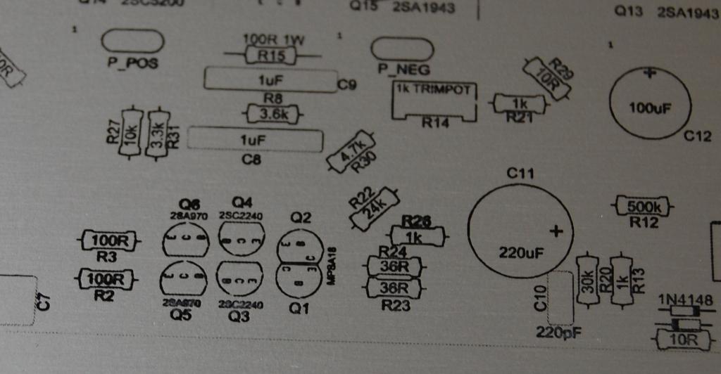

A test print:
on anodized aluminum. Not bad at all and released easily. Where it is thin, it could benefit from a sheet or 2 of regular printer paper on top while ironing, to even out the pressure and reduce the possibility of smearing.
I'm pleased and thank you a million! 🙂
