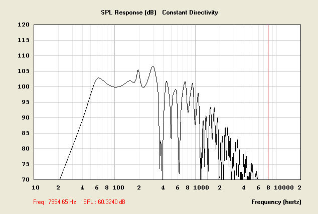

i measured the path length again in last week. and simed it. okay i like the mini cube. but my friend seems loss his feeling a little when i tell that's not Jbell. i sim with the e15-300S. and think all the thing will ok. -3db @ 50-55 hz i feel satisfy this cab.thanks martin

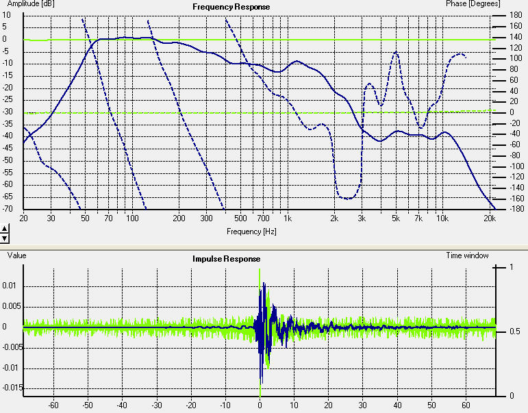

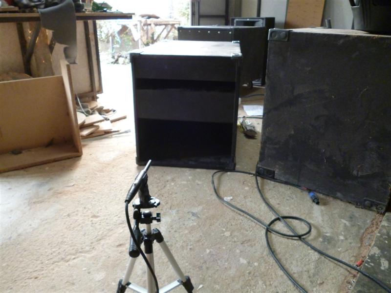

my friend just did measure last week. installed the c18-650el new series when measured it but this bin can install c18-650el old series,it works well as the same.
