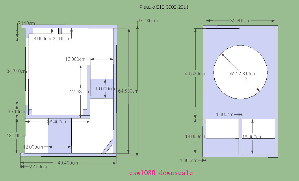

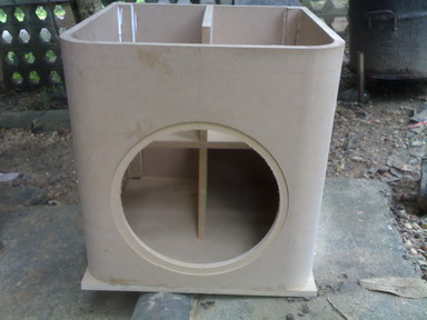

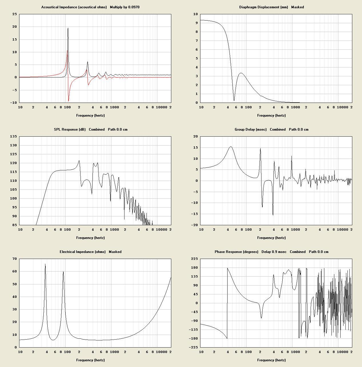

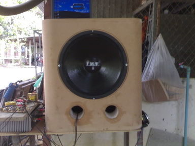

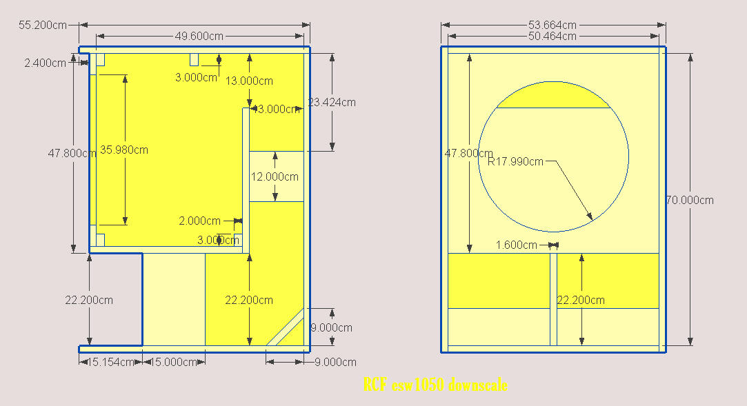

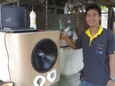

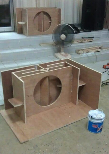

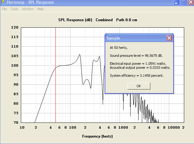

TL doesn't mean transmission line but about thailand sub last week my friend bought new imf hp-15w(2011 version) will use in home sub. i try to sim will ok 139ltr. low freq respond will boost about 50 db, ok can eq it to flat. after he did finish. listen to with song. wow! very bad. and hope that it was like this. lol he would burn it. and he went out of home about 2 hours. and after came back , he didn't believe . wow ! the bass was better than at first start very much. he felt satisfy it. cheap but not bad. hope that burn in about more than 20 hours will be good more than this.. but with i .. not happy. PeteMcK ever told me "thawach p audio imh hp-15w sale in tl about 1200 bath" . ok friend last double years i bought . don't sure the parameter. when i see the 15w in utube. i see the cone, the both cones look difference. my cone seem cover the plastic(pvc). i bought before the new version 2011 get out to sell. if i use the old spec. it will be sure? someone try to think with me. now still don't do any box with it .ahh

wow! forget the pics, yeah! a helper man to cut wood tell okay!

http://paudio-iberica.com/upfiles/productes/fitxers/A132227720.pdf
3 xmax มม. ไม่ดีสำหรับลำโพงเสียงเบสต่ำที่ดีสำหรับ 80Hz -- 200Hz. ลอง 125L กล่องปิดผนึกเพื่อป้องกันการขับรถ
in english: 3 xmax mm is not good for deep bass sound good for 80Hz - 200Hz. try sealed box 125L to protect driver.
Nice cabinet.

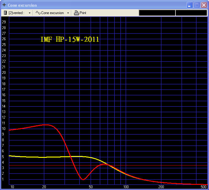

thanks revboden i think it's not bad. because i see this link they made the party box. i think it aill be no problem . i try to calculus the volume. i get 150 litres net. sometime my driver will use 150 liter as they can.
Intertechnik Lautsprecherbausatz P-Audio HP10/2 und 15/3
i try to sim the new version @80 watts cone excursion will be ok.
