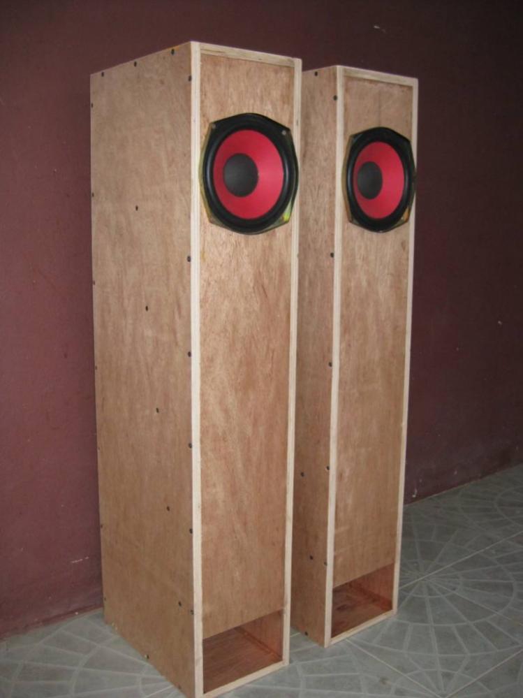

my friend gave the score from them. near to near. the cube th is 1,niranjana is 2,15 mbp46 is 3 the driver is p audio e15-300s but only 15 mbp46 installed national driver because the e15-300s only had 2 pairs
these pics of niranjana plan this designed for p audio e15-300s new series, the sound is nice and clear.

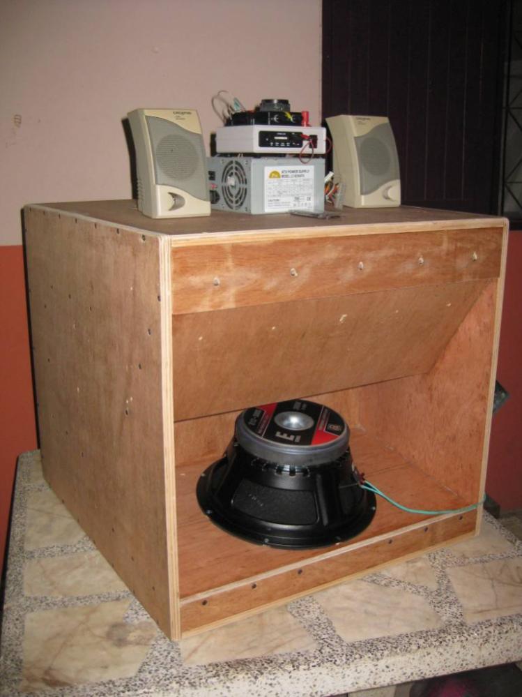

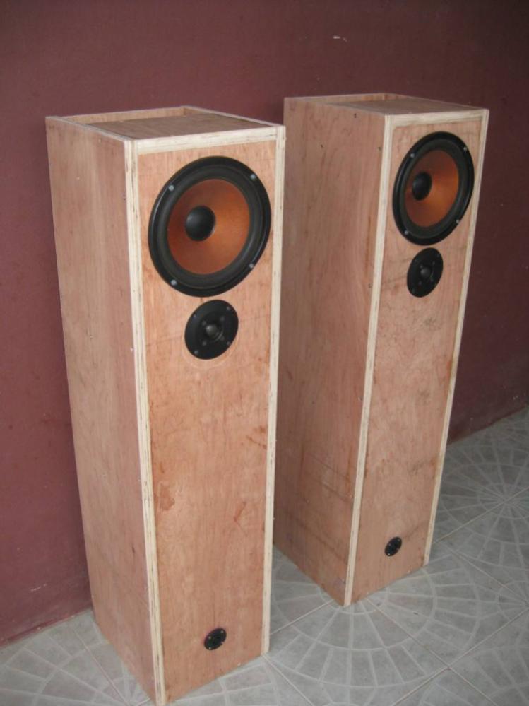

hi bart these are the 0.5 cyccclops pics . the sound will ok for home use. my friend drive it with motorcycle amp.
You're welcome!
No idea about pricing.

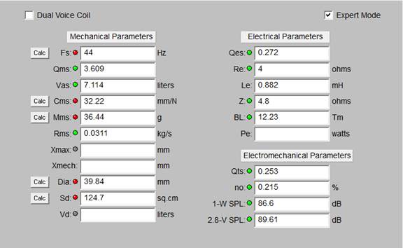

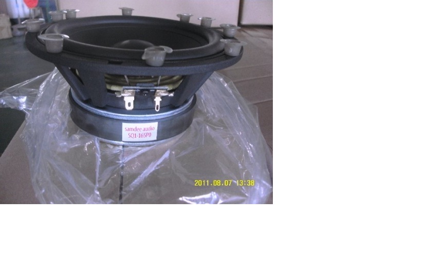

hi GM i just have known my friend brought 2 pair samdee drivers. and i get the parameter from he give. i am surprise why the vas is too low i often see the vas of 6.5" drv the vas most of them more than 15 l Gm please lets me know the vas is wrong parameter? thanks

Using Sd, Mms, Fs and HornResp's p0 = 1.205 Kg/m^3, c = 344 m/sec; I calculate ~7.9615 L.

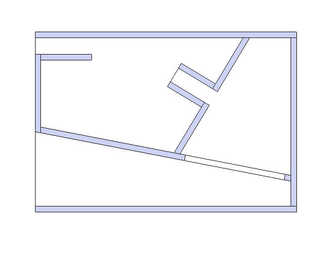

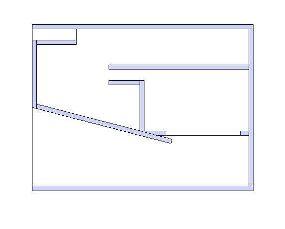

thanks GM for the respond. this parameter my friend want me design tapped horn but i try it but can't successful . because the parameter only want small volume. any suggestion for the design?

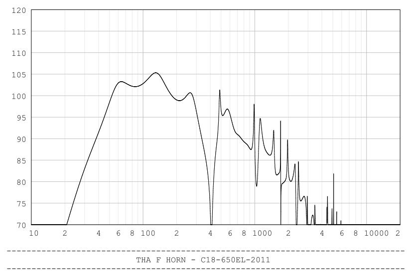

the cabs work well. but my friends want the narrow in the dimension. i try the new tha f narrow dm. but still not finish to build. i have the video from original plan. 4 cabs in a stack per side.

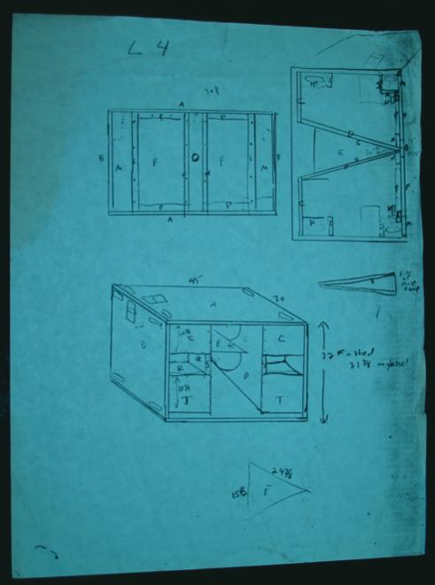

Looks like you had no shortage of labor building the THA F horns!the cabs work well. but my friends want the narrow in the dimension. i try the new tha f narrow dm. but still not finish to build. i have the video from original plan. 4 cabs in a stack per side.
Back in the mid 1980s I designed a cabinet very similar to your design, with two or four 15" per box, called the L2 and L4. Just ran the design through Hornresp to see what they actually could do with the power we had back then, it ran out of Xmax at about 245 watts per cone, which is about what the Crest 8001 amps could deliver.
The L4 tuning (about 45Hz) was lower than your box, but they kicked like crazy considering the low power and short Xmax (6.4mm) of the speakers used. We had 28 L4 cabinets, though the most we used at once was 20.
Be sure to use a HP just below your box tuning, or the speakers may develop some holes if you play anything loud and low 😉.

Use multiple drivers to increase Vas enough to calculate a decent size TH.
