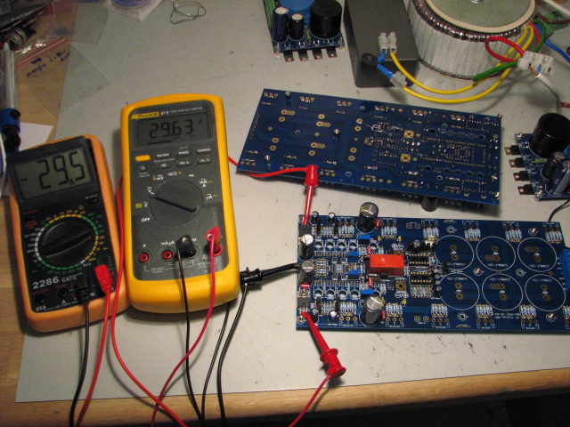

Manu, any news on the board etching🙂 I hope that you and Tony will get something in the air pretty soon. I feel kind of lonely out here in lost space😀
BTW here is a pic of a real amp in the making😉

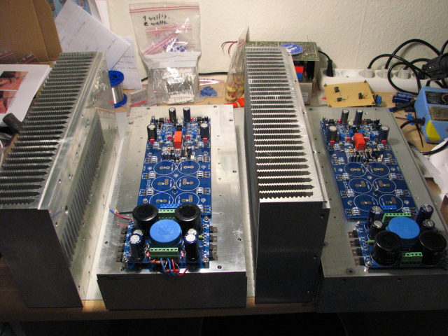

1 I think? I am doing mine as monoblocks, mainly because of the size of the PSU's that I want to use. They will weigh in at approx 38kg each channel. I simply hate it, when an amp is over 40kg like the Krell I made! Its nearly impossible to move it around!! Well, here is a pic of a sub assembly of the UP.

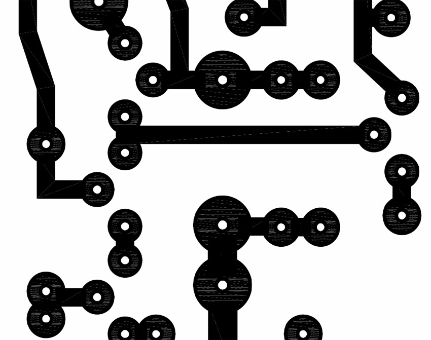

Well ... I began last week with etching but noticed that on my PDFs, there were some grey lines crossing the black traces.
So the etching were not perfect at all.
I decided to redraw/copy the pcb. It will just take few days more ...
Manu

apassgear said:
Are you guys talking about the shuntreg pdf that comes out with grey lines? :hot:
Hi Tony,
Please, there is nothing you should worry about.
But yes I get these grey lines crossing the traces. Is it due to differences between PDF software, dunno?
It should not be a problem with a good printer (as steen stated). But mine is not.
I didn't try etching yet, though.
(Mebbe I should and report what I get...)
Manu

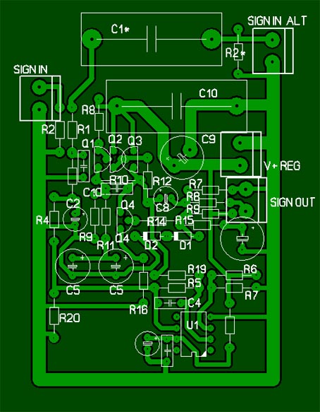

Tolu said:
Will there be a PCB group buy for the Toole shunt reg?
I need two for B3 and one for an opamp pre!
That would be nice, indeed. Unfortunately there is no Gerber files for the layout that Tony did. Tony's layout is made the hard way, drawn in a CAD program.
BTW, I think that might be where the grey lines comes from.
Who will volunteer to do the pcb files for a GB? A doublesided layout with full groundplane would be great😉

The WiP :
