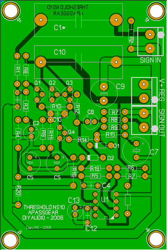

Manu, I didnt know you were into board designing. How nice.
Edit. That board looks great🙂 Did you increase the room for the opamps bypass caps? it could use a mm or two extra space.
Thanks, but its really just a start ...
The bypass caps are pretty at the same place as on Tonys board.
The only difference is that I just moved the ground trace on the left side a little more to the left ...
Manu

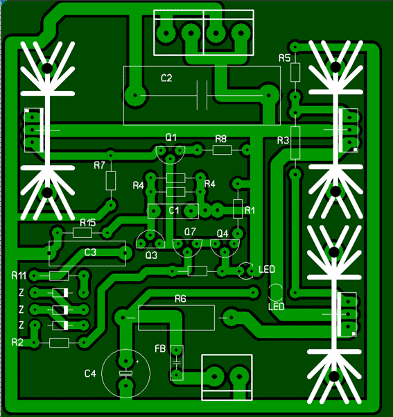

I stared with Shuntreg board copy

apassgear said:
Anyway your artwork is 😎

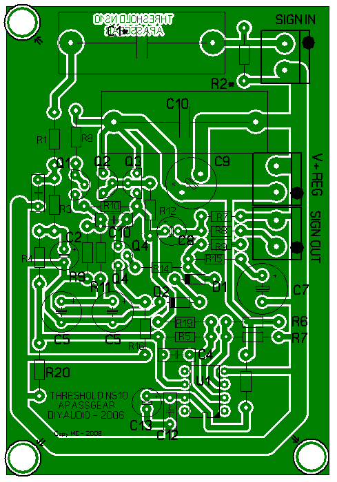

Should look familiar to you :rofl:
Manolo
Mucho rapido Manolo, very nice work, I like it and I’ll be happy to work with you on the mods for the NS10.
I’m quite into the shuntregs mods at this time wanting them to be very useable and compact and I’m sure you could be of help on some issues.
The board size at the moment is around 67x39mm and would like to keep it as close to this as possible, but I’m wondering on C1 and C3 cap size, the layout at this moment calls for a 7.5mm lead space for these but don’t know how popular this size is but know they exist; seems that 10mm spacing is more common on these sizes. On the other hand using 10mm will cause constrain on the layout.
Any input on this issue?
Muuchas Gracias,
at your service Master... its a pleasure to copy your work ... 😀
As for the Cap size ... Even if they re not that exotic, RM 7,65 caps would be a limitation in choice, so allowing for 10mm if possible is a good idea.
I don't know right now which brand/size I woud like to use ... so I think its good to have a margin...
Manu
