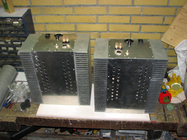

BTW These chassis, that I am working on, will become the home of Le Cheff's masterpiece😎
They are standing right on their faces😉

steenoe said:
really fast:bigeyes:
Very fast indeed ... In the time It takes me to copy Tonys little board, you just build 2 complete mono amps ...

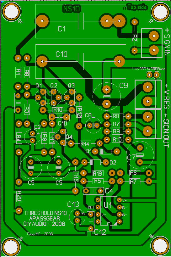

So ... The new version of the NS10 board.
I corrected some components orientation issues (my bad, not Tonys)
Still double sided, this time with just Top side ground plane and GRD traces also on the top (is it a good idea?).
BTW : Do you want the GRD plane being connected to the SIG GRD trace at some point ? Where?
(As an example I put a Jumper with thermal pad near DC input connector for this purpose.)
That’s a very good question, more than most think.
Even thou on my layout is connected I would usually not do it, that’s because we were supposly following Nelson’s design of those past days but really don’t know if he did it this way…. So…
Today I keep input signal ground separated from the general ground of the circuit and join them at the star Grd. together, in this case, with R2.
But that’s my flavor
Manu , my humble xperience ;
lookie lookie on Shunty pcb - you have two possible bridges for connecting gnd plane and power gnd ;
preferred one is at power input side ........
but - NB that bridge is for power gnd and gnd plane connection , not audio gnd in any case ....
