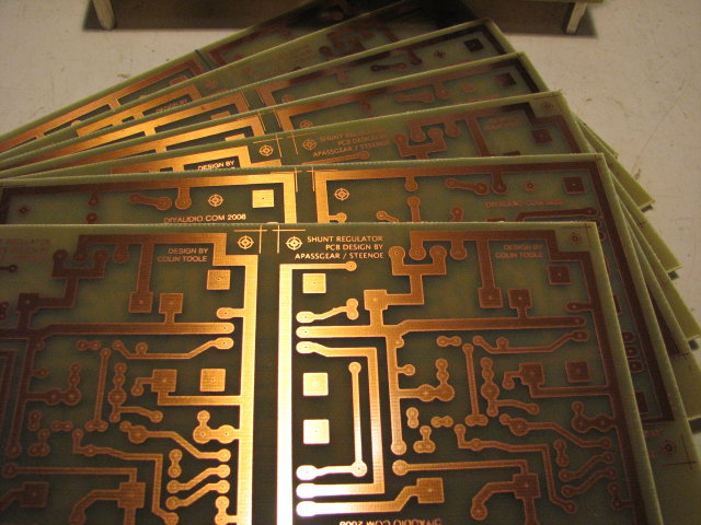

This is what the boards look like 😉
Apassgear did a tremendous job on those boards. The etch file is very DIY userfriendly!

Steen,
Those PCB's really look great. The process your following has an excellent resolution I can even read the lettering thru the pic you posted.
I might even be doing a compact size artwork for the Toole reg for you to test, I remember those you did for the NS10 which had thinner traces and they came out fantastic too.
Thanks. It is the usual photoresist method. It is much better than tonertransfer and all that. Photoresist is far more consistent in giving good results.

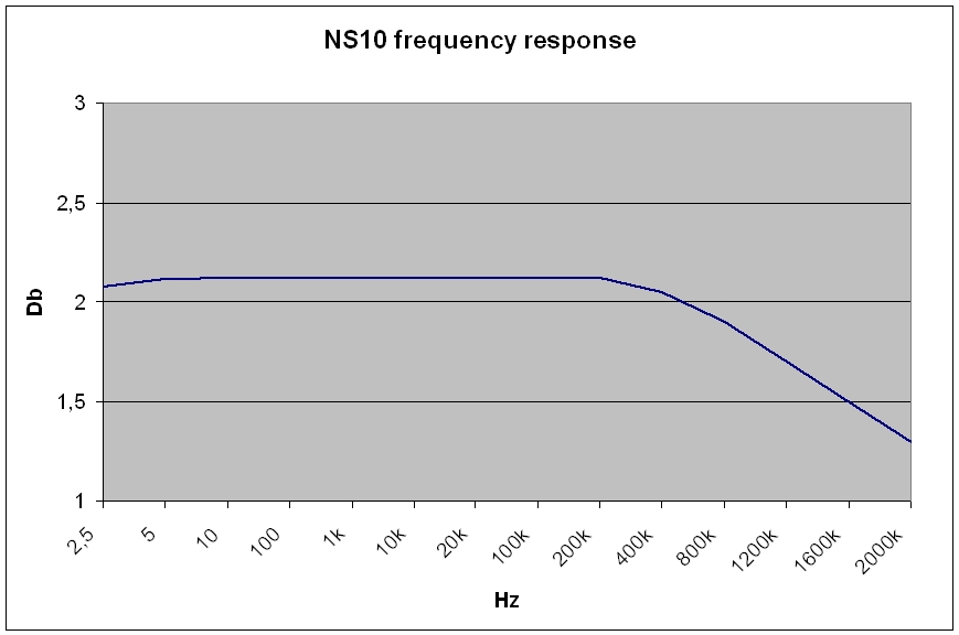

Measuring the NS10-clone with a 5pF compensation cap, was pretty interesting, but not surprising.
The Frequency response is now absolutely flat to over 200kHz, dropping from there, caused by the the cap. Comparing to the plot without a compensation cap, shows that the very slight bump at 20kHz-100kHz is gone, and substituted by a general descent from 200kHz.
Well, I cant say that I can hear any difference between the two, so take your pick😉
Here is the plot with the 5pF in place, using the same Y-scale as the last dB plot.

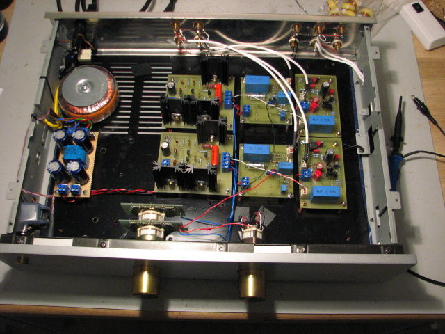

Anyway, here is a shot of the singleended preamp so far. I am still trying to figure out how to do the switching between the B1 and the NS10 with minimal lead length's. Maybe i will just stick with internal switching as it has now. As you can see, I have made 2 sets of output's. The flying input leads are for the purpose of changing between buffer/gainstage...
It is all just temporary, but if you have a really clever idea for switching between the two..... I am all ears... Ofcourse I have thought of moving the input selector/volumepot to the rear.

Steen,
That’s an impressive build and excellent work that we all seem to expect from you but few can match for sure. That plot looks also fantastic the BW is still impressive even with the compensation cap showing a -1dB at 2MHz!
We are now needing a shootout between the clever guy’s XP and Steen’s NS10 + B1 buffer preamp 😀
