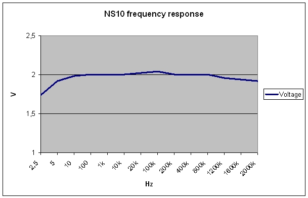

The NS10 seems to be a never ending story. We (Apassgear and I) have been working on a new supply for the NS10 for a while now. The supply is a shunt regulator (ofcourse) and the original circuit is here: Toole-regulator
Thanks a lot to Colin Toole for posting it in the first place. He deserves all credits for it.
The NS10 works very well with the new supply, and the frequency response seems to be flat, right into several MHz. Attached, you will find a graph of the response, derived from a series of measurements that we did. The "bump" you see at around 100kHz is only 4/100 of a volt. We didn't pursue to get rid of it yet, since it is such a small deviation. The response is only down at 1,92V reaching 2 MHz. The reference value being 2V. My function generator doesnt go any further, unfortunately.
The Toolereg maybe doesnt have the lowest OP impedance, but it counters by being flat up to very high freqencies. You can study the plots in the original thread.
An absolutely worthwhile addition to the NS10. I wont go rambling about how good it sounds with a shuntreg again.....

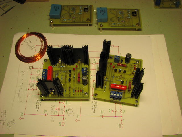

Here is a picture of the boards that Apassgear made the layout for. Very nice work.
Thanks a lot Tony, for agreeing to cooperate on this little project
The regulators are fed by a simple CLC raw supply. We have wound some small inductors, to knock down high freqency noise. The inductors are approx 22uH.
