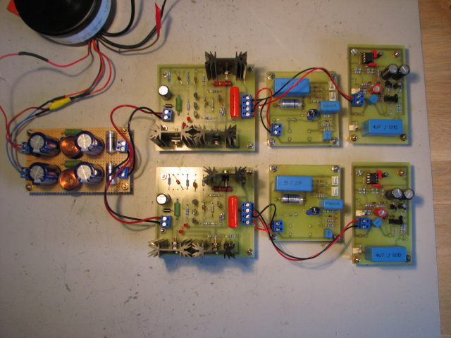

One more picture. This is the whole family.
The small board in the middle is the B1 buffer. We deleted the CRC supply, to make it run from the Toole reg. It sounds superb, running from the new supply. The plan is to build both the B1 and the NS10 into the same case and make it switchable between gainstage and buffer for flexibility in use.

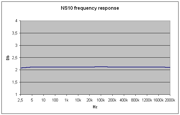

BTW, mind you, that the plot I posted of the response is not trying to hide anything, as the average responses you see on commercial gear. This is the raw deal, and how every response curve should be made😉 In fact, the plot is exagerating somewhat.

Anyway, my slightly overkill version of Shiny (squeezed in 2x10.000uF instead of 2x2200uF) per Shiny per channel, is what I was looking for to be able to give some proper kick into F5's lazy butt. Now my ESLs are finaly able to show what they are capable of, and I'm afraid that many will hate this sort of combination. I already know one guy who came and brought his own two Miles CDs, had a few tracks by request and commented : "What a shittey recordings I have, I never knew this before"

Steen has been very modest explaining all the effort he did building this outstanding set of lineamps which included setup and testing of the Toole suntreg, congrats for this Steen.
We have to thanks also Colin Toole for his support and tips on setting this regulator starting from his topology shown else where on the solid state forum.
Actually the response of the NS10 would have looked like a ruler flat line if he had plot it on a dB scale besides he did have a 5pf low pass cap at the input which starts to show at around 1MHz. A 10pf there might get rid of the very shallow bump at 100KHz. All in all an excellent NS10 Clone with a huge band width which will put to shame many commercial offerings.
On the other hand the shunt reg it’s a dandy, easy to build, low in cost, no tendency for instability, all discrete, no feedback and ruler flat impedance up to the MHz region. Besides, as far as we know this reg can be easily adjusted from 15 up to 30V maybe more, so a good project to test for anyone. Ohhh, forgot to mention the reg can be setup for positive or negative supply using the same PCB.

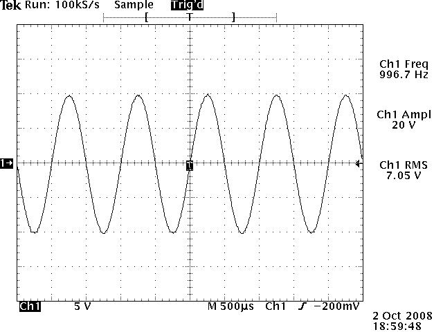

As you say it is revealing, and to my ears still very good sounding. The wide flat bandwith, does result in a very detailed sounding preamp. Did you make any measurements? The version we build, starts clipping at approx 1,3V input but is at that point doing just under 8V RMS out and over 20V PP. It's a strong little fellow. Attached is a sinewave at 1,2V input.

I will try and install some 10pF caps at the input, and see what that brings. Allthough I would say that the bandwidth is huge and flat as a dancefloor, from 7Hz to 2 MHz. The Y-axis tells the truth, one can bring out a ruler and take a few readings😉 Setting the Y-axis intervals as I did, makes it easier to see the deviations but it will also confuse someone.
I am also using a Toolereg right now with a D1 I/V , running at +/-30V, with very good result. The reg is totally free from any sort of noise/hum, even at this level of signal processing.
Anyone with a B1 buffer should really try it with this regulator. It is simply a superb combination and nearly electrostatic in transparency.

I never bothered with measurements. ... Choky told me that NS10+Shiny is what I want to use with the F5. Ok, then, I'll build it.
And I did, and he was right and it is what I had to use between my CD and F5 to get enough gain for older recordings.
I can tolerate a certain amount of distortion, as long as it doesn't collide with music (tubeamps often do that) and 0,1 or 0,00001 does not make a difference, I pick the better by listening to it.
This time I was lucky to build it and not regret it
That's a nice plot Steen and shows how good this preamp is, BW shoots through the roof.

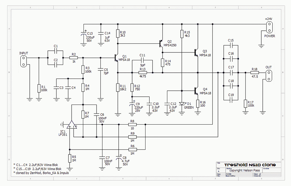

BTW, here is the last schematic we have on a pdf file which is more handy. As far as I know Steen didn't use any of the optional components shown on his circuit so it's a very close to original NS10 clone.
As we are here, here's how my NS10 clone was built, with note on N trannies I used BC550C and for P BC560C. IC is TL071... The supply is a bit higher at 27VDC but only because I was too lazy to fiddle with the number and colors of LEDs to get it down to exactly 24Volts.

Did you actually use the FB cap marked as C11?
Yup, except mine is (well, "are") measured to exactly 5.1pF to have a matched pair, spent ten minutes picking them in the shop. Why do you ask?

Just asked because Steen seems to have detected some sort of problem when using C11, he might chip in later and see what those were.
apassgear said:Just asked because Steen seems to have detected some sort of problem when using C11, he might chip in later and see what those were.
I had a small, now sorted issue in the first initial test. The pot was not grounded and the signal mass was directly grounded to the mains ground. During signal volume adjustments, the sound would disappear (go mute) and some sort of very high frequency (oscillation) would appear instead. As soon as I replaced the plain wiring with coax and grounded the signal mass through a thermistor, no further odd behavior. At least not in form of heating or audible/visible things...
Implementing C11, introduced some hissing noise, but since the wiring in the test-setup was all messy ( and unshielded) I didnt investigate the matter. The volume pot was also a bit touchy. The NS10 clone is being build into its case right now with prober wiring and grounding scheme. I will investigate things when everything is build as it should be. It is probably better to trim the final details under real life conditions, and not with a messy pile of boards and wires lying on a piece of chipboard. It would be great to see that little bump at 100kHz trimmed down to level with the average signal strength. If we can do that, the preamp can be used for calibrating measuring instruments je-je-je 😉
