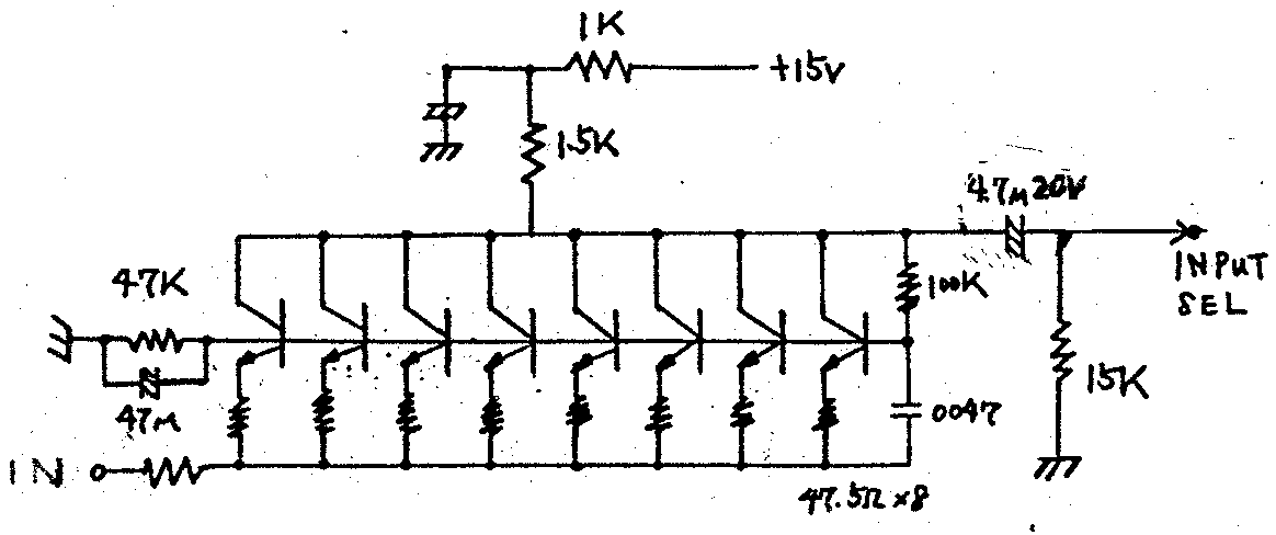

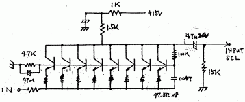

Trannies are MPS6571.
The schematic looked pretty much like this.
