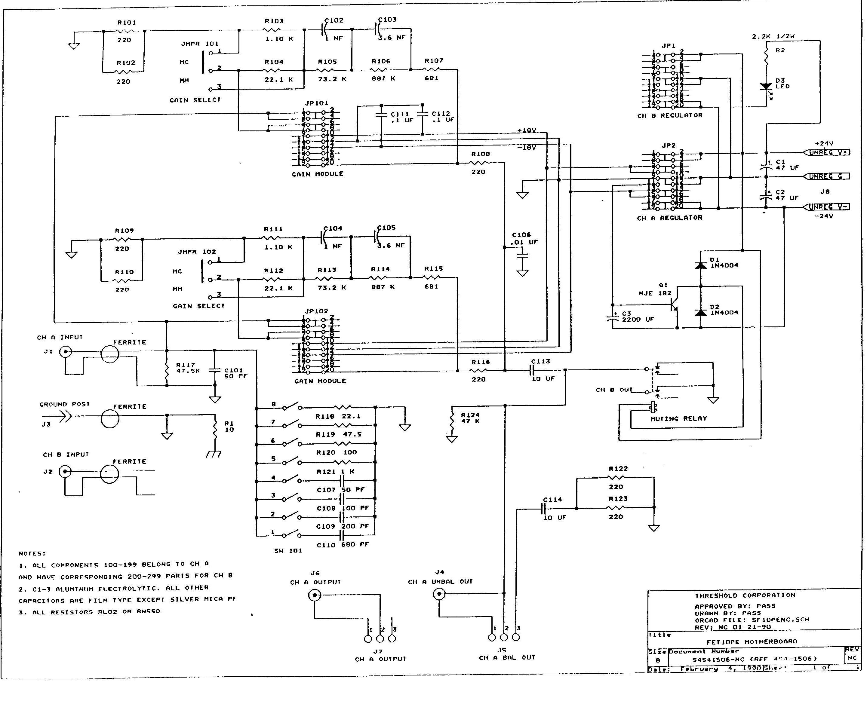

If you look at the 1st post in this thread from someone you know (hint - it's you), you'll see a list of Threshold equipment released over the years. Under the heading "Stereo Line + RIAA Preamplifier", you list the following items:
FET-10Pc Stereo Phone Gain Stage (1986-89)
FET-10Pe Stereo Phone Gain Stage (1990-98)
These are both stand alone phono stages that matched with the FET 10hl and the FET 10he respectively. The schematic shown a few posts earlier is for the FET-10Pe.

Ok, I got it and the gainmodule is the same as the lin stage I blieve or...?
Thank/Staffan
Yes - the gain module is almost the same as the line stage. If you look at the schematic for the gain module, you will see that there are a few capacitors changed when the gain module is used for the phono stage. They share a common design for the PCB and the phono stage version just adds the extra parts. The parts are labeled on the schematic with an asterisk.

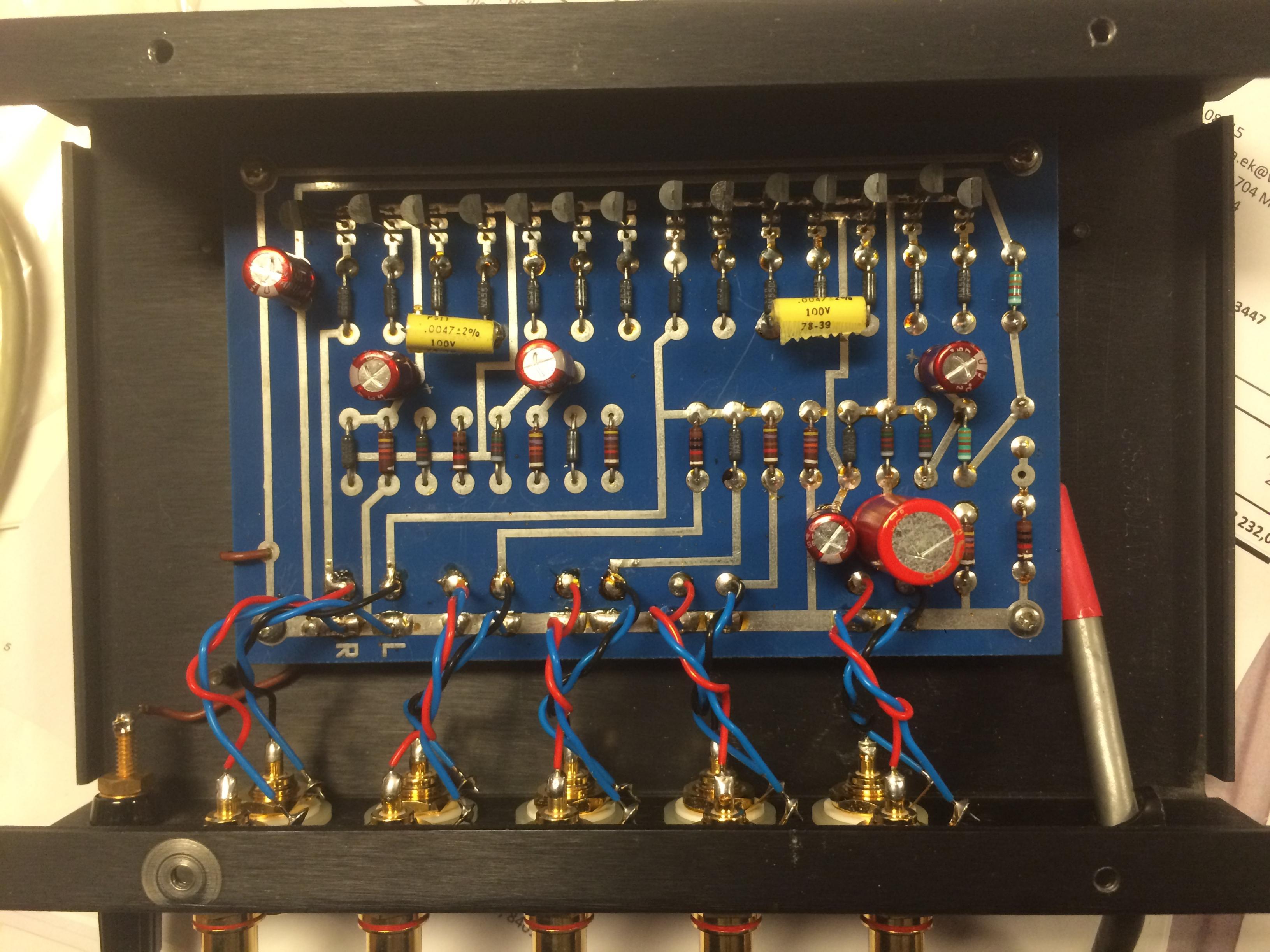

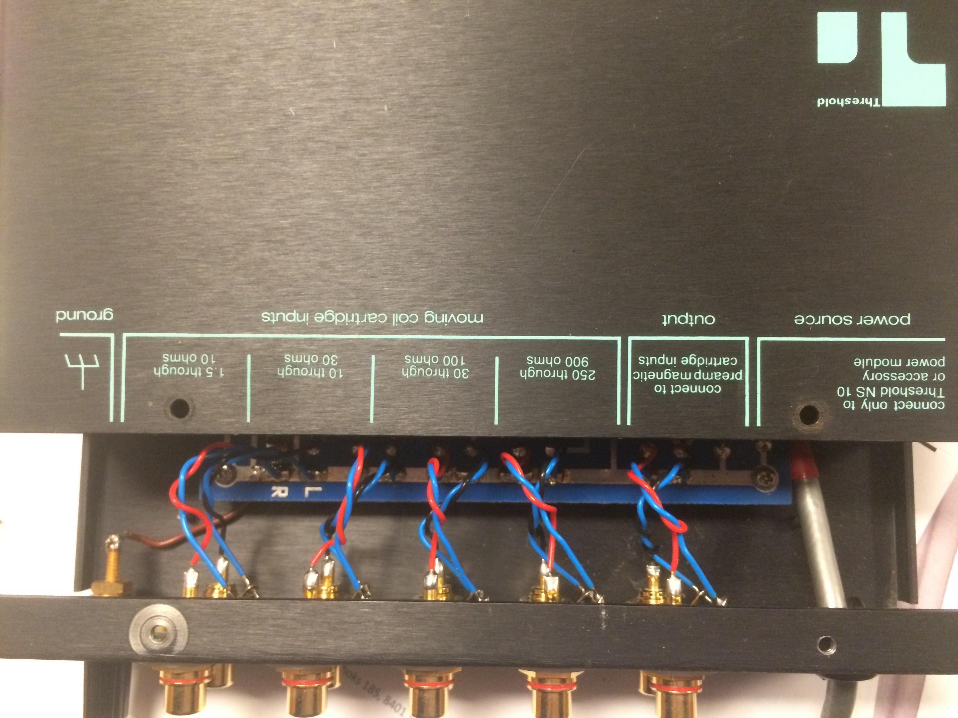

Threshold active impedance matching module, Model "M1"
This seems to be a MC head amp similar to Hiraga's Prepre and to Mark Levinson's JC-1DC - go to

Unfortunately this model is only for use with this preamplifier:
http://www.audiocostruzioni.com/r_s/pre/thteshold-ns10/ns-10.htm
Both devices I haven't mentioned here.

There was a separate PSU for the M1 as well, named the M7. The NS10, I believe, runs from one +24V rail. I think +24V is just fed over to the M1 via the XLR. Find a good PSU and an XLR and you are up and running.
More info might reside here.
