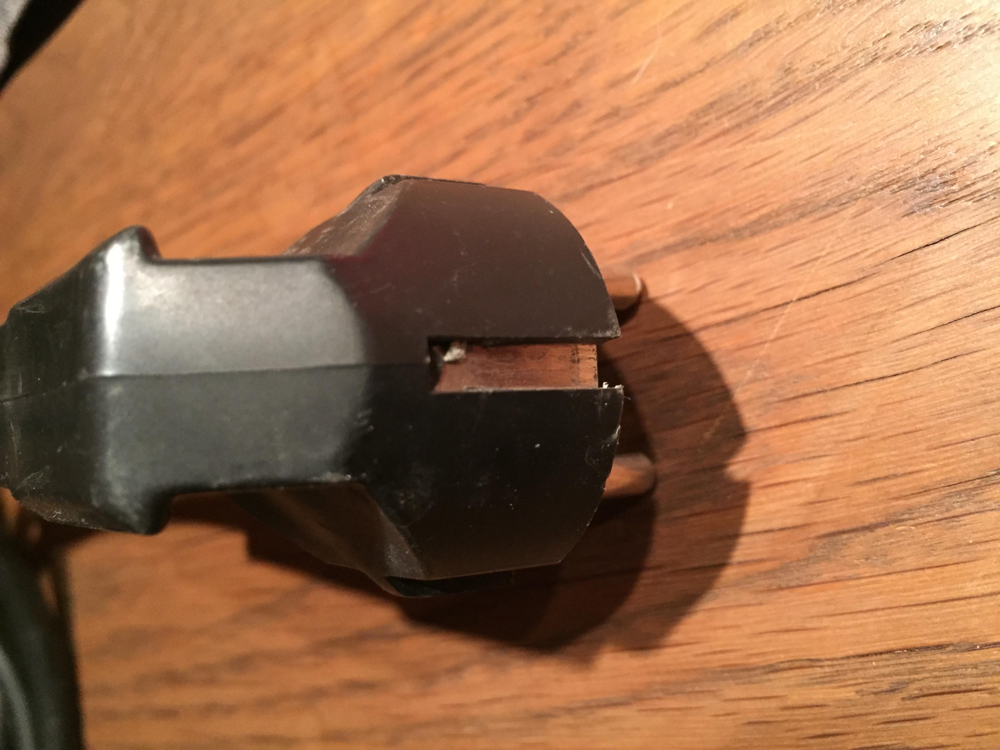

change something in signal wiring , or change something in mains cables - find a way to break safety earth for , say, monos
use either cables without safety earth wire , or T adapters without the same
be aware that you can use that trick only when everything is connecetd , so amps without safety gnd connected through mains cables are effectively having safety gnd through signal cables
pretty much normal thing in PA gear , most amps having switch on back side for several arrangements of safety gnd

When you start multi-amping, noise generated by ground loops starts to
rear its ugly head. Most often the loop is in the AC Earth connection, so
that is a good place to start. I usually isolate the AC Earth on various
pieces to see how it affects the noise and proceed on that information.
Hallo Mr. Pass,
thanks for your response. I‘m not sure about the wording, is this platelelet (metallstrip can be seen in the front of the picture, the ac earth (or ground)?
Hope the upload works

Thank you, I try first with some isolating material between plug and socket earth wire of the amps. I'll keep you informed
any news?

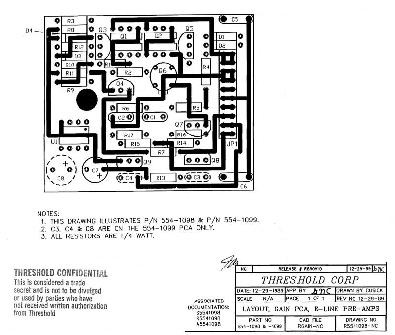

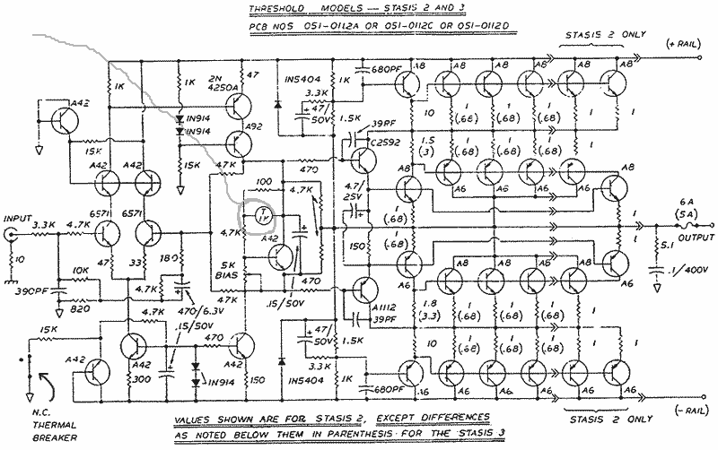

Here is what I have, don't know if this helps or not. I don't know if the FEB is the same for preamps and amps. I have a FET 10 Pe, and I have collected schematics over the years of ownership, including the original owners manual which shows the DIP switch settings for the "e" model.
