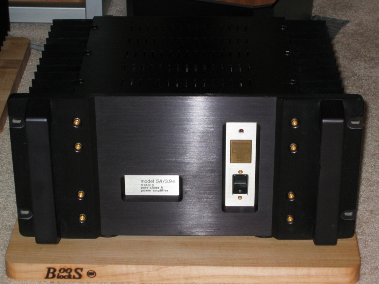

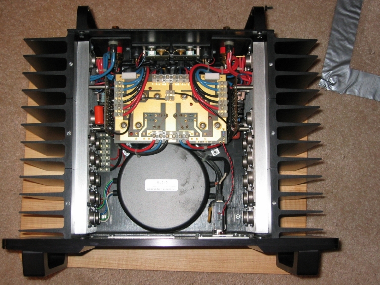

And photos of the very nice SA3.9e - same footprint, etc., as SA6e but stereo and less wattage; but sometimes, less is more...
And BTW, the binding posts (and supply caps) on the SA6e and 3.9e were updated by Jon Soderberg @ Vintage Amp Repair.

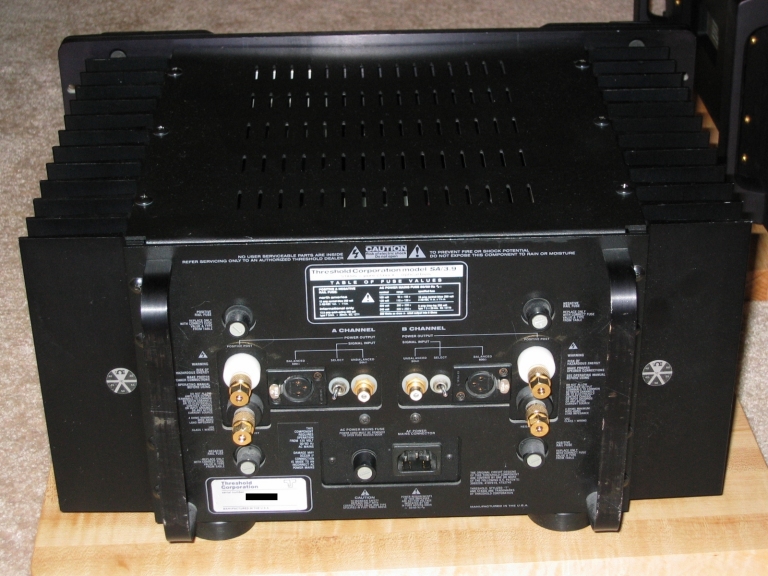

One question I did have all these years is - the service manual indicates that the balanced XLR input is wired with pin-3 hot. However, my amps are pin-2 hot.
Anyone know when this changed? Are there some amps with pin-3 hot?

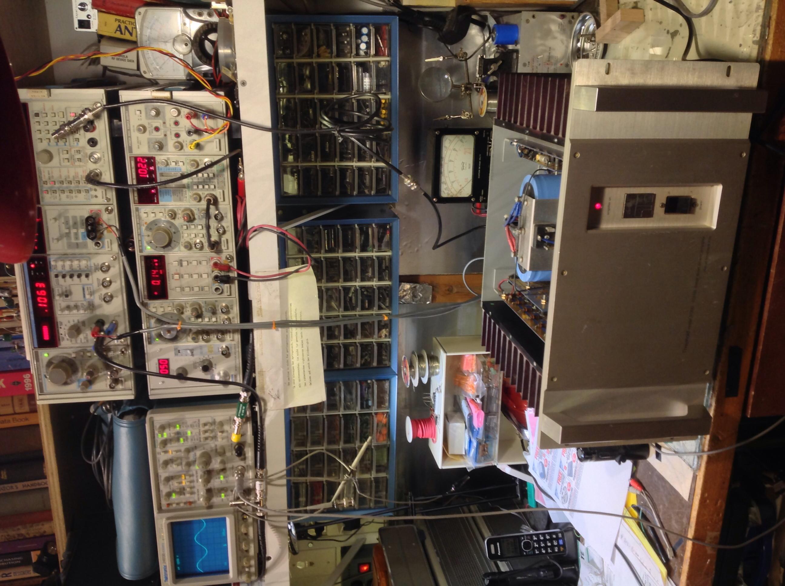

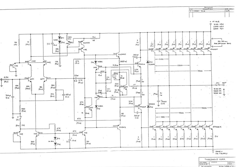

I have the unit on the bench now. It is a S300 Series II. I count fourteen output devices per channel. The schematic above lists three models based on the number of devices, none of which are fourteen. The rails measure 57 volts each.
My observation: it thumps when powered on. Not surprising, since there is no relay to delay speaker connection. The customer complains of thumps/pops when powering on or off. Also hum. The pop or thump on turn on has been observed here. But no hum. Output has less than 1mV of noise and is inaudible on speakers of 98dB efficiency that I listened with.
[image]http://www.diyaudio.com/forums/attachment.php?attachmentid=398765&stc=1&d=1391899954[image]
I'm suspecting there is nothing wrong with this amplifier. It reminds me of a PS Audio 200/cx that a customer had me install a relay into to cure this same complaint. Any thoughts on this?[/image][/image]
