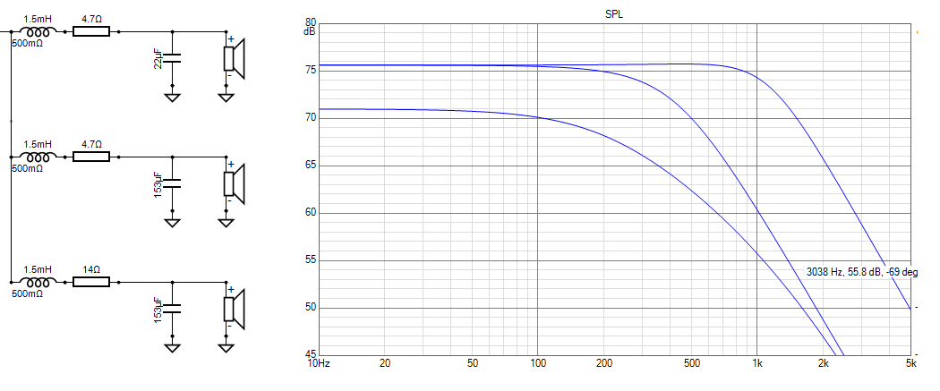

This is an update on the mid range filter and a question. I've added more caps and now the mid range filter has 153uF. The upper piano notes are still a bit too predominate so I increased the resistor value from 5oHms to 14oHms and it was an improvement. But the upper piano notes are still a bit too predominate. My question is, instead of adding more caps would increasing the resistor value be a good option? That would be much less costly than buying more caps.
I don't have equipment to do that. I use my ears. I've built other XOs that sounded good to me. Bottom line is would increasing resistor value instead of increasing cap uF value be reasonable?
Thanks Allen. The mid XO point is supposed to be 3000Hz. So if I understand your plot, the two curves using 153uF should have significant drop off (lower volume at higher frequencies) than the22uF curve. Is that correct?
That's right.

Ok. As the plot suggests you can adjust level with the resistor, but maybe you need to change the capacitors at the same time.

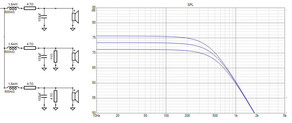

I found a few L-pad calculators and the formula on the web. I tried three and they all came up with the same results. I'm using Erse's calculator. Love those alligator clips.
I was amazed at the effect of adding an resistor across the driver. I started with a 2.2ohm and the upper piano not'es volume was reduced. Next I replaced it with a 1.5omh resistor and there was more reduction. Next I replaced it with a 1.0ohm and the reduction was getting close to what I like. Next I replaced it with a 0.68 and it was just about right. Next I tried a 0.47 ohm and the upper piano notes got much louder. So I'm sticking with the 0.68ohm resistor. But why would the 0.47 have made the upper notes louder than the 2.2ohm resistor? The series resistor is 5.0 ohms. Would reducing that increase or decrease the upper notes volume?
What you do is not the way it should be done. Putting smaller and smaller resistance across the speaker is basically shunting an audio signal to ground.
But you are presenting lower and lower impedance to the amplifier. Not only this leads to higher distortion, but at higher power may damage amplifier.
If you want to attenuate some band after crossover going into speaker, use proper l-pad. It reduces the volume, but maintains constant impedance for amplifier.
See pic.
And btw what you describe 0.47 being louder than 2.2 ohm is nonsense.
See pic.
I don't know what the cause is but it's possible that the treble becomes dominant as the midrange goes below that level.
We discussed keeping the series resistor in place. As long as it is there it should allow experimentation.presenting lower and lower impedance to the amplifier.
