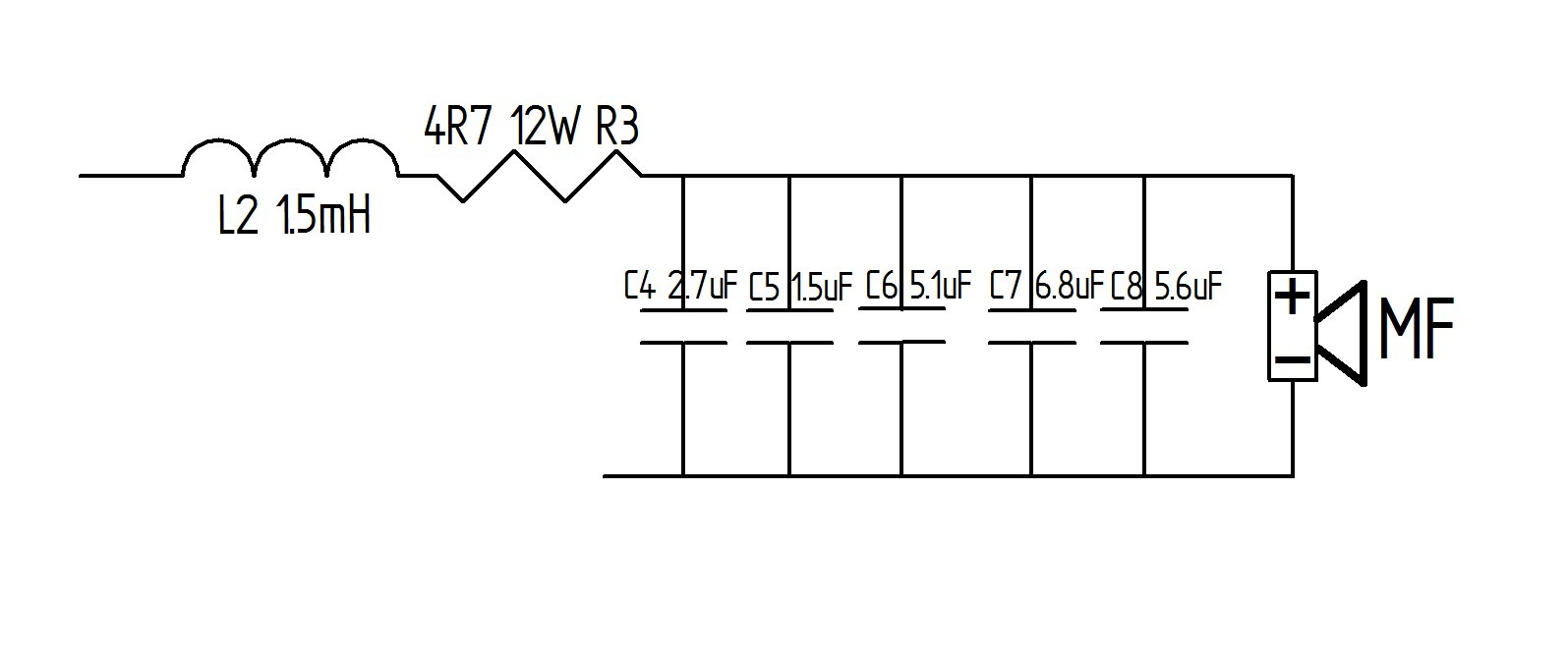

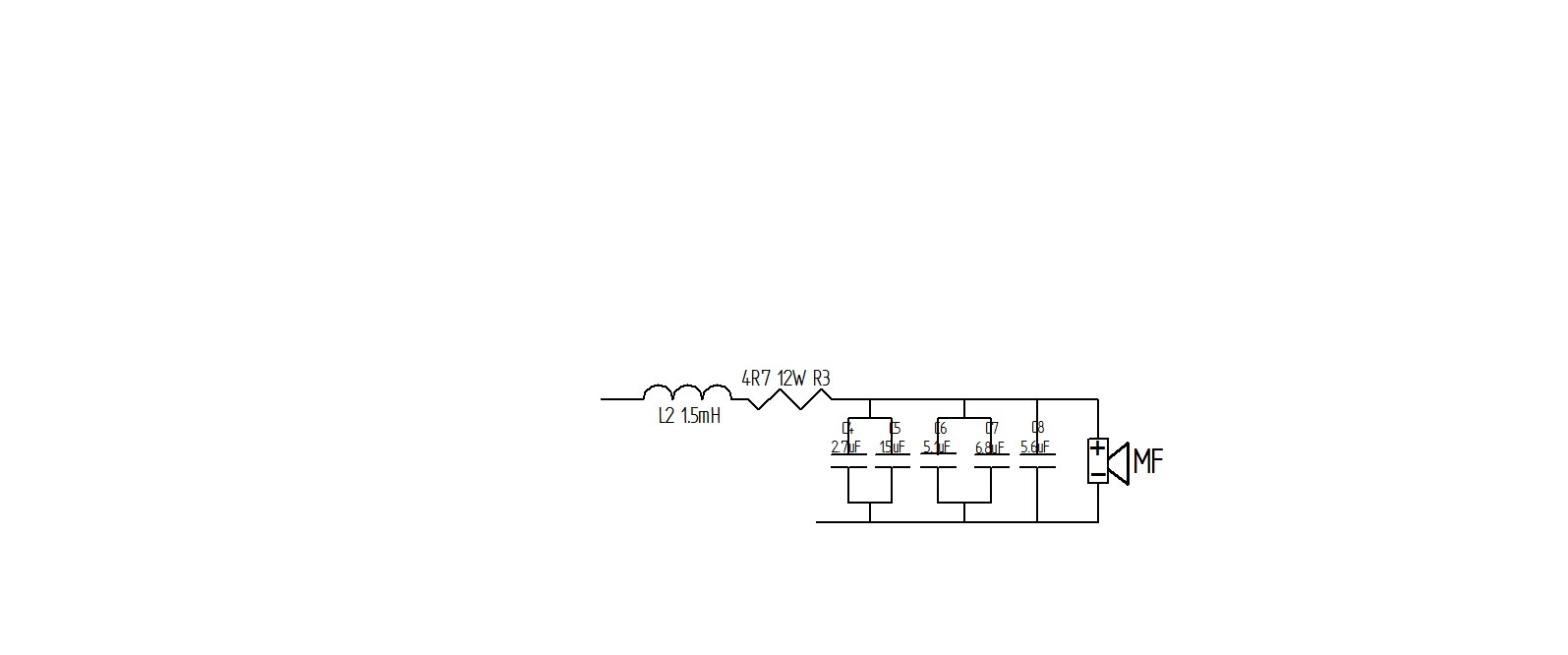

So I’ve been playing with a bunch of Dayton precision caps and now have three groups of caps in parallel, a Jantzen superior Z 5.6, a combination of Dayton precision caps = 5.2 and another group of Dayton caps = 5.2 The sound has never been better. It seems the louder upper midrange was masking much of the tweeter. The tweeter is now is much more revealing of cymbals, ect.. I have a few 0.47 and 0.22 caps I’m going to play with for a final tweaking. This is fun.I'm not familiar with the term bypassing.The XO mid range filter will just have the two caps in parallel.
So now, considering the system as a whole, including the room, I think the sound is as good as it can get. The 3 parallel groups of caps are: 1. Jantzen Superior Z 5.6, grp2 Dayton precision 2.7, 1.5, 1.0, grp3 Dayton precision 27, 1.5, 1.0 and 2 0.47s. My question is will replacing 3 caps in grp2 a with 5.2 and 5 caps in grp3 with a 6.14 potentially make a difference. I realize a 6.14 probably doesn’t exist so I would use something close or possibly two caps.
I must have OCD. So now, after listening for two days, I wanted to very, very, very slightly reduce the upper midrange just a smidge. So I added my last two Dayton Audio precision 0.22 caps, one to grp2 and one to grp3 and I like it. And again would replacing multiple caps, in grp2 and grp3, with one cap, in each grp, have any effect on the sound? Now I need a sedative.
I've been listening to one channel at a time because the ten caps, comprising grp2 and grp3, are in one XO. So I connect that XO to the right speaker, then connect it to the left and repeat, repeat... The total of 10 caps = 11.8uF so I plan to buy two 6.8uF and two 5.1uF caps. I think

I just finished the day listening to Keith Jarrrett, Charles Lloyd, Miles Davis, Tiger Okoshi and Mahler's 5th. And 17.4uF in the midrange filter, split over three caps in parallel, is the magic for me. and I aslo listened to Django Reinhardt, just to hear if guitar sounded right. It did. And I may have mentioned, in an earlier post, that I'm a classically trained flute player and have played in jazz clubes in NYNY. My ears are as important as my techincal skill.
So the 10 caps, with a combined value of 11.8uF, were replaced with two caps, with a combined value of 11.9uF, thinking the sound would be the same. That didn’t happen and the upper piano notes were again overly predominate. So I added a 2.7uF and 1.5uF, and now the overly predominate upper piano notes are back to where I like them. Is this typical?

That is one way to look at attenuating the bass response with the upper woofer's 4R7 resistor .
The added resistor also changes the shape of the 2.5 way acoustic crossover, as well as the addition of the capacitors (an additional 90 degree delay) has also changed the phase response between the upper woofer and tweeter.
Normally, one would change the value of the series coil (1.5mH) when going from first to second order, though without measurement, hard to tell what the acoustic crossover has ended up as.
The Haas precedence effect does make the leading tweeter sound louder...
Reversing the polarity of the tweeter to hear whether amplitude response in the acoustic crossover region increases or decreases would be another iteration to pursue if it wasn't in the first ten. Of course, a polarity reverse may also require a different capacitor value..
