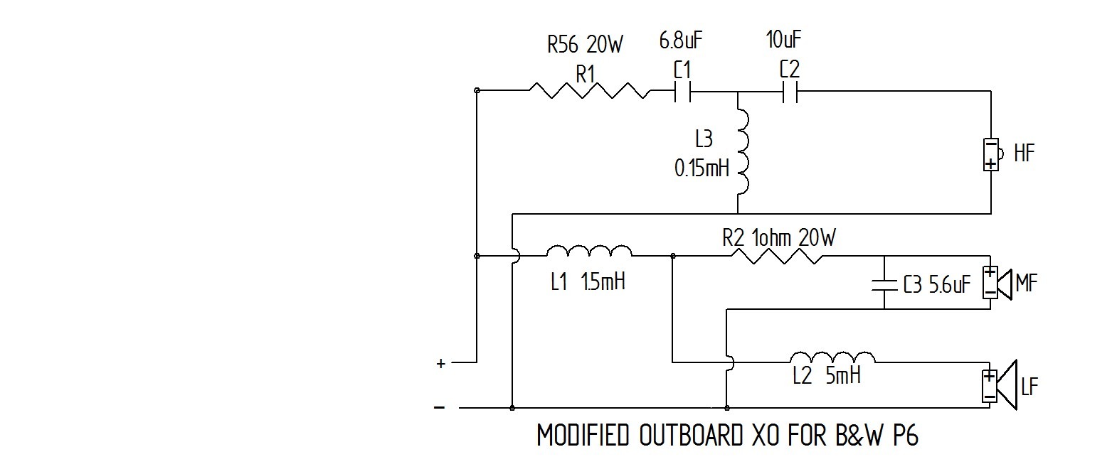

If the whole mid range was a bit bright/loud would a resistor in series be useful? See updated diagram.

Working with limited information... The resistor might have more effect on the lower end than the upper.
I added the resistor to the mid because I thought that adding R1 to the tweeter filter reduced/attenuated the signal across the whole range of the tweeter. Is that assumption wrong? And I showed R2 as 1 ohm just because I have some 1 ohm resistors
Sort of wrong, it's complex. If the drivers were a simple R it would work, but they are not, their equivalent electrical circuit is complicated. At a very simplistic level the drivers have self inductance in their voice coils, which causes the impedance to rise with frequency, so the attenuation effect of a series resistor reduces as frequency goes up. From your description that's not what how you want to tweak the midrange.

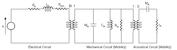

Just for information, below is a simplified electrical equivalent circuit for what the crosover "sees" connected to the output of each section, i.e. the driver. Any change to the crossover circuitry is interacting with this imaginary equivalent circuitry inside the driver, which isn't drawn on the schematic. In the circuit below, the crossover electrical output from one section is represented by the '𝖾↑' symbol on the left hand side, and on the right hand side '𝗿𝖠' represents acoustic output of the driver. There are three drivers in your system and each has a similar equivalent circuit. The total acoustic output of the system is notionally the sum of the three 𝗿𝖠's, but still must take into account the physical positions of the drivers relative to each other and the shape and size of the baffle.

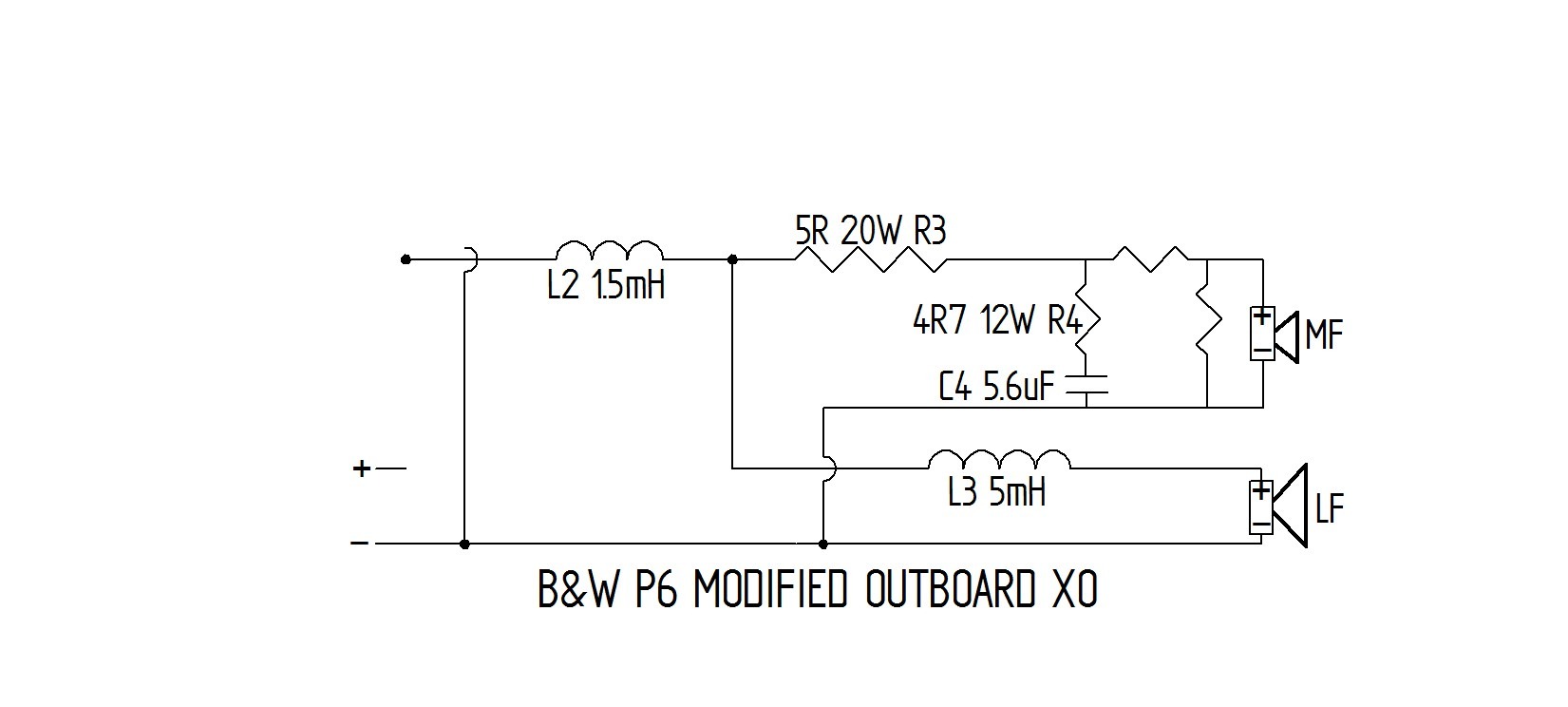

So I’ve tried resistors in series from 3R to 9R and none tame the overly bright/loud upper piano notes. My attachment shows the addition of what I thought would be an L pad. Does this make any sense? Or are there other ways to attenuate the problem tones?The B&W site seems to have no specifics for the drivers in the P6. Your diagram identifies the tweeter as DT 94 4ohms and the mid and woofer as WS 17 E 8ohms. What do the lables relate to? Do you know the specs. for the P6 drivers?
