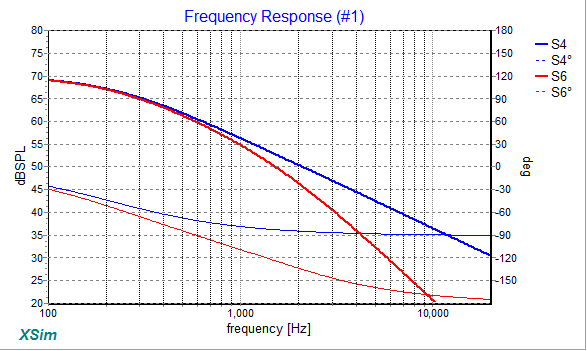

I would appreciate your demo. And based on my findings shown in my post, what might the woofer crossover slope be?No, the woofer would roll off faster because the mid connection between the inductors disrupts them. I can arrange a basic demonstration if Henry would like.
Not much more steep at the start, because this passive LRLR filter isn't the resonant kind. However it is second order so you can expect to see up to 12dB/octave. There would be a phase difference between the woofers but most likely within allowable limits so there should not be a problem between them.
Since woofers are not resistors it won't be exactly like this. Maybe less than this example using your component values..

It might be interesting to see the effect of driver inductance on the low pass slope by modelling the upper mid-bass as 5Ω in series with 0.41mH, which are the approximate values for the B&W kevlar driver.Since woofers are not resistors it won't be exactly like this. Maybe less than this example using your component values..

Unless I have made a mistake, using a crude equivalent circuit for the mid-bass driver (Le = 0.41mH and Re = 5.0Ω), the slope of the crossover output for the bass driver has a maximum of ~8dB per octave just above the turnover frequency, reducing to 6db per octave at higher frequencies.

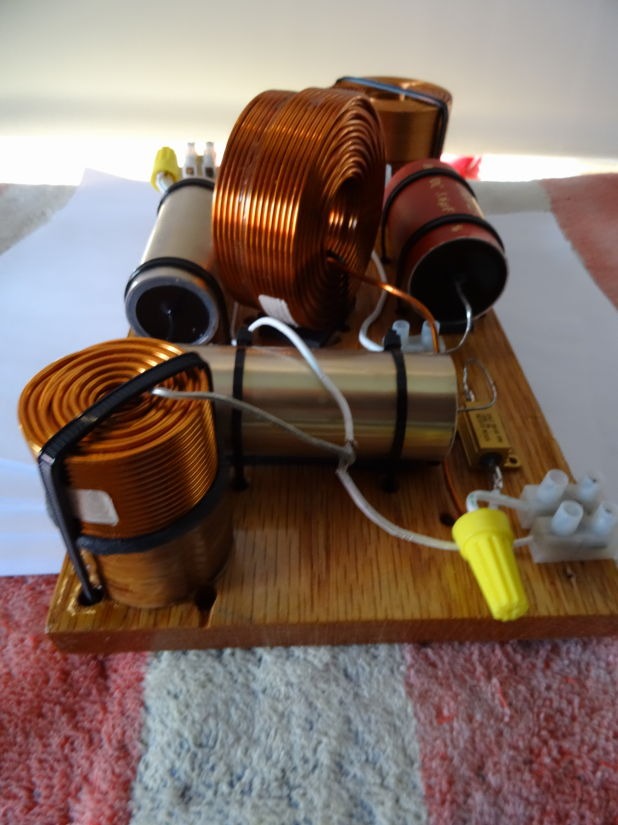

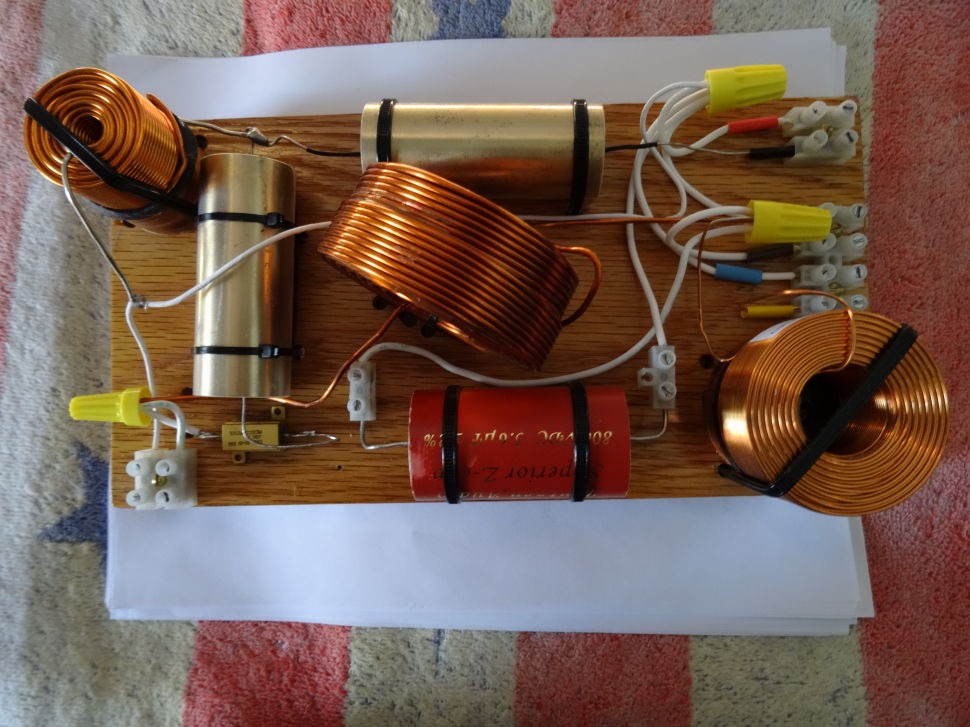

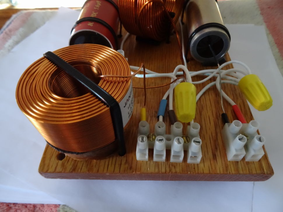

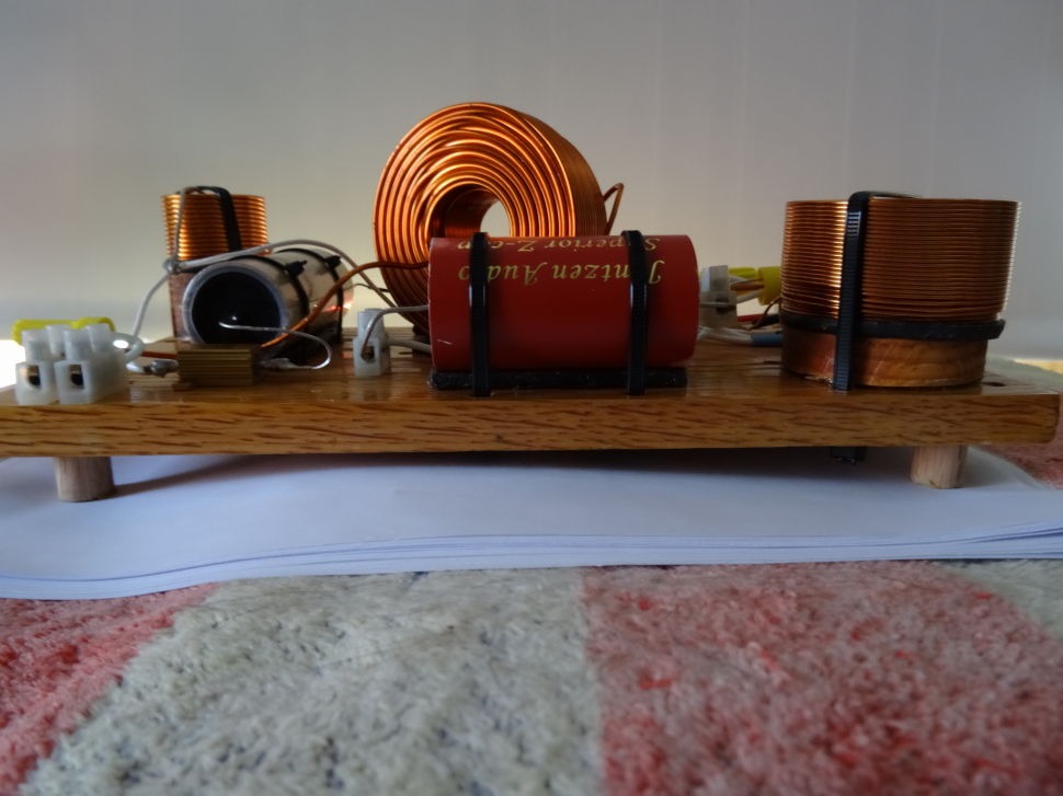

The P6 modified XO is done. Is it considered acceptable to use wire nuts instead of soldering? The wire is PTFE Style 1199 16 AWG silverplated copper wire.

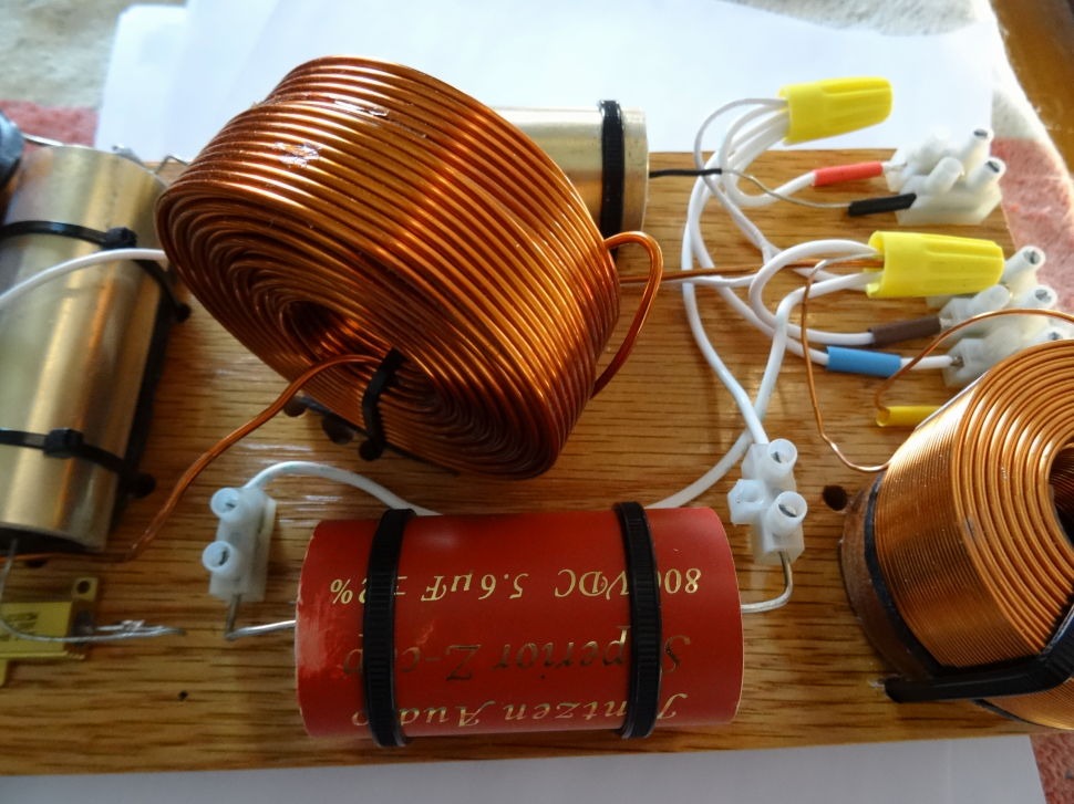

I used a 0.68ohm resistor for R1 in the tweeter filter and it blocked almost everything going to the tweeter. With my ear next to the tweeter I could barely hear the cymbals on jazz CDs. Now the sound from the tweeters, without R1, is very good. Could the addition of the 5.6uF cap in the mid range filter changed the mid range response such that R1 was not needed in the tweeter filter?The P6 modified XO is done. Is it considered acceptable to use wire nuts instead of soldering? The wire is PTFE Style 1199 16 AWG silverplated copper wire.
No, more likely you would need to increase the attenuation of the tweeter to maintain a perception of low and high balance, at least according to System 7's sim here: #39
Did you measure the value of the resistor to make sure it was correct? 0.56Ω is a small value that should only attenuate the tweeter by less than 1dB, equivalent to less than one click back to 11 o'clock on the treble control of most amplifiers.
Henry, a question like that assumes that both drivers are covering some of the same frequencies. However the idea that you can turn one up to compensate for the other is a little off the mark. It's more that you should get them working at similar levels. It sounds as though you are far from where you want to be.
So I ask about the 5u6 on the midrange. Do you think it's a little small?
The resistor I put in the tweeter filter are marked Dale 1% 0.68 and using my BK Precision LCR meter they measured 0.69. I will remove the 5.6uF cap from the mid range filter. This will make it match the factory B&W P6 XO and I'll hear how the sound changes.
