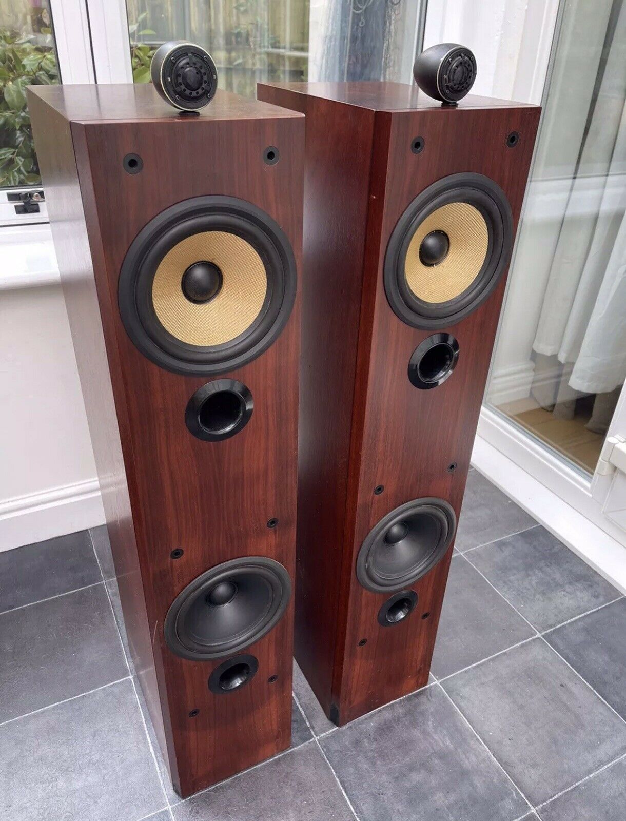

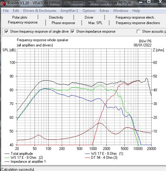

Well, those are 3 way! And not in the 85 dB league! When I say 'put it in the picture', I really meant :show the speaker!
The distance between wf and mid...see the value of the inductor (subwoofer league)

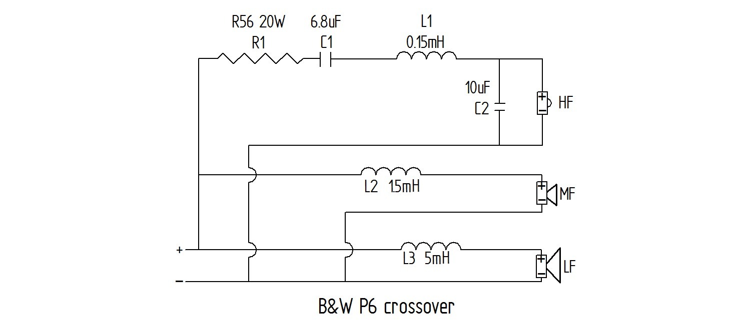

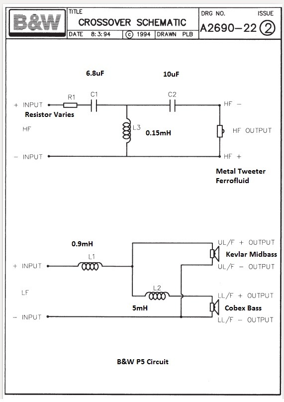

Hi, I saw the specifications the other day... What puzzled me was the value of the LP(low pass) inductor, so my mental wandering on sensitivity and efficiency of the system. The schematic above has the tweeter path components put wrongly.

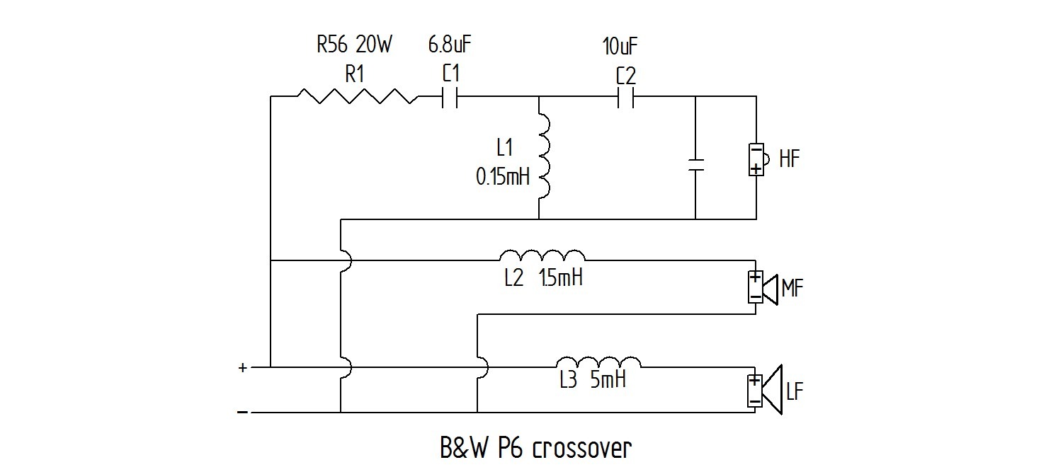

I also thought C2 in the tweeter filter was in an odd location. However I followed the component + locations on the actual P6 crossover and it seems the + from the amp is connected to R1 which connects to C1. Then the other lead of C1 and leads of L1 and C2 are all soldered to a + section of the PCB. The other lead from C2 is soldered to a - section of the PCB. I put paper circles, marked + and -, on appropriate PCB sections. The photos show where C1, L1 and C2 connect to the PCB. That is what led me draw the tweeter filter as I did. Please let me know if my interpretation is wrong?
Well, the plus and minus in loudspeakers indicate the correct phase, so where's the joint of C1, L and C2, there's no driver attached so it's meaningless.
Sometimes the driver needs to be phase reversed so you'll see the minus instead of plus. It goes together with filter theory as every order of a filter brings 90 degree phase rotation... Tvrge3k and Johnmath already explained it very well

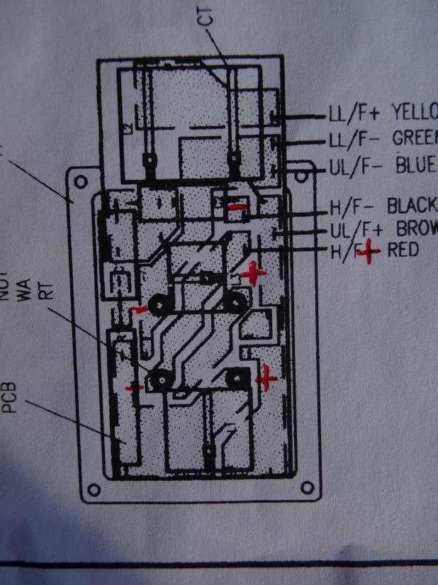

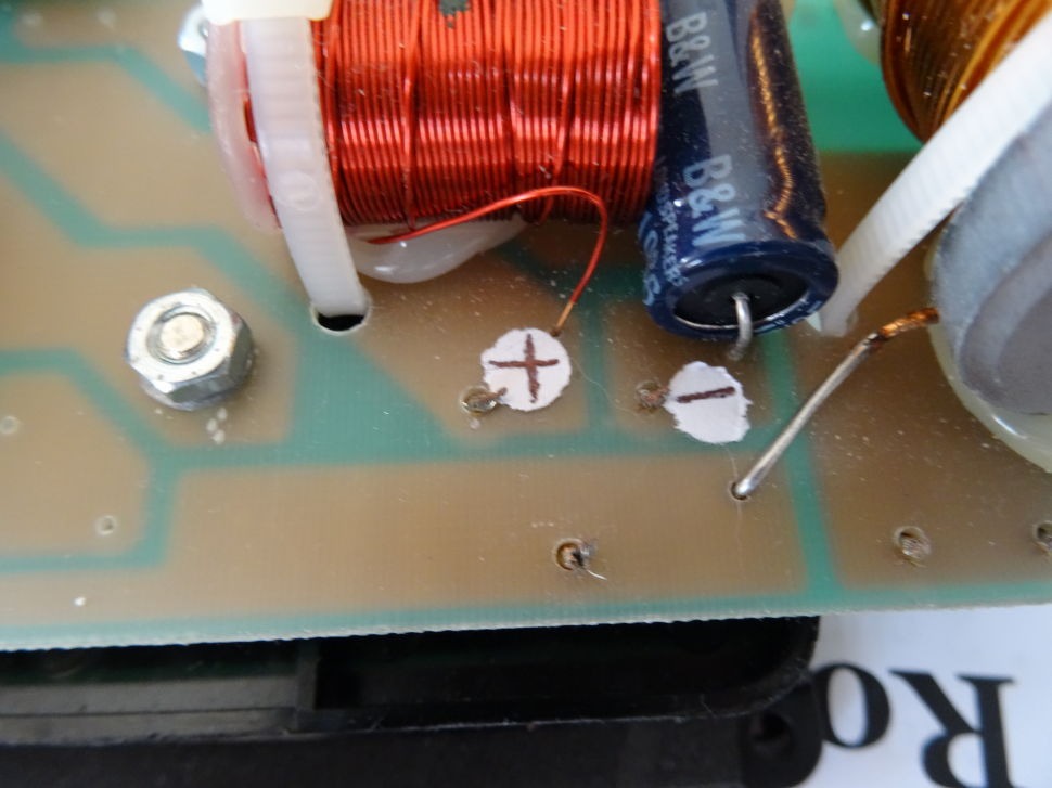

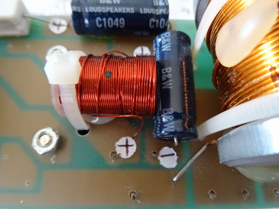

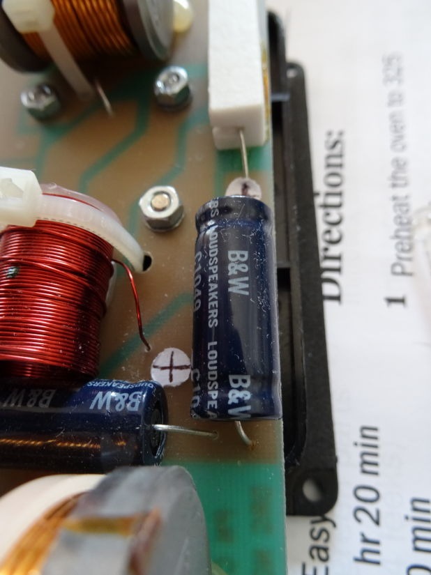

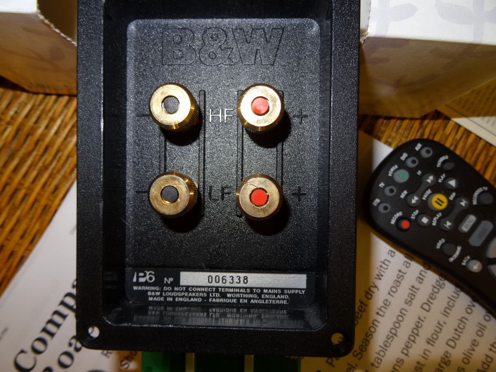

It is really simple to know what sections of a PCB are plus or minus. The speaker wire connections are shown in the last B&W photo of the crossover diagram and also the the wire connectors on the back of the speaker are marked + and - .So with a multimeter it is fairly easy to follow the positve and negative paths on the PCB
My first step in trying to understand the origninal B&W P6 XO filters was to look at the attached photo. That allowed me to know where the plus and minus for the low filters and the plus and minus high filter pass started. I then took the PCB off the mounting block and started to trace the filter paths using a mulitmeter set to the continuity position.

The difficulty comes from not understanding implied meanings that would be apparent if you knew more about the physics of electronic components and crossovers. The circuit as you have drawn it will not work as it will not pass the high frequencies to the tweeter. If it is drawn correctly, then someone has fiddled with the crossover and I doubt the speakers would be much use for listening to music.
The (-) terminal of the connection panel on the rear of the loudspeaker does not necessarily connect to the (-) of the tweeter, it often connects to the (+) terminal instead. The correct connection (+) or (-) is a function of the position of the tweeter and midrange relative to each other, as well as the crossover frequency, and the topology and order of the crossover design, and the measured FRD and ZMA performance data for each driver measured in position on the baffle. The objective is (usually) to have the drivers sum and provide ½ the energy each at the crossover frequency, and that might mean that one of them is reverse connected relative to the input terminals.
I am intrigued by the large inductor. It looks like a P-core with discs from Jantzen Audio, and therefore unlikely to be original, which begs the question: what other changes have been made?

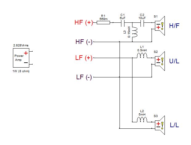

this is the crossover for the B&W P3 as I make it out from the service manual, drawn with XSim. The exclamation marks on the speakers are there because no FRD or ZMA data has been entered for the speakers as I don't have a P3 to measure the drivers. Note that the tweeter polarity is inverted, and by mistake I have drawn the crossover as if the (-) input link is connected.
Actually I have made another mistake (typical day for me!) The PCB layout in the B&W service manual is not very clear, but reviewing photos of P6 crossovers clarifies that inductor L2 for the L/L (lower low frequency driver) connects to the righthand side of L1 (≡ to the (+) terminal of the U/L driver), not the LF input terminal.
You did wrong. The correct crossover is what johnmath designed. It is a 3rd order electrical filter on the tweeter, connected with reversed polarity, and 1st order electrical filter on the mid a and bass. Note that there is no LP filter on the mid, the design evidently uses the natural rolloff of the mid enclosure to reach the target, the drawback can be a reduced power handling. Or, as a second thought, it is a sort of a 2.5 way design with different drivers for the .5 part (something unusual but doable). The tip here is a port also for the "mid" driver.My first step in trying to understand the origninal B&W P6 XO filters was to look at the attached photo. That allowed me to know where the plus and minus for the low filters and the plus and minus high filter pass started. I then took the PCB off the mounting block and started to trace the filter paths using a mulitmeter set to the continuity position.
That said, what let you think that you can do better than the B&W original crossover, changing components value and crossover topology without measuring? The proposed crossover in post #1 has the tweeter connected inverted, and a lower crossover point for the mid and bass, this will ensure holes in the FR.

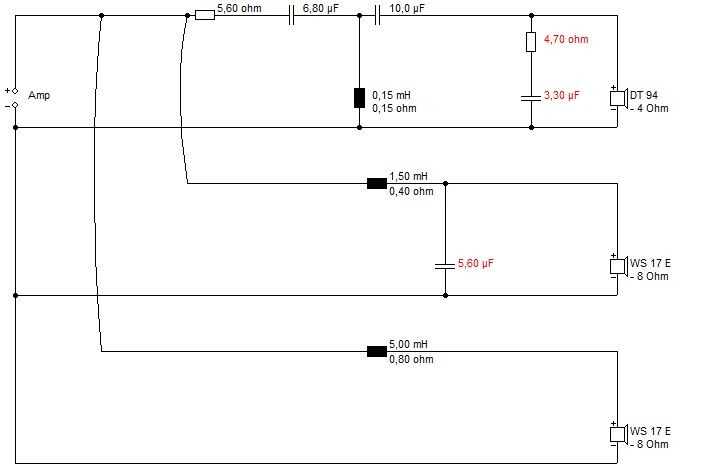

Well, I looked up the P5 circuit which is all we have really. And did some simming. I doubt if it matters much the precise bass coil arrangements.
But the interesting thing is that adding a 4.7uF shunt capacitor and 1.8R resistor to the bassmid is a well known tweak on B&W 6" Kevlar speakers. Reduces cone breakup around 5kHz. People usually take the tweeter level down too. Because B&W can be a bit showroom bright.

Thanks for the info. Last night I did a bit more checking the high pass filter with the multimeter and also found the tweeter polarity is to be inverted.this is the crossover for the B&W P3 as I make it out from the service manual, drawn with XSim. The exclamation marks on the speakers are there because no FRD or ZMA data has been entered for the speakers as I don't have a P3 to measure the drivers. Note that the tweeter polarity is inverted, and by mistake I have drawn the crossover as if the (-) input link is connected.
