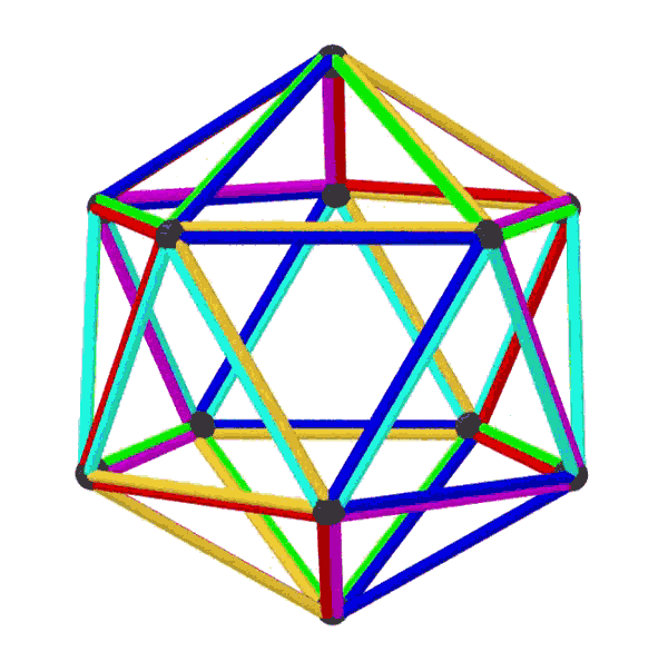

Very interesting! Is there a thread on this project yet?Yes. 20 identical equlateral triangles. A 3D printer is on my shoppng list.

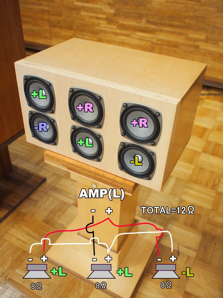

Oooh, very cool. I think this is something I had thought of in the past, but have forgotten about.1BOX Speaker Matrix System
Have you tried it yourself?

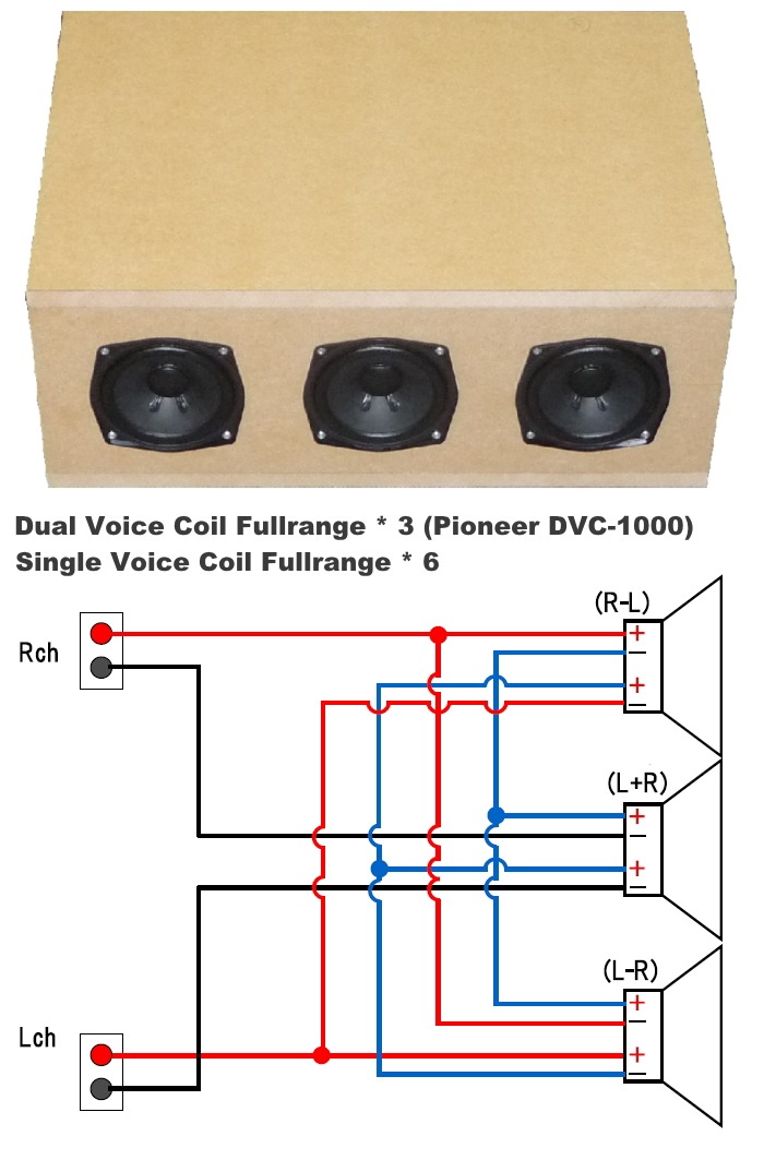

I think I'll have to prototype this out with some cheap speakers and a foam core box. It seems like left/center/right should have their own chambers, otherwise the R- speaker would be fighting against the two R+ speakers (same for left).
Not many dual coil full range speaker options out there, so the 6-speaker solution is more likely.
Though now that I'm thinking about it more, isn't this just another take on a Mid/Side matrix (or Sum/Difference, same thing)? But instead of encoding the matrix at line level, the signals are summed and subtracted in the air (or in the speaker coils if you have dual coils).
One big difference is that this one has all the speakers facing forward, so having suitable surfaces to bounce audio off isn't necessary.
What if I used this method, but with the speakers distributed over a 20-sided icosahedron? It sends the mind reeling!

Yes, i had figured out how to do the pantagons, the triangles will be easier. But i am getting a 3D printer and it will mke the driver cutouts much easier.It should be quite doable even without a 3D printer. 20 plywood triangles can be cut fairly precisely with a good table saw jig

Is this just an adaptation of the hafler circuit?1BOX Speaker Matrix System

The twenty side speaker is something that I would like to try, the problems getting good and cheap full range drivers here. Building one with a 3D printer would be easier than cutting for sure.

How big will it be? That could be an awful lot of material used.Yes, i had figured out how to do the pantagons, the triangles will be easier. But i am getting a 3D printer and it will mke the driver cutouts much easier.
I am imagining the drivers mounted from behind. White drivers in ablack box?
dave
Maybe I just have 3D printer envy!
If I did the plywood method (and I'm tempted), I'd just buy a 35mm (or whatever is correct) Forstner bit, and use a big cove router bit to thin out the plywood a little on front. Use some walnut-faced plywood...
I will be making it as small as possible to get C-C as close as feasible.
I am looking to get one of the Form 3 printers. Means i’lk be able to do phase plugs, and small speaker boxes.
