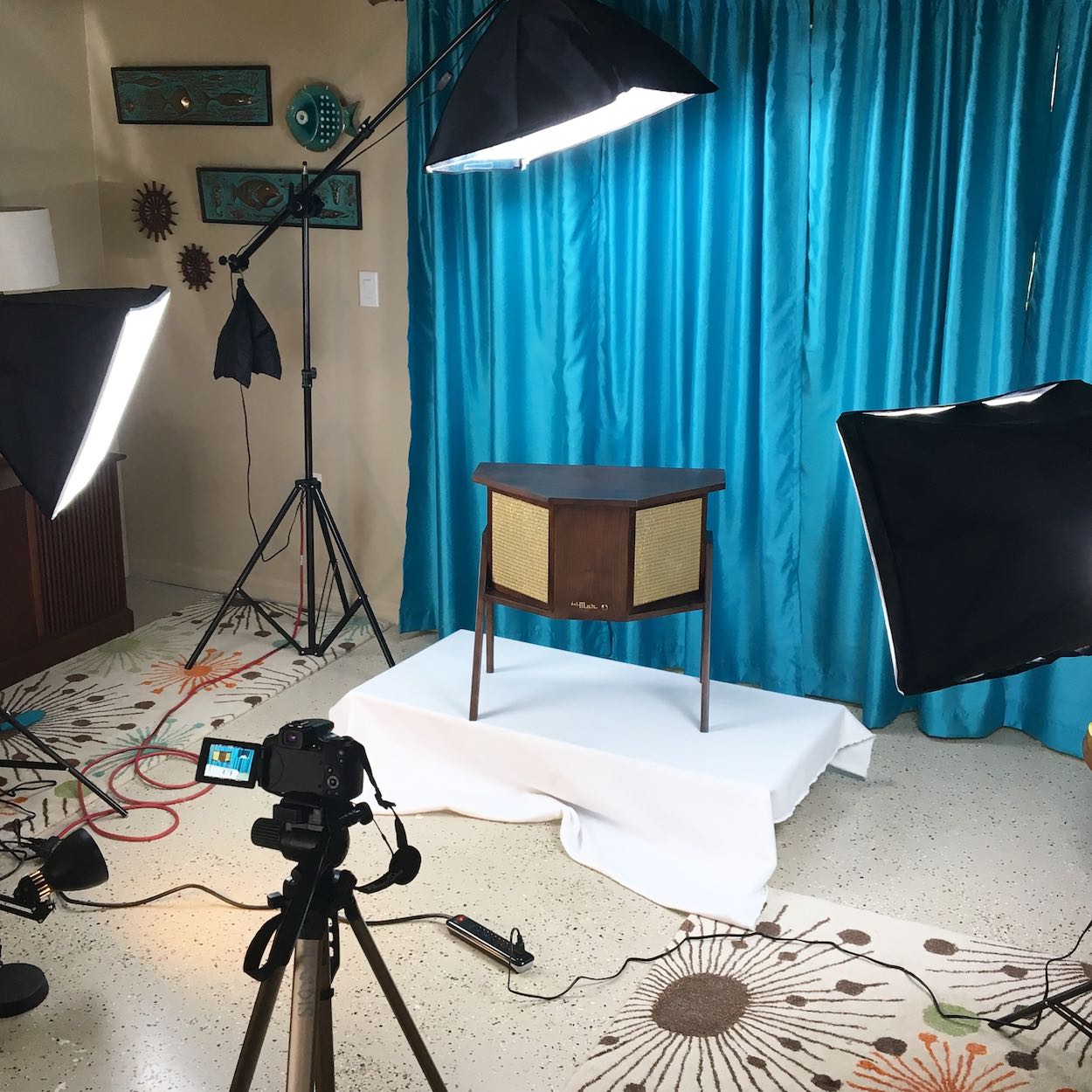

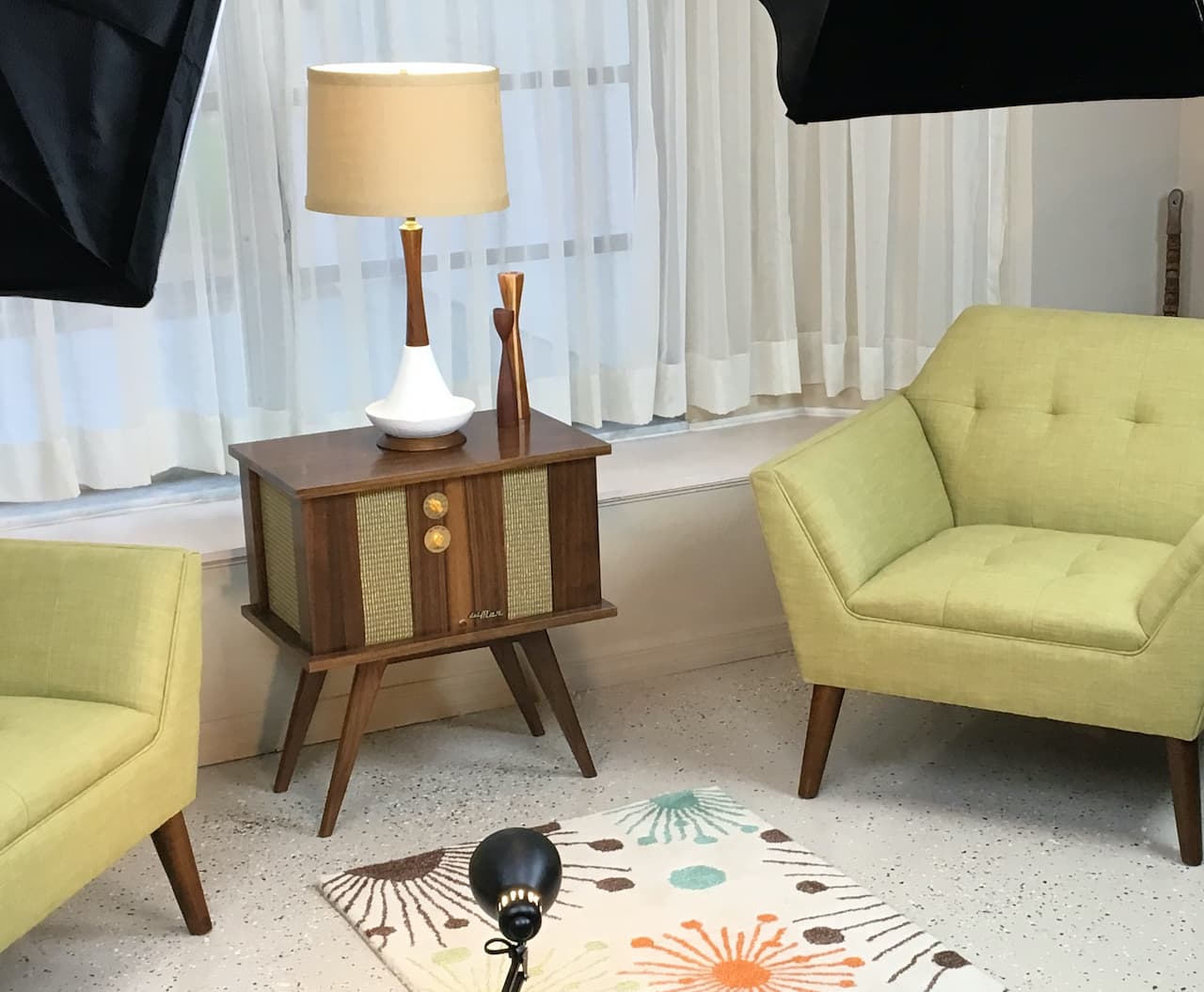

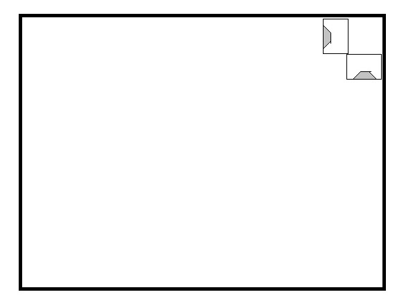

One friend did this to his living room with pretty nice results, decent seperation.
Both speakers clustered in the corner.

That's interesting. I could totally build a tall contraption to sit in a corner (or wall mount), radiating L/R in two directions.One friend did this to his living room with pretty nice results, decent seperation.
Problem for this is that my only viable corner would be BEHIND the general sitting position - we typically sit facing roughly towards the bottom left corner.
But since this kind of setup relies a lot on reflected sound, maybe it could work. Probably not, though - a 100% reflected sound would get pretty muddled, swishy, and indistinct.

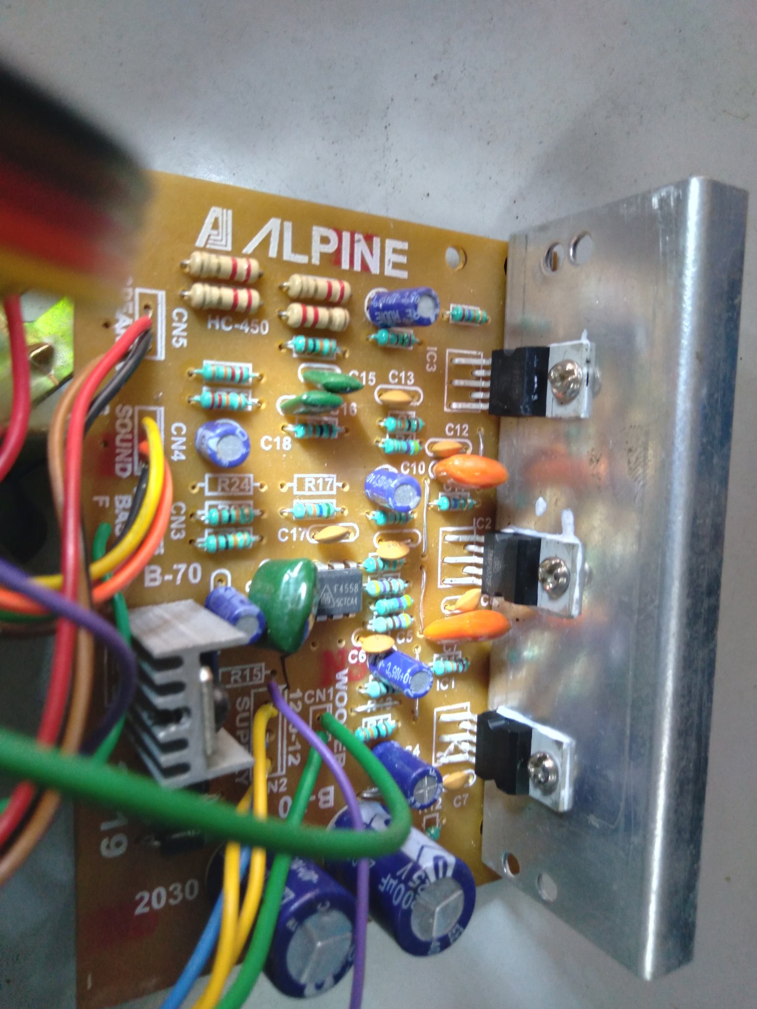

I used to build a number of stereo in one box units. They worked fairly well as stereo, the ones with angled speakers sounded the most stereo, as long as the angle was too steep. Some I did with front facing tweeters and side firing woofers, which had a nice effect, though less like typical stereo.
Here are a couple of them.
It is a populated PCB based around Chinese 2030 ICs running at 19 v, with a 7805 to supply the FM/USB/Bluetooth module.
Linear 12-0-12 transformer, quoted as 3 but really near 1.5 Amps.
A 0-12 line is tapped for the 7805, the kit comes with the 7805 on it, quite common here. $3 for the populated PCB in the picture.
I think that is enough for a 300 square foot room.
At least for background chatter on the FM and some music, nothing too loud...have spare systems for that.
Tentatively, 18" wide, 9" deep, 6" high.

Yes, room furnishings are a factor for that corner system that I posted.That's interesting. I could totally build a tall contraption to sit in a corner (or wall mount), radiating L/R in two directions.
Consider that the walls are the main reflective surfaces, and the corner placement will intensify the bass.
You can put one speaker in the bottom, amp in the middle, and other speaker at right angle on top to get a compact corner unit, similar to the one above by a friend of Wise...

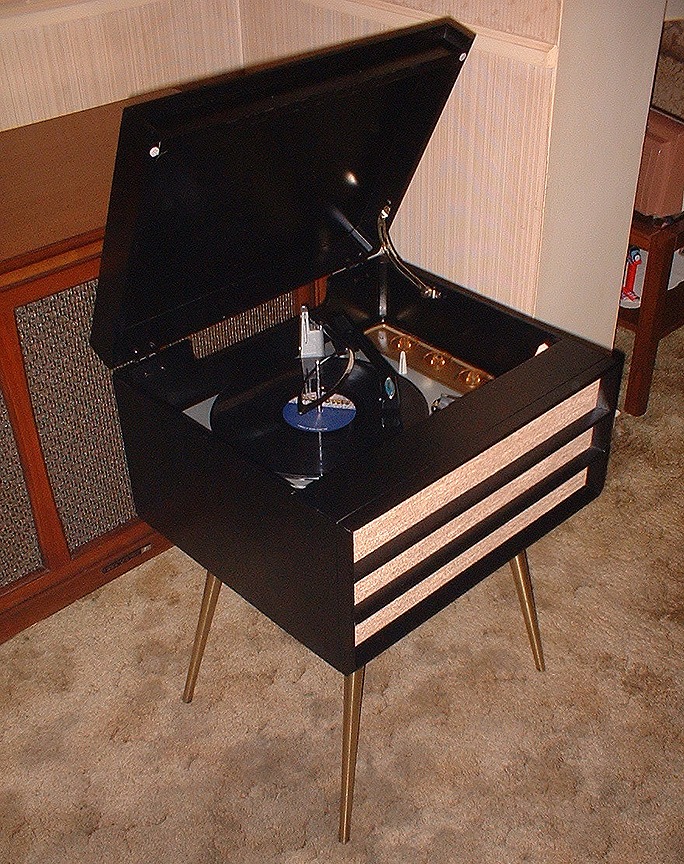

I've got this nice old 1956 RCA phono up in the bedroom.
It was that "blonde" color, but after I restored and modded it, I decided on satin black.
6V6 PP amp, it kicks butt.

I actually built the amp chassis from scratch with just a touch of global feedback, and the record changer is a newer model (1963) RCA Studiomatic from another larger console.I bet it does! Yes that form factor can work well IME. How the speakers are angled changes how the stereo effect sounds.
With a nice light-tracking (4gr) stereo ceramic cartridge wired for mono of course. (EV149D)
As for the speaker(s), across the front is a 6x9 in the center, flanked by a pair of 5x7's - making the whole front essentially a giant speaker.
Each speaker is 12 ohms, all in parallel, making 4 ohms load to the mono amp.
