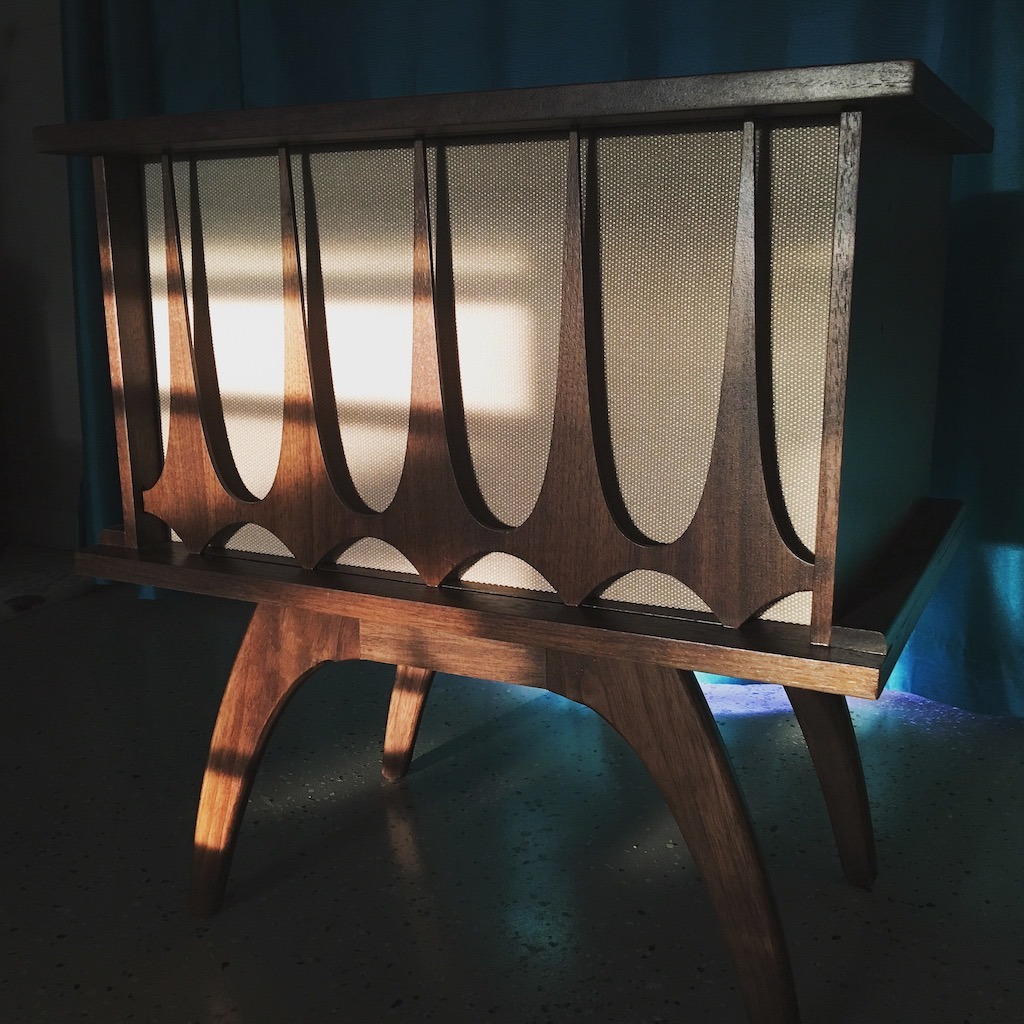

Thanks! My favorite was this one - the Brasillia. I made a lot of those.
As for getting stereo in a big omni sound, I don't think I've even achieved that. Perhaps it takes 3 or 4 drivers in some sort of matrix? Phase can do some surprising things. That may be my next project after we move house.

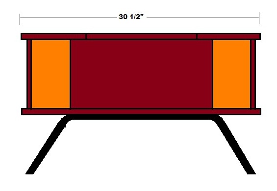

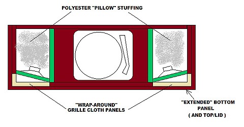

I'm planning out a small stereo phono "consolette" in a similar way -30 inshes wide-18 inches deep - 12 iches high, on a set of angled black painted iron legs.
Like this...click to see details
Oval woofer/mids, 2" tweeters, a 10//10W STK amp and a vintage new-in-the-box but never installed 1967 Admiral Ensign changer.
The top lid and bottom will extend 1/2 inch out from the vertical walls like that Brasilia style.
Rear "aux in" RCA jacks for versatility

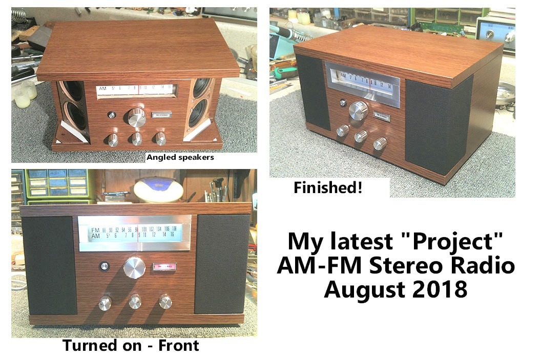

As for the angling, I did that sort of thing with an AM/FM stereo radio project back in 2019 with good results, those panels were on a 45 degree angle. - bit of a pain making the two-sided grilles though.
See my (rough) photos for more details.

The AM/FM stereo radio uses 4 tiny (2.5 inch) woofers (sealed air suspension) and 2 piezo tweeters driven by a TDA2009A (10W-10W) chip.
The phono consolette will have a pair of 5x7 high compliance, high sensitivity mid/woofers and 3 inch tweeters driven by an STK 430 (7+7 watts), also in sealed chambers.
Testing this system on the bench it'll provide more than ample volume for "normal" listening purposes.
So my 2030 kit is going to be in the same range, not too wild.
Planning ported enclosures, sealed off from the rest of the drivers, each speaker in a single enclosure with a vent.
