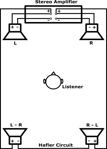

Is this just an adaptation of the hafler circuit?
dave
Seems like it, doesn't it?
Putting them inline like that (rather than as pseudo surround) kind of makes sense. With a signal panned far right, the center and right speakers would play a full positive signal, while the left speaker would play the same signal but out of phase. The acoustic interactions of that will likely give the impression of the sound being far outside the box on the right hand side.
Likewise, a center panned sound would have one speaker on each side playing out of phase, possibly steering the sound towards the middle.

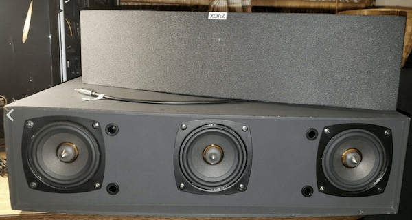

I think the old Zvox 315 sound bar used this method, adjustable with what they called "phase cue".

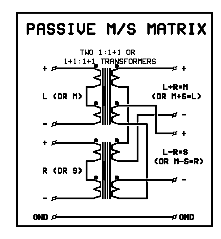

The transformer-based line level mid/side matrix I made (a temporary contraption with alligator clips) got the essentially the same results. L-R is of course the same as R-L, but phase reversed.
What is M and S?
Right, Mid/Side is primarily a recording technique using two microphones in a specific configuration, and also used for processing stereo tracks in a multitrack recording scenario. Coming from a recording studio background, I can forget that it's not an often used term in hifi circles.
I should just call it Sum/Difference instead, for clarity.

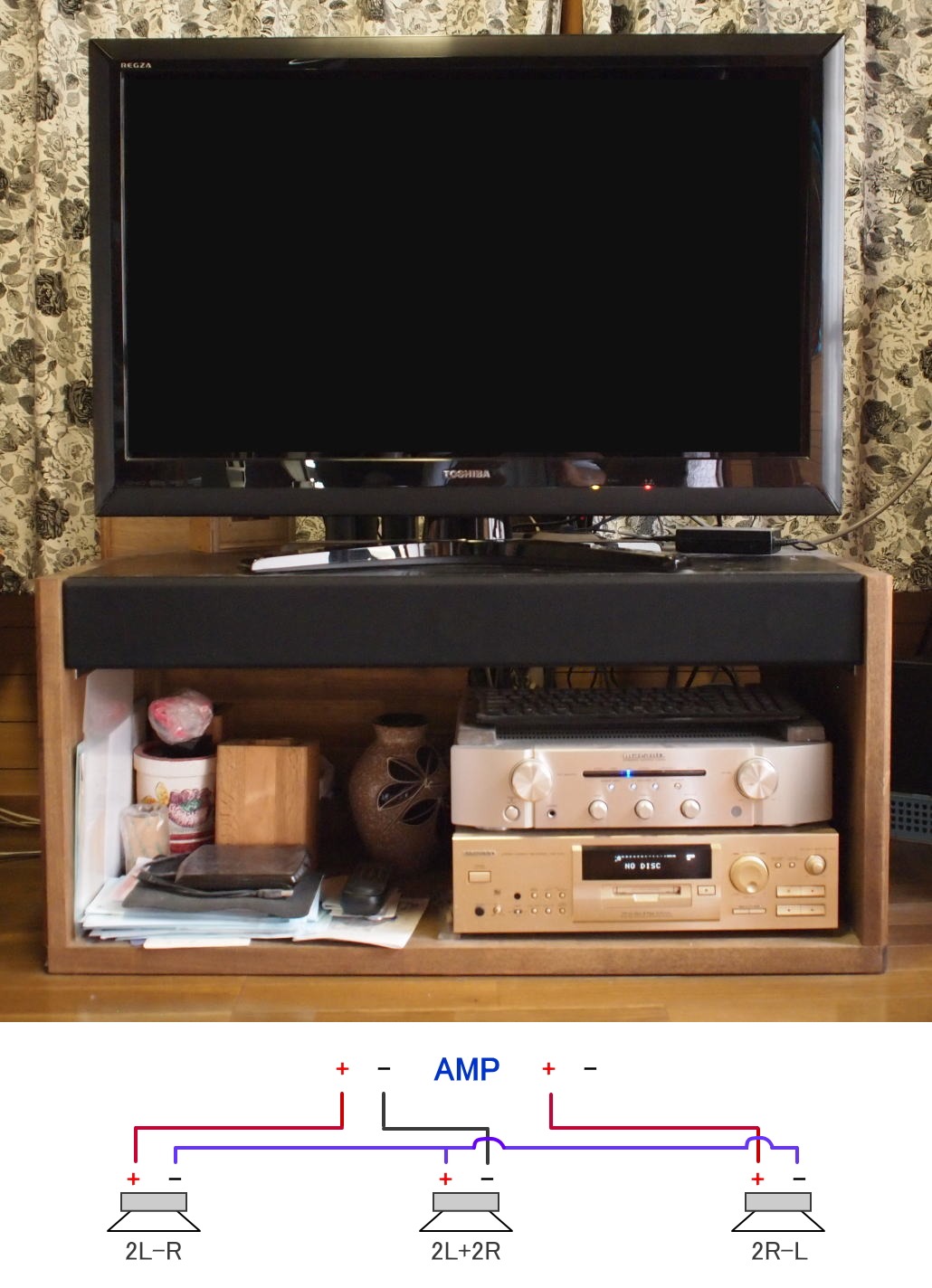

Sorry, I probably should know what that means, but I don't think I do.@mtorn Can you do also the weighted matrix (SSS) passively?
Can you explain the SSS weighted matrix?
It is the matrix used by Elias Pekonen in his single stereo speaker (SSS) - The front speaker uses 0.5 x (L + R), the side speakers R - 0.5 L and L - 0.5 R. It is essentially the same as in post #116 - the speaker side wiring does not work with bridged class D amps. I like the way the SSS works in my room, so I want to build an active version with a bass unit, all in a single floorstander box.
