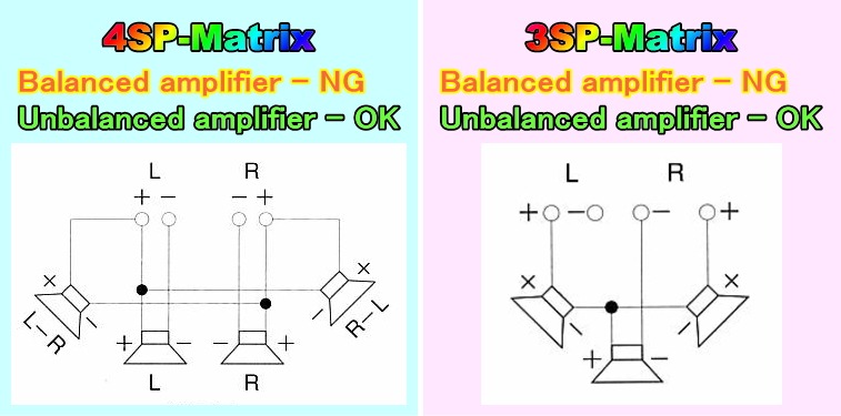

Four driver matrix sounded like mono with some faint swishing sounds coming out of the side speakers every once in a while.
Vocal intelligibility was better but didn't seem as good as two channel (didn't directly compare). There was some volume variation in voices with 4 driver that I hadn't noticed before, maybe cancellation of some kind in the middle. I think the three driver was better than the 4, more involving than the 4 driver or two channel, but lost too much vocal intelligibility for me. That's my main priority, I like to watch a movie not be yelled at by it. Other people might like the three channel. I have no walls on the sides, but it's hard to imagine the 4 driver doing much with them if they were there, three driver had much more sound out of the sides.
Could you describe what the setup was for the four driver matrix?
Actually, I'm not totally clear on what your three drive matrix was either?

The 4 driver has the center speakers one on top of the other..

Me too, it seems weird but the amp is cheap and I have others. Now I learned something, so it's worth the risk to me. 🙂
I think that's my point, though - what did we learn?
I'm assuming that the four driver matrix didn't work as intended. I can't imagine that mono with occasional faint swishes on the side is what this is supposed to do.
(any chance you got the polarity of the side speakers reversed? If so, you would have had the R-L side speaker next to the L speaker, which would cancel out much of the L signal, and vice versa)
I guess you can do a test, by hooking up only one side driver to the two + connections on your amp to see if it really can produce a Difference signal. Depending on your source material it should sound very echo-y, with the center sounds totally cancelled out. For pop music, things like the bass, kick, snare, lead vocals, should be gone, but their reverbs usually will be heard.
And if you have the capacity to pan a mono signal left-to-right (at the source, not with the balance knob on the amp), you SHOULD hear it strongly at left, fading to silence at center, then strongly again (but phase inversed) on the right.

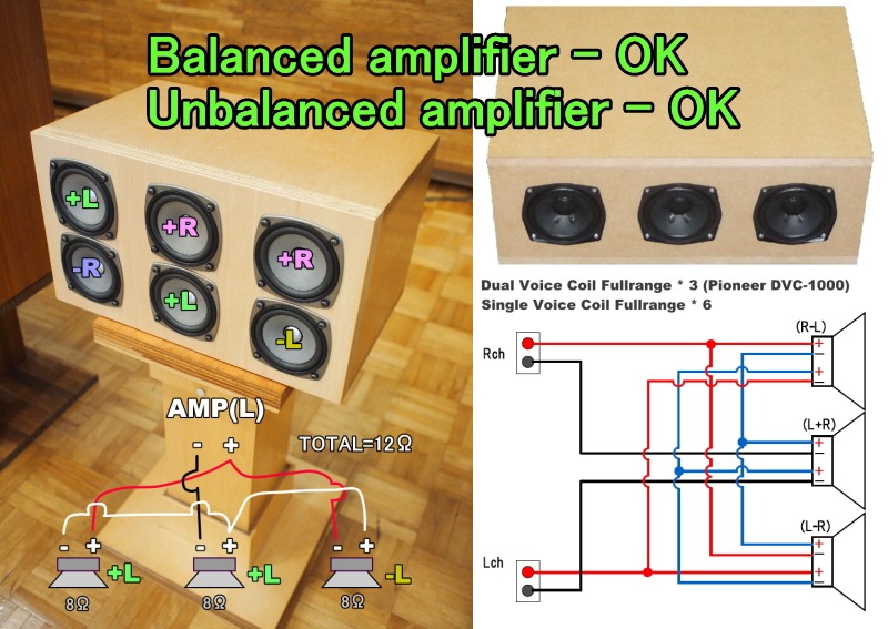

The six-driver acoustic matrix version posted earlier will probably not have such a clear result - putting two drivers close to one another, each playing a left or right signal with one of them out of phase, probably doesn't completely cancel out the center (the Sum) like an electronic matrix can.

Hi, pretty sure I hooked it up right. Pretty careful as I didn't want to blow the amp (yet). As I understand it since then looking at the information, in the 4 driver the left side speaker is left signal minus right signal, and the right side speaker is right signal minus left signal. So it makes sense that there would only be swishing sounds. I played a tv show that had no sound out the sides, and figure it must be mono.
The 3 driver matrix is referred to as 0.5 matrix because it only subtracts half the left signal from the right side and half the right signal from the left side, so there's more sound out the sides. If I remember right, with the three driver, they did sound rather echoey on the sides too. I think so.

Ah, so you were listening to a Mono TV source. No wonder it sounded like mono.
The swishing you heard on the sides could well have been slight differences in left and right, either from analog imperfections or digital compression artifacts.

The differences in four driver were not artifacts, simply the difference in audio between the left and right channels, which turns out was minimal in stereo, and non existent in mono. Because in mono the same thing is on both channels.
In the four driver, as I said, the two middle drivers are one on top of each other, one is the left signal one is the right signal, so = mono.

No sorry, that was not my intention. My point was mainly that these matrix solutions using amplifier hacks are finicky at best. In many scenarios they simply don't work right.You don't seem to be getting it, but instead are insisting on your own random theory involving me ****ing it up. lol.

From your description of your results, it just didn't seem like they sounded the way I think those designs are intended to sound. Who knows, it might simply comes down to descriptive word choices.
I did misread you about the mono TV - I got the impression that you only tried it out with a mono source, not some of each.
As for your amp, I peeked at the service manual, but I don't have the skills to determine if it's a balanced amp or not. Are home theater receivers typically balanced? All the speaker terminals do share a common negative connection, does that mean anything here?
I'm sorry too, I can see how you thought that from my bad descriptions. All I can say about the balanced/unbalanced is that I'm not familiar enough with amp topologies to be able to state with authority what unbalanced and balanced is, beyond a general understanding of the term either. In the Master Nagaoka thread the only amps that didn't work were BTL class D ones.
Beyond that, both the 4 and three drivers appear to me work the way they're supposed to, it's just that the 4 driver doesn't work all that great really. I did like the three driver, but two channel is still better imo. There are a lot more people building the three driver than the 4, if the amount of pictures that appear in internet searching are an indication.
