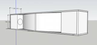

The Metregon does not have a LF horn. I want to try this reflector thing with two full range boxes. Just a piece of 3mm HDF bent into a radius.

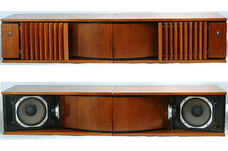

JBL Minigon. Note tweeters facing 45degrees into the curve. Worth a go using a full ranger (to 500hz or so).
A friend in Montreal had one of those. It was cute!JBL Minigon

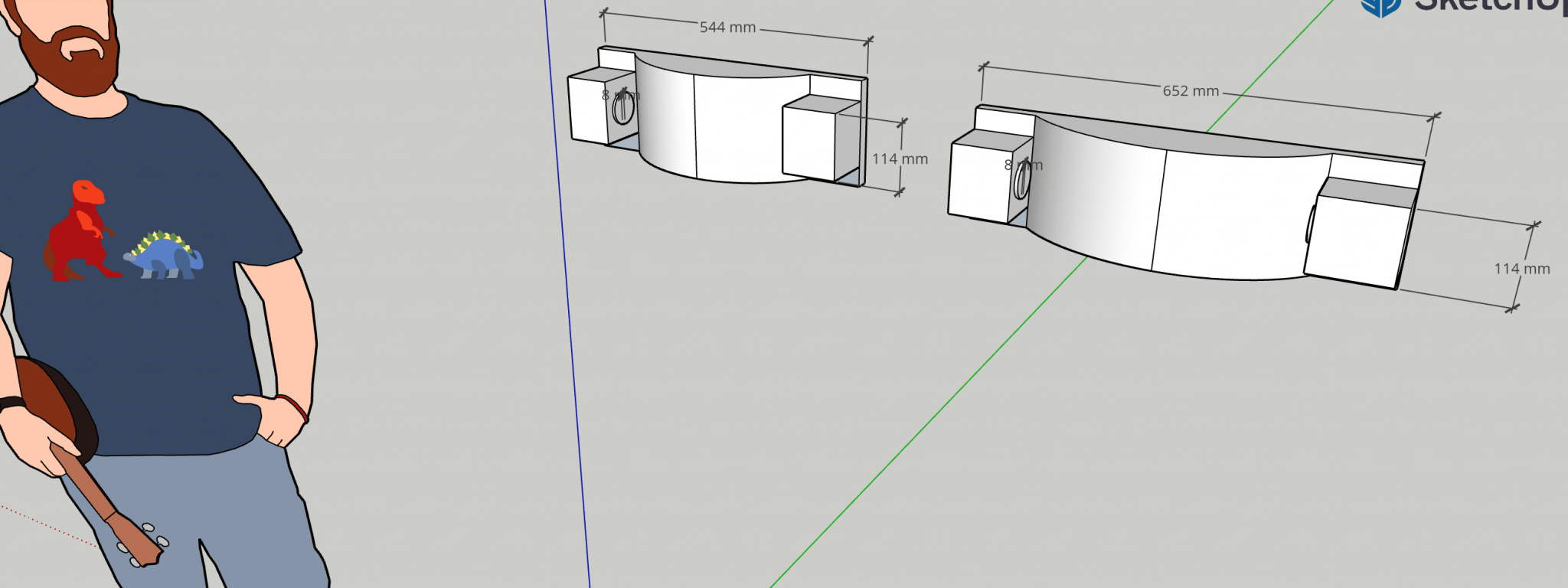

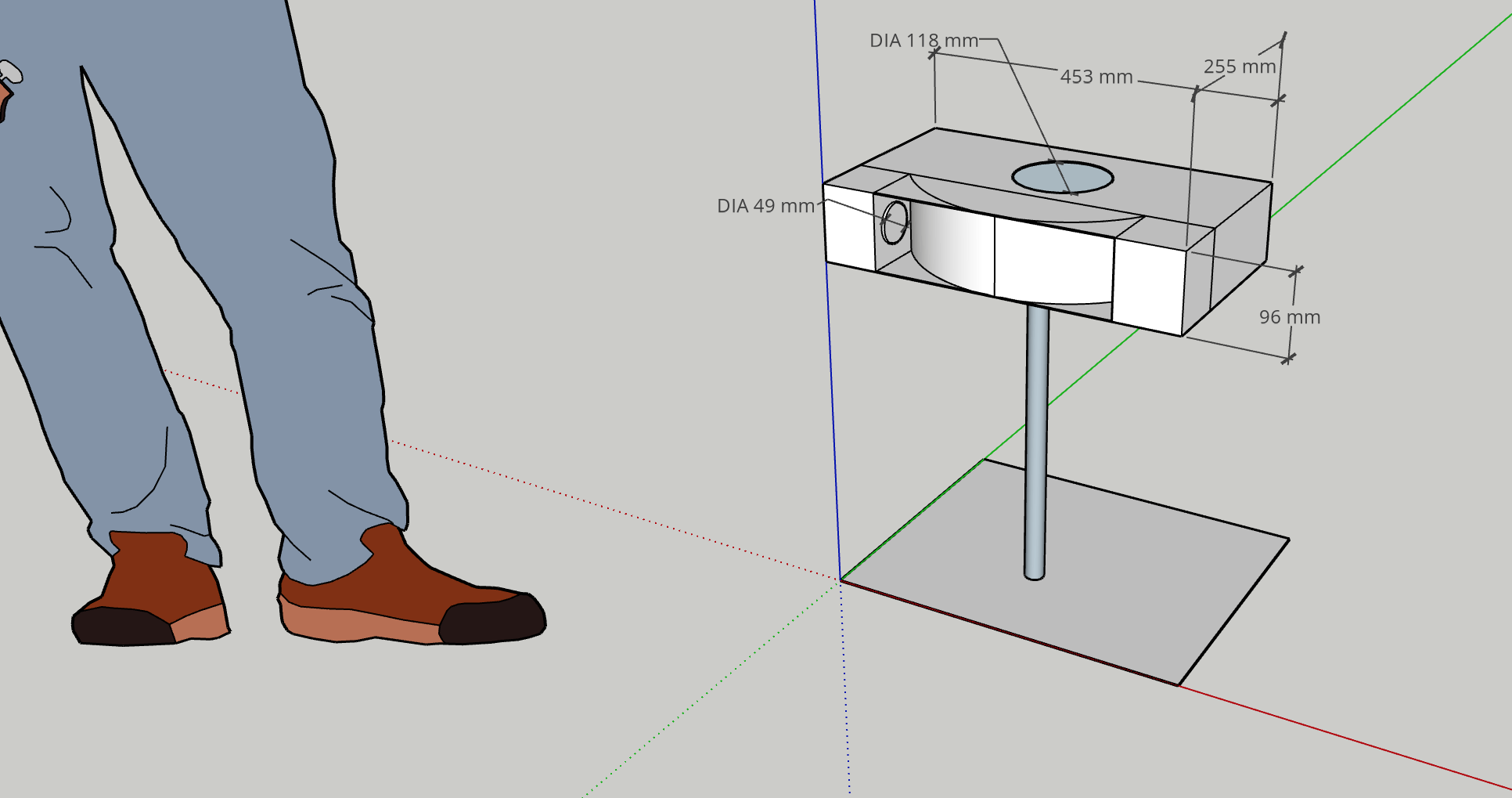

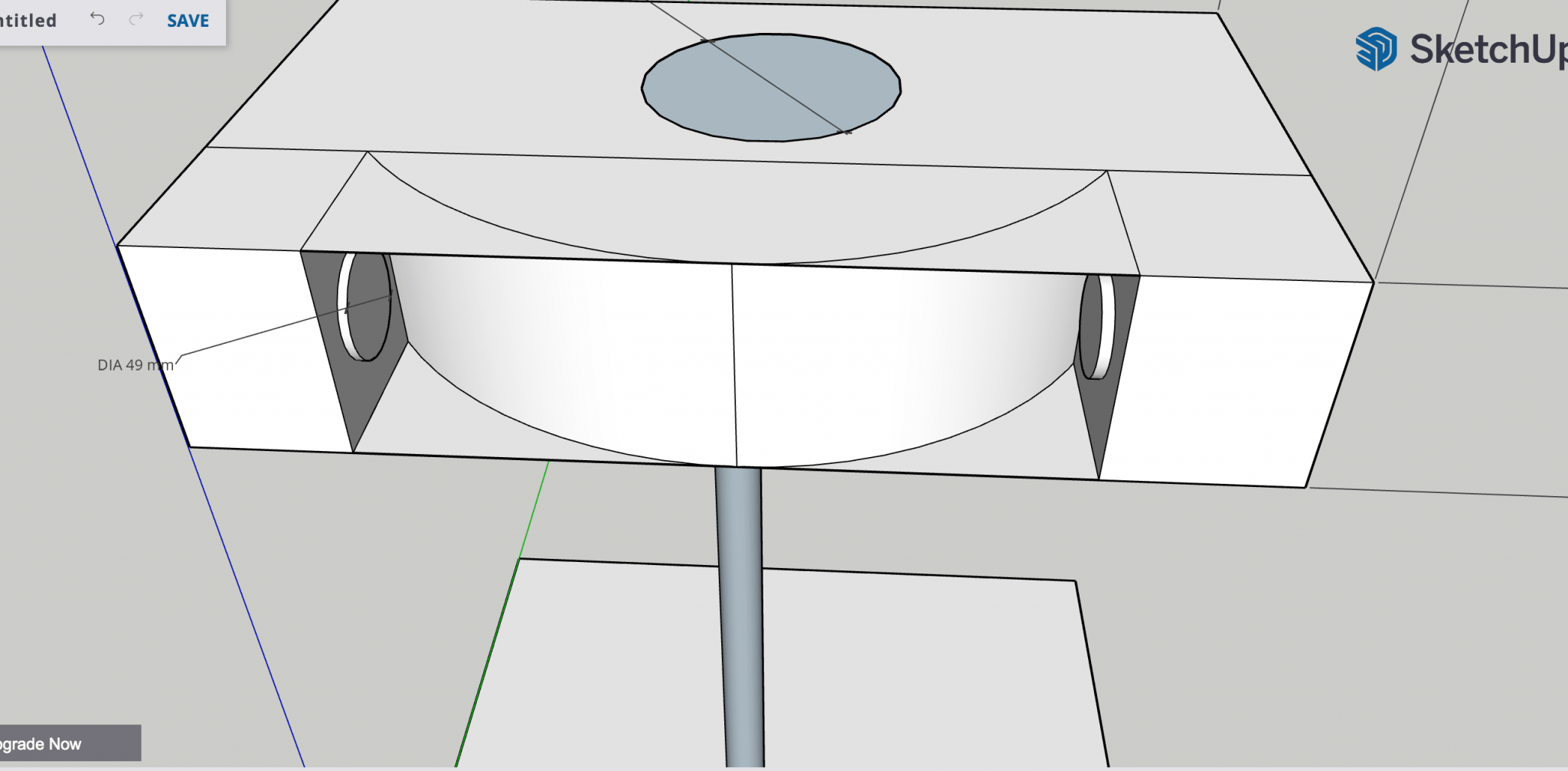

Very quick sketchup visualisation for 2x 2" full range drivers and a 5" mid bass-reflex. Crossover about 300-400hz. No idea how it would sound.
Those Sketchups look pretty reasonable!
When I scratch my head and think about it, I'm not totally clear why this would give a wider stereo image than regular wide dispersion direct speakers...
The center of the two curved surfaces are only about 300mm apart. To the man with the dinosaur shirt and ukulele, would it sound like the sound is primarily emanating from that small curved surface, or something wider?
Some foam core experimentation next week!

This is a very useful effect. But I can't quite visualize how the curved surfaces would achieve this. If you sit far to either side, you won't see the opposite side's curved surface at all, and presumably would only hear the (twice) reflected sound from that side. Or at an extreme angle, does the convex lens effect actually strengthen the volume of the opposite side speaker somehow?When you move to the left, you get more of the right and vice-versa. Also, I imagine having the drivers facing inwards and not directly reflecting (first reflection) from walls can only improve things in a bad room.

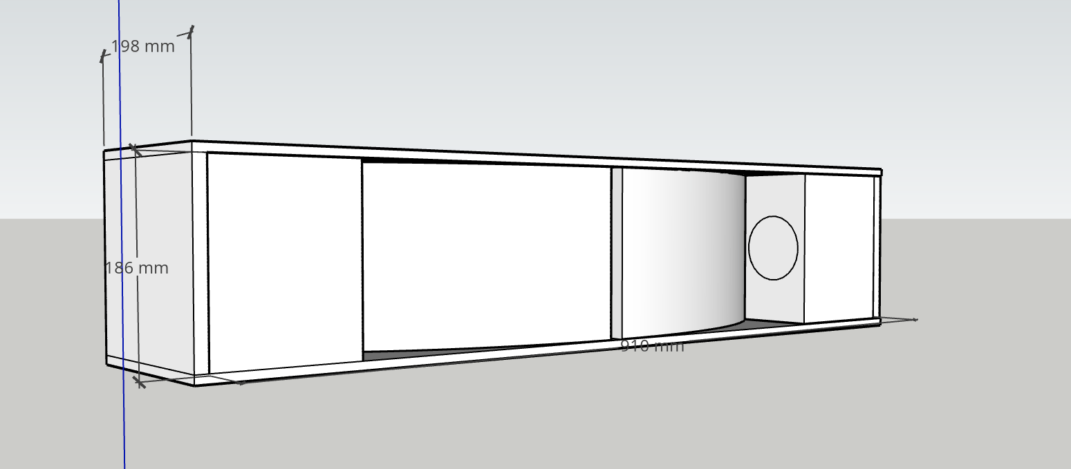

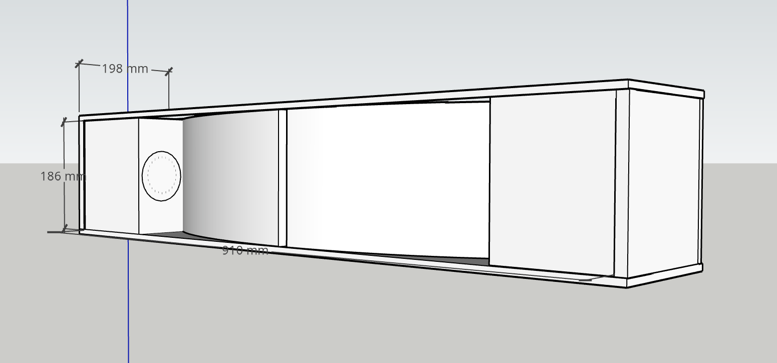

No, but you see the opposite side's driver itself. So as you move to the left the right driver becomes more direct. See sketchup demo.
But this is still reliant on a symmetrical (or thereabouts) room. You are basically creating the same stereo triangle, but with wall reflections. What if one wall is higher, or you spend most time closer to one wall than the other.I had some really nice results with back to back speakers placed diagonally in a corner - ca 1 m away from walls. Then I had suddenly the stereo effect across most of the room.
I guess I'm getting confused as to whether we are trying to reduce the reliance on the room or increase it. I assumed that in an asymmetrical old English house I was aiming at reducing.
Anyways, I get annoyed at long theoretical threads where no-one actually builds anything, so I better go away and put my money where my mouth is!
