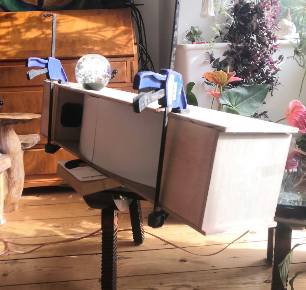

So, I put together this proof of concept box out of ply, foam board and some battered tc9-fd full range speakers, and can confirm it works.
It does create a sense of stereo soundstage and depth of field wherever you move within 180degrees. Even with one driver essentially facing directly away from the ear, the stereo holds up. Maybe narrows the centre point, but certainly its there wherever you move on the horizontal and not phasey. I'll need to finish the box with a mid-bass driver and live with it more obviously.
Now, I'm not going to claim its as good as my main speakers if I'm sat in the sweet spot in the room. I just want to get this clear again. This is intended for a room where a properly placed stereo triangle is impossible or pointless.
But there is proper sounding stereo even in weird parts of the room. I think this will not work full range however. I'm not sure I liked what it was doing around 80-100hz sounded boom-y, but crossed over to a single mid-bass will be interesting.
I don't have the expertise to measure these in a way to prove the stereo performance. maybe someone could advise. Or maybe someone else could confirm/deny my experience.
I'm mulling over getting the size down by using a pair of 2" Aurasound ns2's whilst still managing to get a decent 6-8" midbass in the same box.
I think the theory is that the two opposing drivers should not be able to see each other, so this size came from the size of the tc9 baffle and achieving a perfect circle arc that covers that depth.

It would be interesting to get your thoughts indeed. Been panning whilst sitting well to one side and I can hear when low end isn't rolled off if muddies the reflection and reduces the effect. I think the curve probably acts like a bit of a horn, boosting lower mid levels so they sound louder than the important highs.
