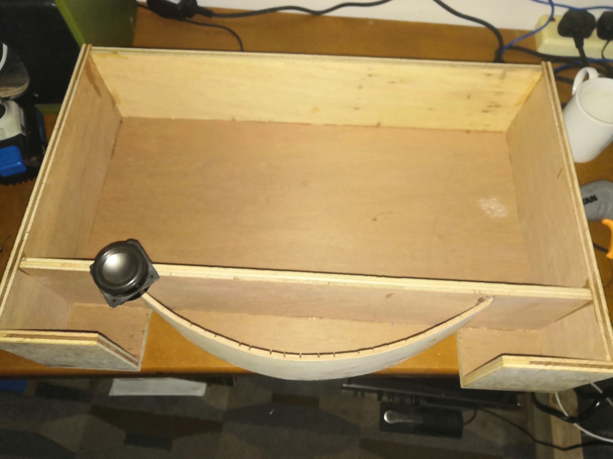

Struggling to find the time to get my 2nd prototype done, but this is where its at. With one of the Aurasound NS2's 2" drivers for scale. I've been theorising that the stereo effect is probably only likely to work from 1khz up and that I might want a single mid driver as well as a sub, but I'm going active, so will probably eq any problems away.
It will either revolutionise the world of audio forever, or my daughter will like it in her room.
I'm very excited that you are trying this out!Struggling to find the time to get my 2nd prototype done, but this is where its at
It might be worth experimenting with the angle of the drivers, as well as with some louvers (like the Metregon C45) to control at what angle you are starting to get a peekaboo listen of direct radiation from the driver.
As for the Elias SSS (or Sum/Difference) approach, well, yeah, solid left/right projection is pretty much impossible.
Combining the signals electronically (rather than acoustically) works pretty well - it's the theory behind the fairly common Mid/Side microphone technique. It takes a little brain wrangling to wrap ones head around how a front facing cardioid mic and a side facing figure 8 mic can produce proper left/right results.
But in the unpredictable world of imperfect reflective surfaces, all you can hope for is a hint of stereo separation (but you DO get plenty of randomized spaciousness). Prototyping in my workshop I can certainly hear a test signal somewhat bouncing left and right, but it's all pretty diffuse.
