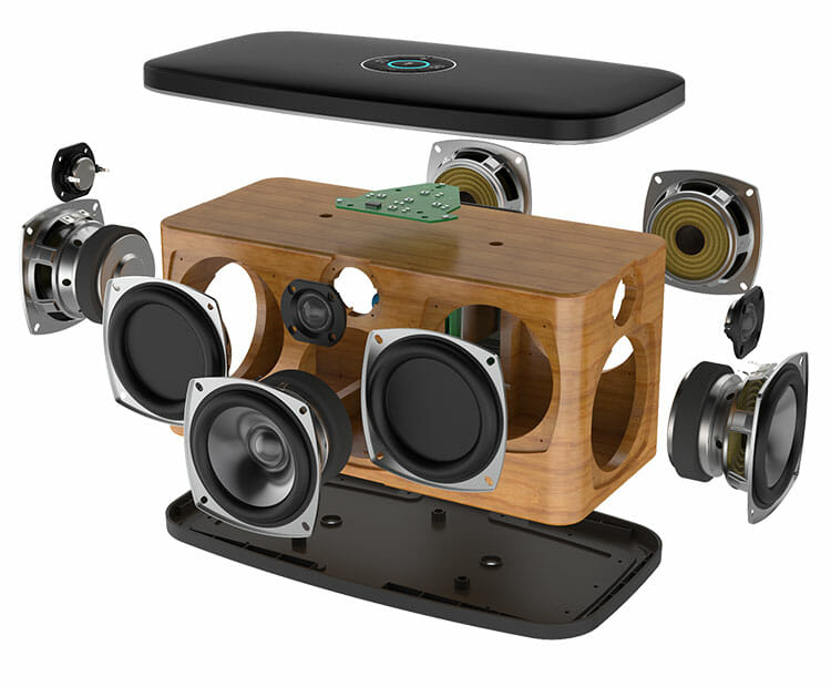

A Google search came up with the Riva Stadium. Three woofers, three tweeters, four passive radiators.
Presumably can play below 55Hz, and at 106db, in a pretty tiny box. It uses their patented "Trillium" system for one box stereo. Looks a lot like a version of the familiar 3-driver layout.

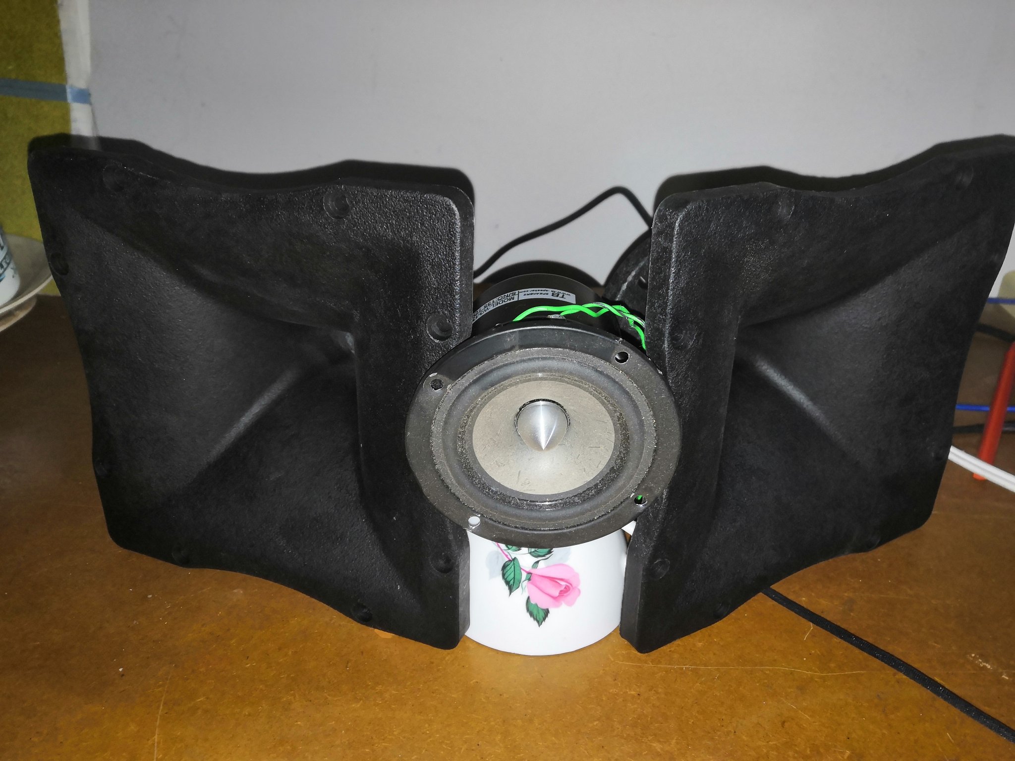

What about two 2" horn flares in "side" (M/S) with an additional "mid". A bit like this exhaustive prototype I've bit together (not). I guess it requires a 90degree corner placement (?)

Now I can see your picture.Right, form an orderly cue to shoot this one down;
With a full-on Sum/Difference matrix, this could work!
Using two horns kind of makes sense. By controlling the dispersion of the Side signals, you can avoid them overlapping and cancelling out (since they are the same signal, but one is inverted). A sideways dipole (open baffle or closed box) will also do that, but with the horns you have the option of pointing them forward a bit. I'd consider putting the horns on a swivel mount, so you can try to aim them at some good reflective surface.
The side signal usually contains very little bass, so the low frequency reach of the horns won't need to be very deep. But I think you do need to get down to something like 500Hz.
You probably couldn't use an "amp-hack" kind of matrix for this, since the speaker types are so different.
But it's very important to include that coffee cup in the cabinet, that's where the magic comes from!

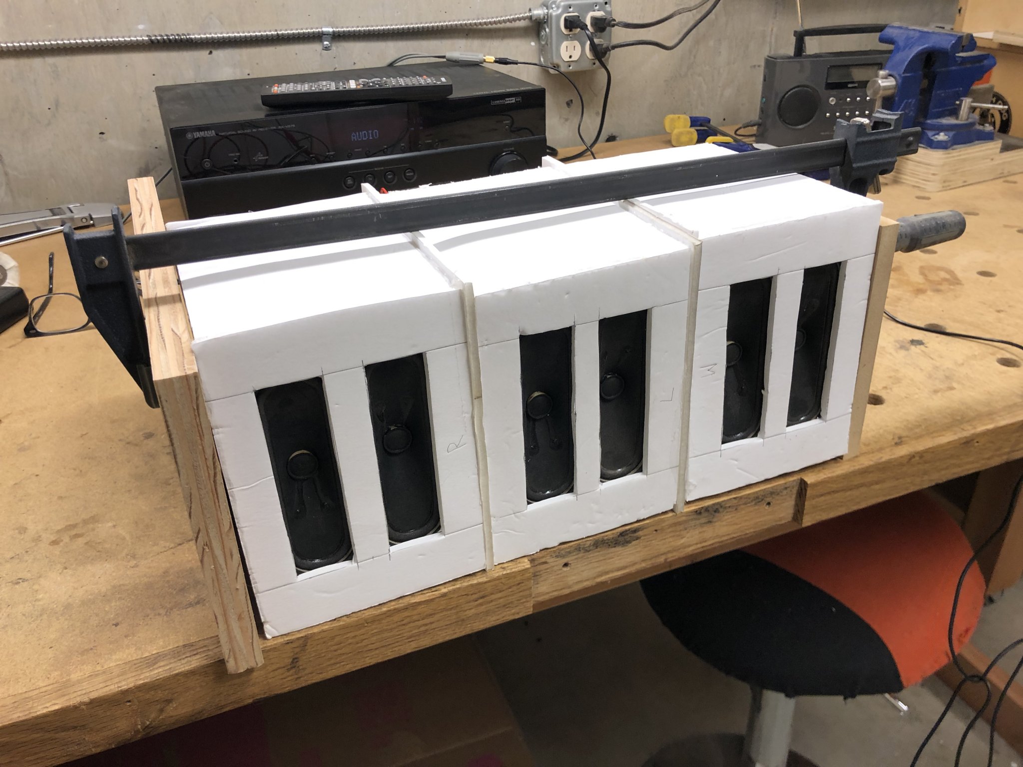

Okay, I finished a prototype a foamcore prototype for the 6-speaker matrix posted earlier.
It's actually three separate sealed (barely!) boxes, so I can play around with angles. The tops are open, so I can play with wiring options, which is why they are wearing a plywood hat, and a vise to weigh it down.
As a reminder, the speaker layout is this:
L+ R+ R+
R- L+ L-
So in theory each box with a speaker pair is supposed to work as one unit.
The center box is the easy one, with left and right, both wired positive, so this box is, in other words, the Sum.
The left box is playing left positive as well, but joining it is the right negative signal, subtracting anything that also plays on the right channel. Presumably this blend/subtraction should happen seamlessly in the air.
The right box is the same as the left, but with the phase inverted.
This will do two things.
1. For an instrument panned hard right, a positive signal will play in the center and right hand boxes, while the negative signal in the left hand box will cancel out that instrument in the left field. It should stop the right hand signal from being heard from the left, and it should psychoacoustically push the right signal further right, to where it appears to come from outside the speaker.
2. For an instrument panned hard center, the signal plays equally in all six drivers. However, the negative signals in the side boxes will cancel out all the signal coming out of those boxes. So a center panned instrument, often a lead vocal, will only be heard from the center speaker. This should promote width and separation from the left/right.
I'm still fiddling with angles and wiring options, but for my early tests I found that I preferred to wire each side (left and right) in series (with one driver wired inverted). The original diagram uses a parallel/series configuration, which I think puts more emphasis on the center drivers.
My early results are somewhat positive. The system DOES promote the sense of width beyond the physical speakers. The left and right drives have about 14" of distance (center to center), and I measured how far apart the speakers feel, and that fell to around 32".
Not too bad, but it's not the big, room filling spacious sound I've gotten with a Mid/Side setup. Or perhaps I should say workshop filling sound, because in the workshop the Mid/Side tests worked great, but in the living room it fell apart.
Here's the downfall of the 6-speaker matrix: For it to work, you have to listen to it perfectly at ear level.
Any experienced speaker designer could probably tell you why. The two speakers in one of the boxes are as near each other as possible. Even then, one I stand up straight (rather than crouch down to ear level), the sound of the two drivers in a box now arrive at a slightly different time, noticeably breaking down the phase cancellation that this whole thing depends on. The stereo width quickly collapses.
More experiments to come!

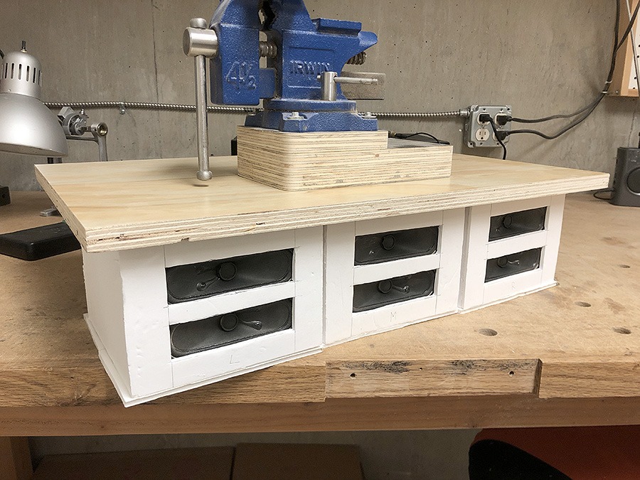

Some more tinkering...
To avoid the sitting/standing collapse of the stereo width (due to loss of intentional phase cancellation), I rotated the boxes 90 degrees.
After a few trials, I decided that the drivers are best wired (from left to right):
L+ R- R+ L+ L- R+
This way the R- and R+, and L+ and L- are next to one another, for the best phase cancellation effect.
This is quite a bit better. The actual distance between the outer drivers is 12.5", but it feels more like 40-45"!
The image is a bit more stable when moving around left to right, but as you might expect, it's nothing like a proper solid stereo soundstage.
For ease of experimenting with connections I ran them all in parallel this time. The are 6 Ohm drives, which means I was punishing the poor amp with a 1.5 Ohm load! At least I didn't play loud.
Splaying out the side speakers, or pointing them straight sideways, didn't work as well. Presumably it's because the potential for the intentional cancellation between R+ and R- (and L+ and L-) gets worse the further those drivers are apart.
A tall, flat, and wide monolith speaker box (maybe 36" high, 20" wide, 2-3" deep) with six nice 2.5" full range drivers in a row, and a flat subwoofer below, could be quite nice. Remember, with a 6-speaker matrix, any stereo or 2.1 amp will work fine.
Ultimately, summing left and right, and subtracting left from right, and vice versa, is probably still best done electronically, rather than acoustically like this.

Very good investigations. I'm not 'an experienced speaker designer' but two speakers with the same signal close together causes lobing - narrowed dispersion in the vertical axis (if they're one on top of the other) and a wider dispersion horizonally. It's often considered a positive because the wider dispersion horizontally is a good thing, and the narrowed dispersion vertically lessens near reflections. 🙂
Obviously there are other factors here!
Good points all.
Of course in this quest, especially with the 6-matrix-drivers-in-a-horizontal-line, all "proper" design considerations are out the window!
In the foam core prototype only two pairs out the 6 drivers play the same signal. But those pairs aren't very near one another, and at the high frequencies they absolutely will interfere, and mess with the dispersion pattern.
It's all a big mess, and it's all wrong. But it sounds pretty okay!

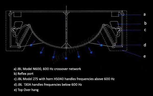

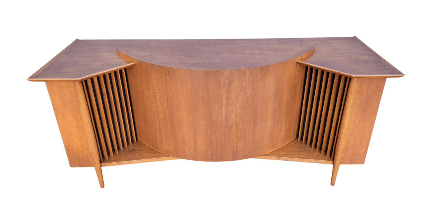

I just discovered this old beauty - the JBL Ranger Metregon C45!
The dual louvered 2-way speakers each bounces the sound off a curved surface, presumably projecting the sound widely, and produces a very big sweet spot.
Has anyone heard one, or something like it?
I'll keep this short (obvs), but thats a very cool design. Thats a compression driver right? And the curved baffle acts as an extension of the horn, which ends at the midpoint, presumably to avoid left/right overlap. I want one!
