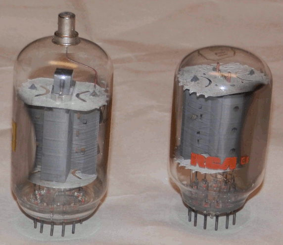

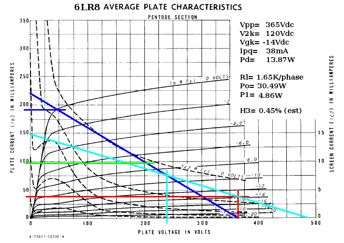

Don't forget about the vertical deflection types. The 6LR8 comes in the large, nine pin format that has a triode and a beamer in the same bottle. The loadline looks pretty good with a very low H3 estimate, and is nicely away from Class B conditions. The 1K65/phase load translates to 6K6 (P-2-P) and that's a stock, off the shelf, impedance for OPTs, so no custom OPT required.
The triode can be used as a grid driver, saving a bottle. (I have a bunch of these in their 21V heater iteration.)
Another decent TV VD tube is the 10JA5. This one can put out a bit more power. The H3 estimate is somewhat higher, though. The 5K4 (P-2-P) load is also close to stock OPTs.
As for how these sound, that depends on what kind of harmonics they make. If like the HD types that make mainly H3 and little else, just add enough gNFB to take the edge off. If the harmonics are nastier, use local NFB in conjunction with gNFB. You should always listen open loop before finalizing the design.

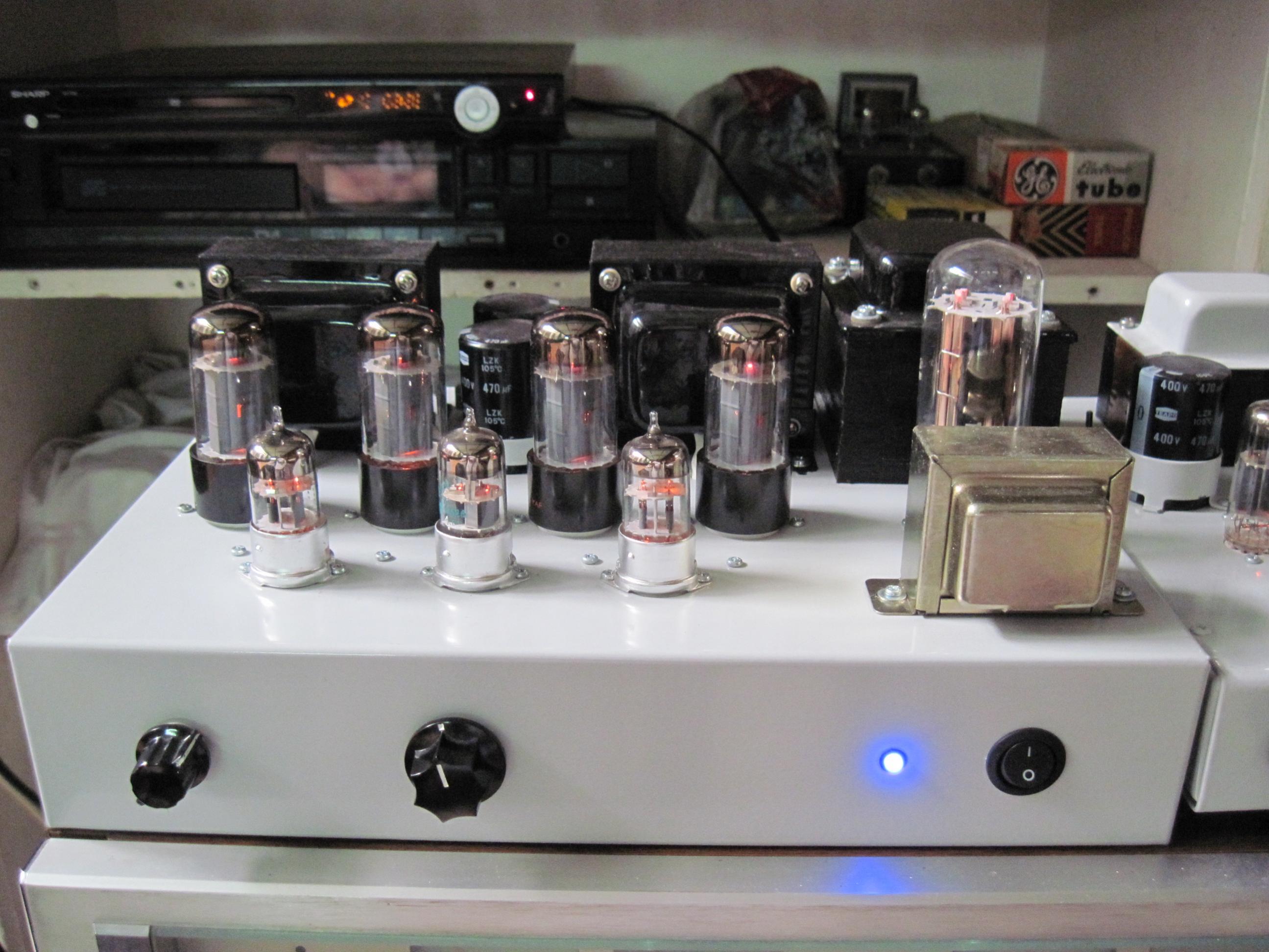

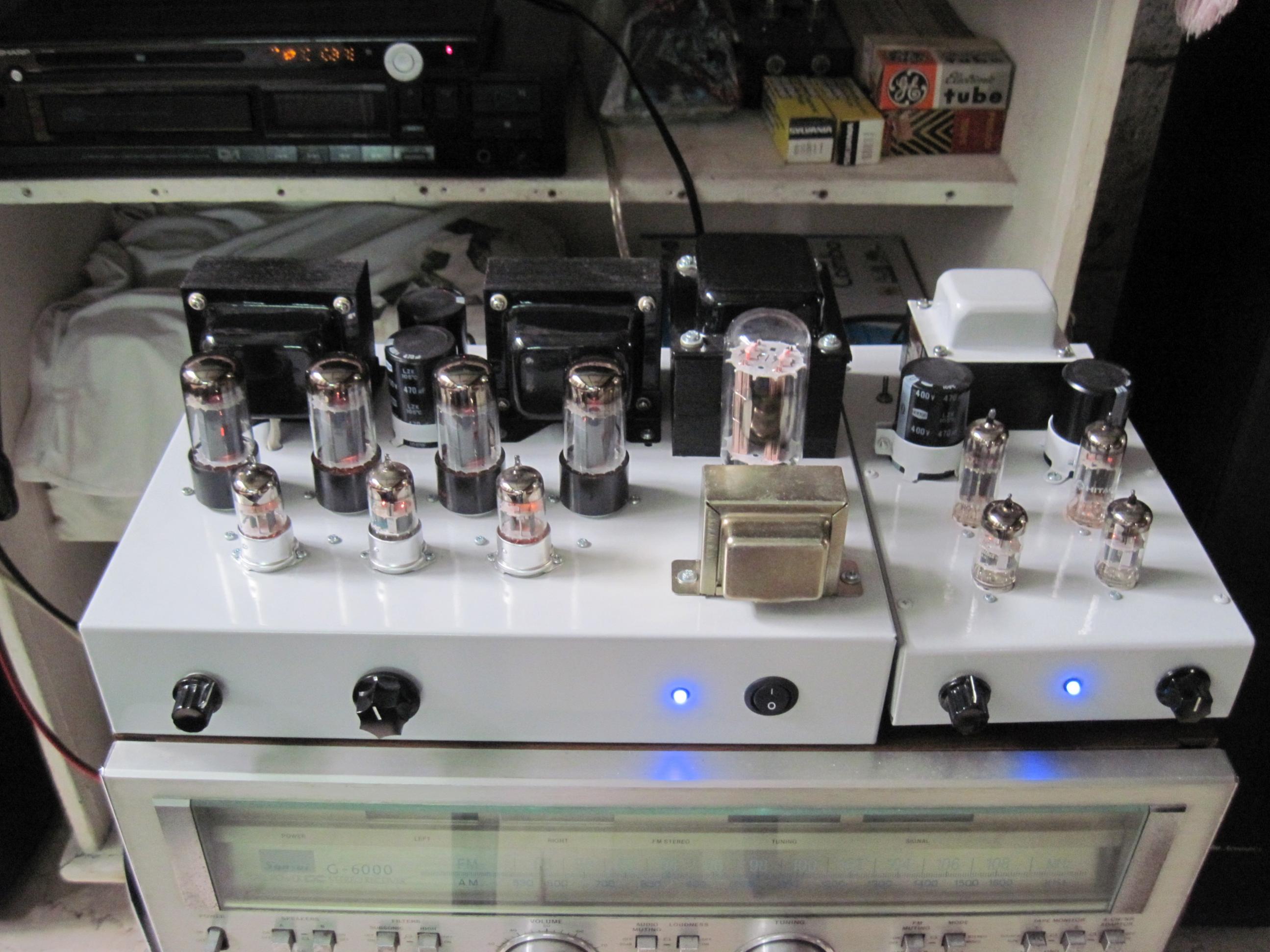

Well...much talk about amplifiers using sweep tubes...not so many that actually made one. I made one for 30 yers ago and its still in duty-...so it must have prone its liability. Its whopping out 85W / 8ohm and even more in 4ohm in the same and only outlet. Plate voltages is only 300V and its UL coupled (50%)...plate impedance 1900ohm. That gives an output impedance on 0,8ohm and a damping factor at 10...before feedback is applied. When..feedback which is only 12db is applyed...then the damping factor increase to 40 which I am very satisfied with. I am aware that PL509/519 are scarce by now...but EL509-JJ is a VERY good replacement and made for audio. I call it *THE FINAL AMP* because I have never wanted any other amplifier. My friends claim the same..😛.

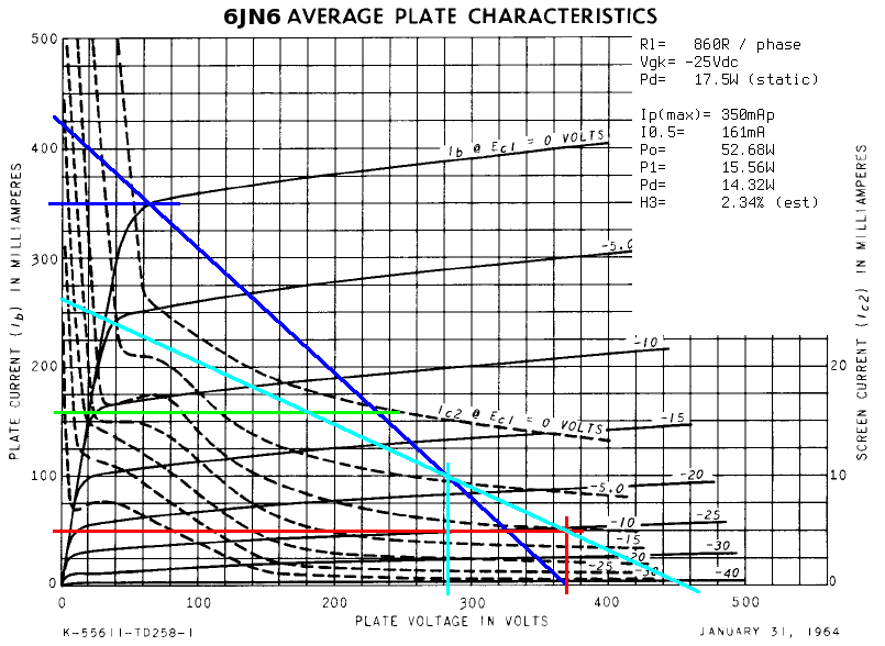

Here are a couple of TV HD types that have some excellent loadlines. These are the 6JM6 and the 6JN6. So what's the difference? Other than one has a plate cap, and the other doesn't, the *JN6 has a somewhat smaller Crt. The plate characteristics are the same. The loadline shows a very low estimate for H3, and these could put out some 50W. The 3K4 (P-2-P) load impedance should come close to stock OPTs.
Might not be so good for screen drive, as the V2k spec is a bit higher, coming in at 220Vdc. For conventional grid drive, however, these could prove quite useful. They also come in some odd heater voltages: 16.8V/0.45A for both types, and 12.6V/0.6A for the 6JN6.
Here, you can select your types and have identical performance for those cases where you'd like to avoid a plate cap.
Both require the duodecar, 12 pin socket.
One possible downside is that this type seems liable to snivets. That means either screen stoppers and/or a positive bias on the beam formers, which are brought out on their own pins, not internally connected to the cathode. Still, a type well worth considering.

Horiz. Outputs:
6JN6, 6JM6, 6GE5, 6GV5, 6DQ6B, 6FW5 (17 Watt) all apparently the same tube except for pinout and capping details. 6GV5 and 12GE5 were available for 1$ for the last two years. A smaller version, the 6GF5 is still available at 1$, (smaller bottle, only 9W, but great for a HV screen or CFB driver at 770V B+ rated)

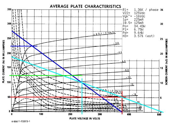

For screen drive you need to look at gm2 at equivalent plate currents.
Some cases rated at 80 mA plate current:
6HJ5 2380 (24 Watt tube)
21HB5A 2450 (18 Watt tube)
6DQ5 2573 (24 Watt tube)
6JN6.... 1905 (17 Watt tube)
6JG6A 2440 (17 Watt tube)
6CB5 2158 (26 Watt tube)
6LB6 2845 (30 Watt tube)
6L6 799 (30 Watt tube)
EL34 916 (25 Watt tube)
6LR6 3267 (30 Watt tube)
16/21KA6 2450 (18 Watt tube)
13GB5 1750 (17 Watt tube)
The last two tube types above are still available at $1 each.
