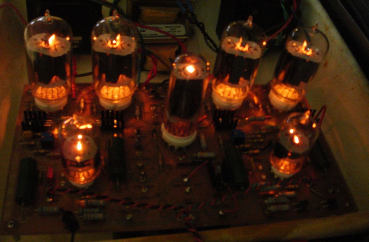

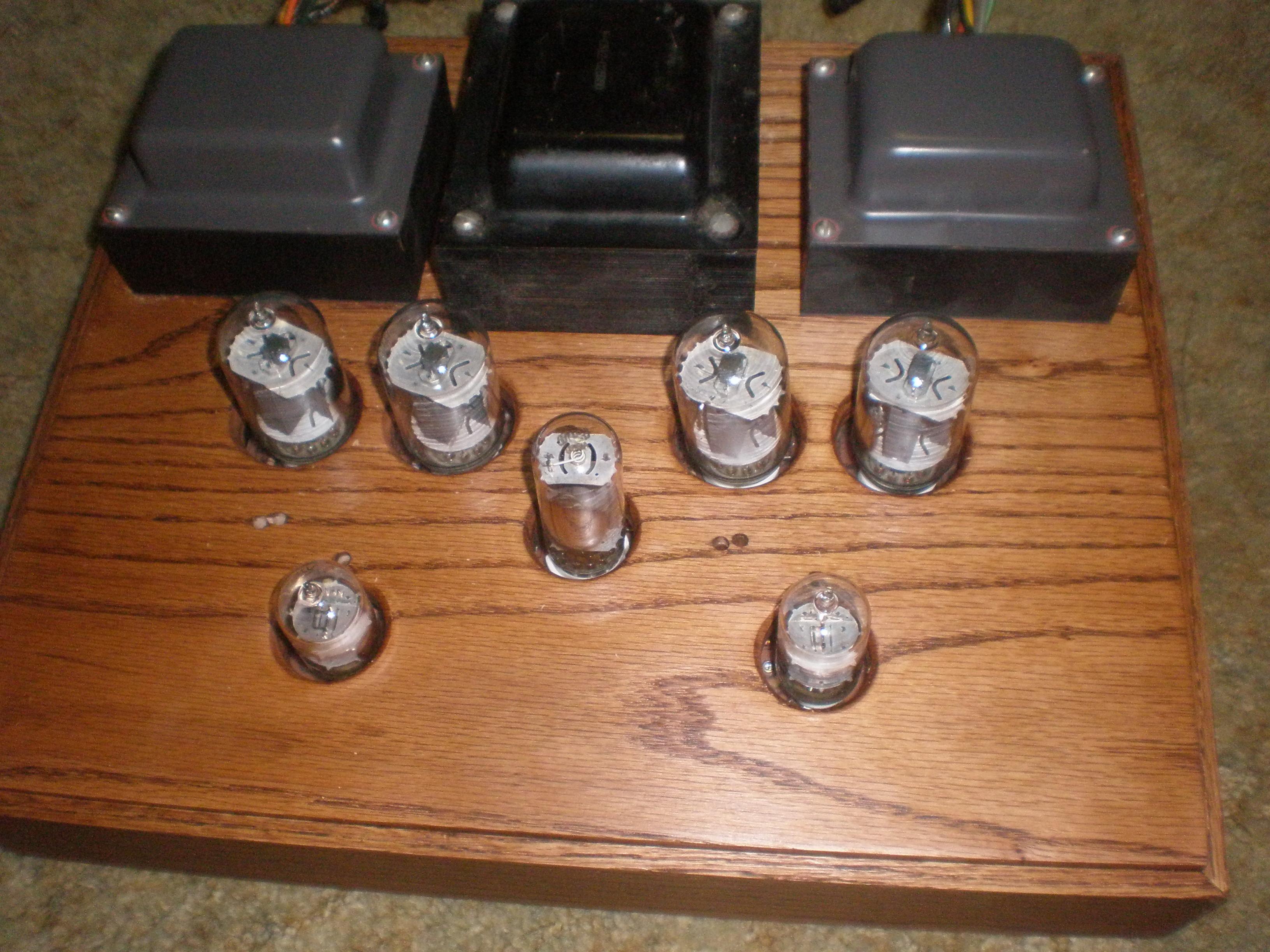

I have several pairs of transformers from 6L6GB and 6L6GC amps, pentode mode.
I would like to do screen drive. I have read that TV sweep tubes? are generally ideal for this.
Any recommendations? I have several power transformers good for 400+ volts as they came from 6L6GC applications.
I have the schematic for the drive circuit already. I'm not sure if the GU50 would be suitable in this case as it seemed to sound better with 65 to 70 ma idle current per tube, so that might be excessive for the transformers, unless anyone has experience with the GU50 that dictates otherwise. I have only built the one power amp using GU50s, so the fact that it sounded better with 65 ma (versus 40 ma) might have been more due to the OPT than the tubes.
If this has already been covered, kindly redirect me. thx

Screen grid drive usually allows designers to use less than the typical idle currents for the tubes. So that should be OK. The GU-50 has about 1/2 or less of the g1 gm of the typical TV sweep tubes, which gives it good linearity for g1 drive (less closely spaced g1 to cathode). But for g2 drive it has 1/2 to 1/3 the gm2 of the typical TV sweep tubes. Since g2 drive is already quite linear for any of the tubes, the lower gm2 of the GU-50 just makes for difficult screen grid drive swing. The higher voltage swing required on g2 would also cause the plate V to drop well below the peak g2 voltage, causing some screen current excess.
Most any of the TV sweep tubes with a 220V max screen voltage rating (or lower) should work fine for screen grid drive mode. Look for ones which give the g1 curve set at 150 V on g2 (or lower). Also, look for ones with low screen currents.
Some tubes that have been tried in the past or recently: 6LQ6, 6HJ5, 35LR6, 26LW6, 26HU5, 21/33JV6 (and similar: 21HB5, 6GY5, 21JZ6), 6JN6 (and similar: 12GE5, 6JM6, 6DQ6B, 6GV5) or are still on the $1 list: 13GB5, 16/21GY5, 21/29KQ6, 17GJ5
Plenty of other sleepers around too. G2 drive candidates have not been well explored.

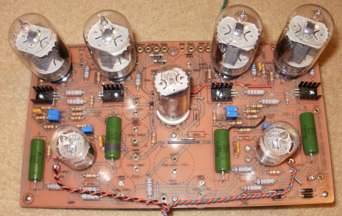

latest amp design running set of 17jt6 outputs, will also run 13gb5 outputs with a couple jumpers
To use those Horizontal Output Tubes in Audio.

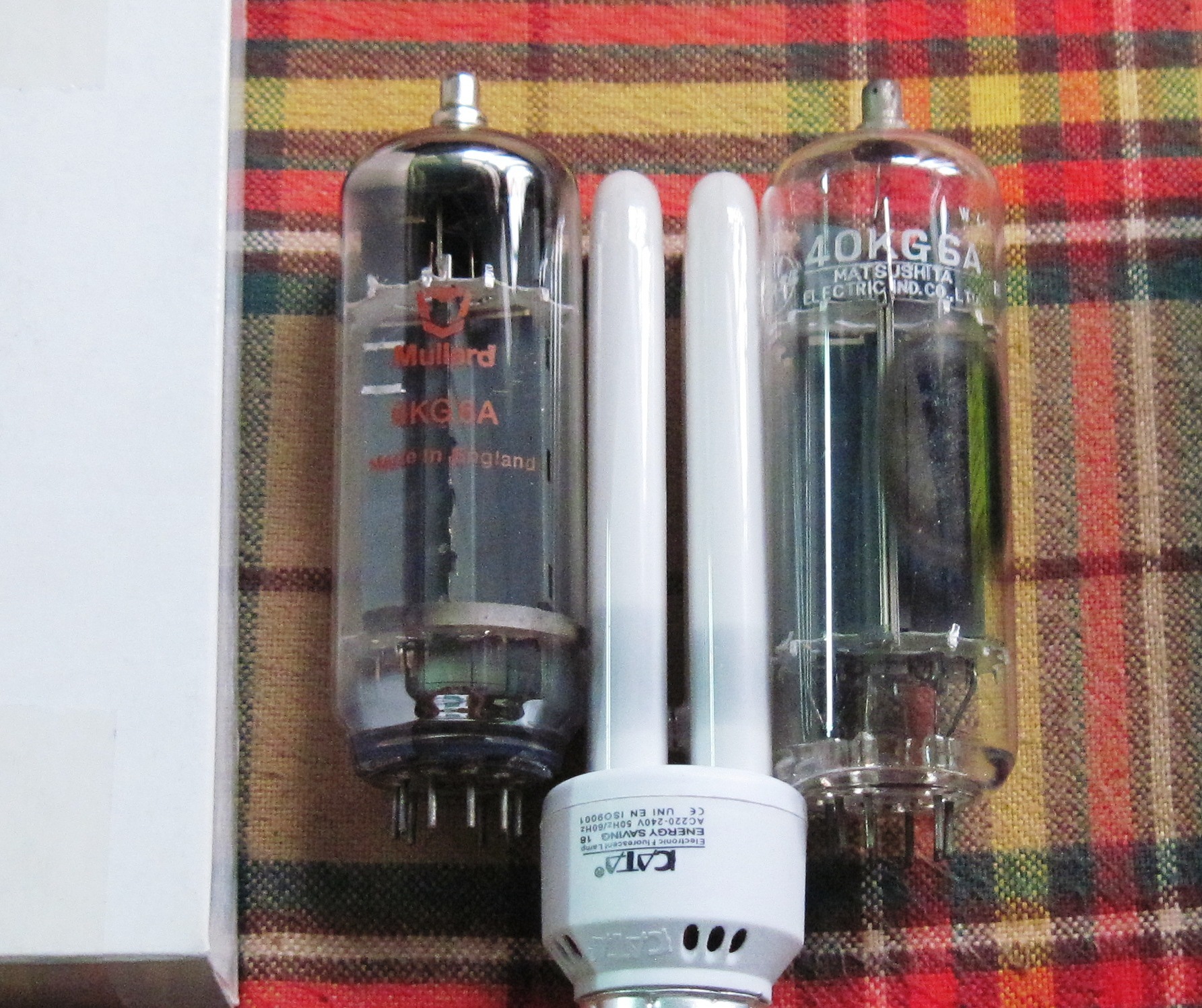

The 13GB5 will take 35 watts before the onset of glow.
That depends on who made the tube. Most of the "American brands" are Mullard made tubes and they indeed will take 30+ watts without glow. I have extracted over 100 watts from a pair for an hour without plate or screen glow. I have over 100 tubes and have tested about a dozen. They are all the same.
I have one used Matsushita (Panasonic) tube that will start to glow at about 25 watts.
I have several new unbranded "Made in Korea" tubes that glow unevenly and at different power levels from 18 to 25 watts.
One of the great secrets of the type is that is has an U shapes anode whitin the anode. that is spot welded to the outer anode. This anode takes all the heat when you load one whit 60 watts.😉
