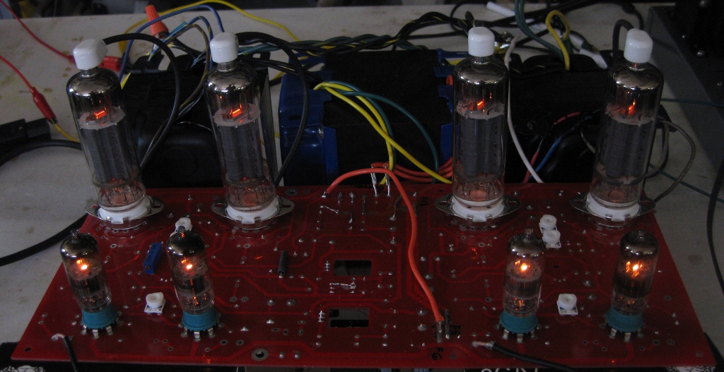

Pete's Red Board using 13GB5's mounted directly on the board. I drilled new holes right into the board to install the chassis mount 13GB5 sockets.
Getting 45 wpc with 320 plate volts and 170 screen volts with a 2k4 output transformer.
--edited to add pics but can't seem to load them right now...
Have you run the 13gb5's yet? What impedance are your OPT's?
I was going to etch a new PCB, the first one is built up and running with the 17JT6 output tubes, in pentode mode. I have 60 of them, perhaps a life's supply. Also is dependend on the heater tap on the PT.
I'm using 6.6KRaa outputs for a larger class A operation, with minimal feedback. I'm running 89db speakers. @ 4 ohms, using 4ohm tap.

Now running 1k9 output transformers for an honest 60wpc rms both channels driven using 50 cent 13GB5 aka PL504 tubes.
Can you say D-Y-N-A-M-I-C-S this amp's got it! The transformers, Hammond 1650T's, are idling along, but they sure seem a good impedance match for the 13gb5's.
310 volts on the plates, 170 on the screens. 70 mA idle bias current.
These things have no right to sound as good as they do! Thanks to Pete for a great board!
I need to add a touch of global feedback and mount this stuff on a decent chassis.
