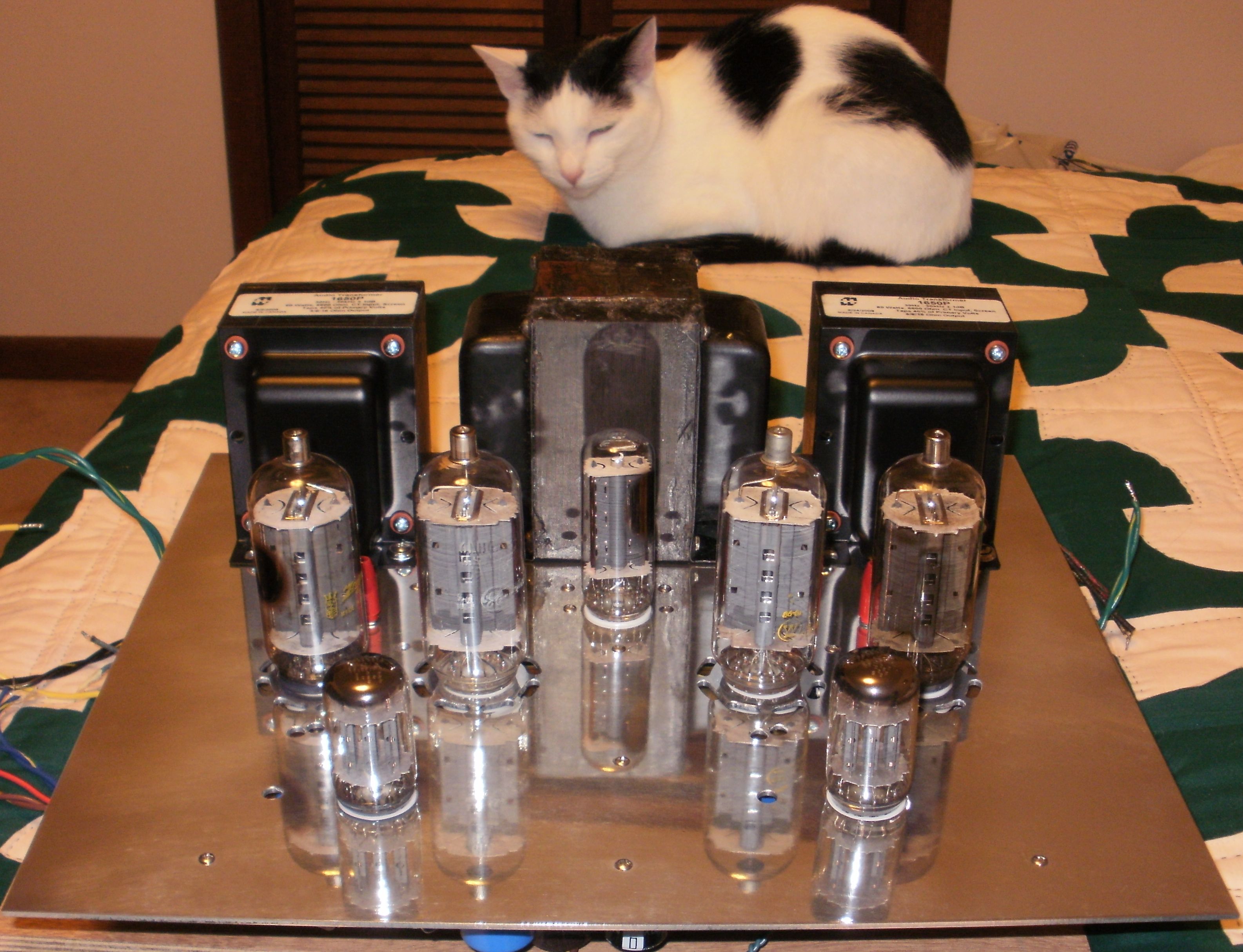

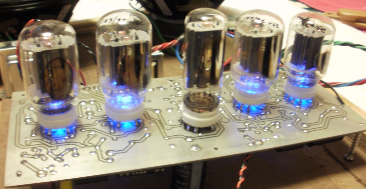

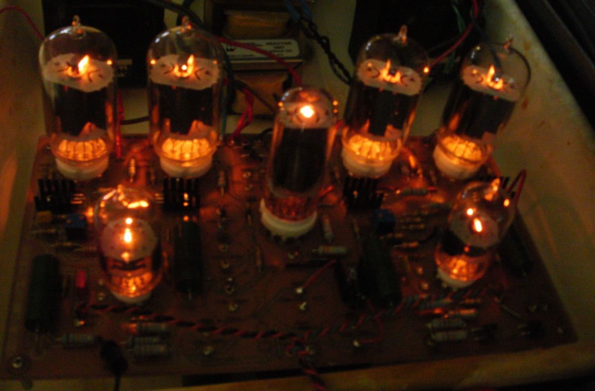

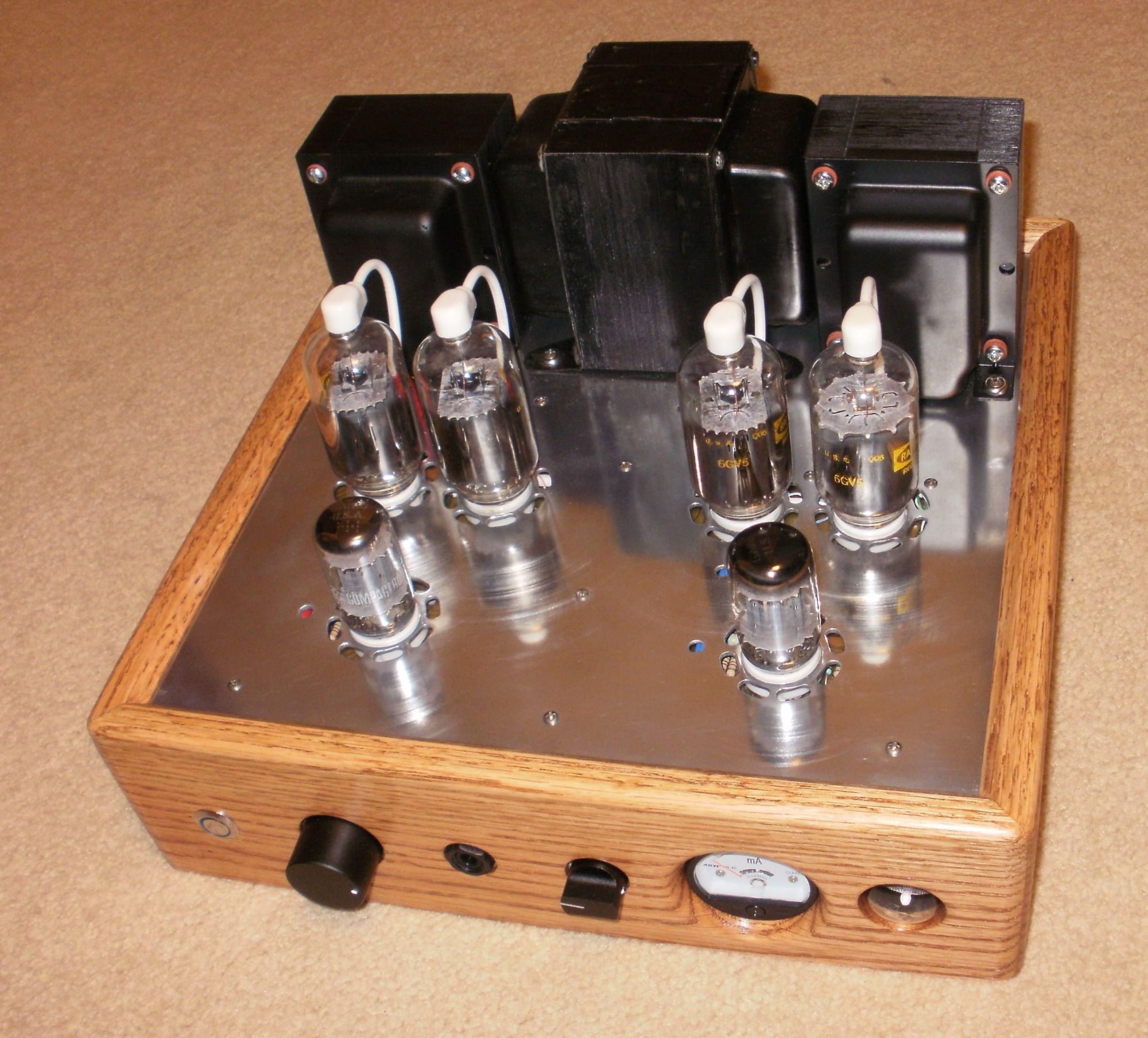

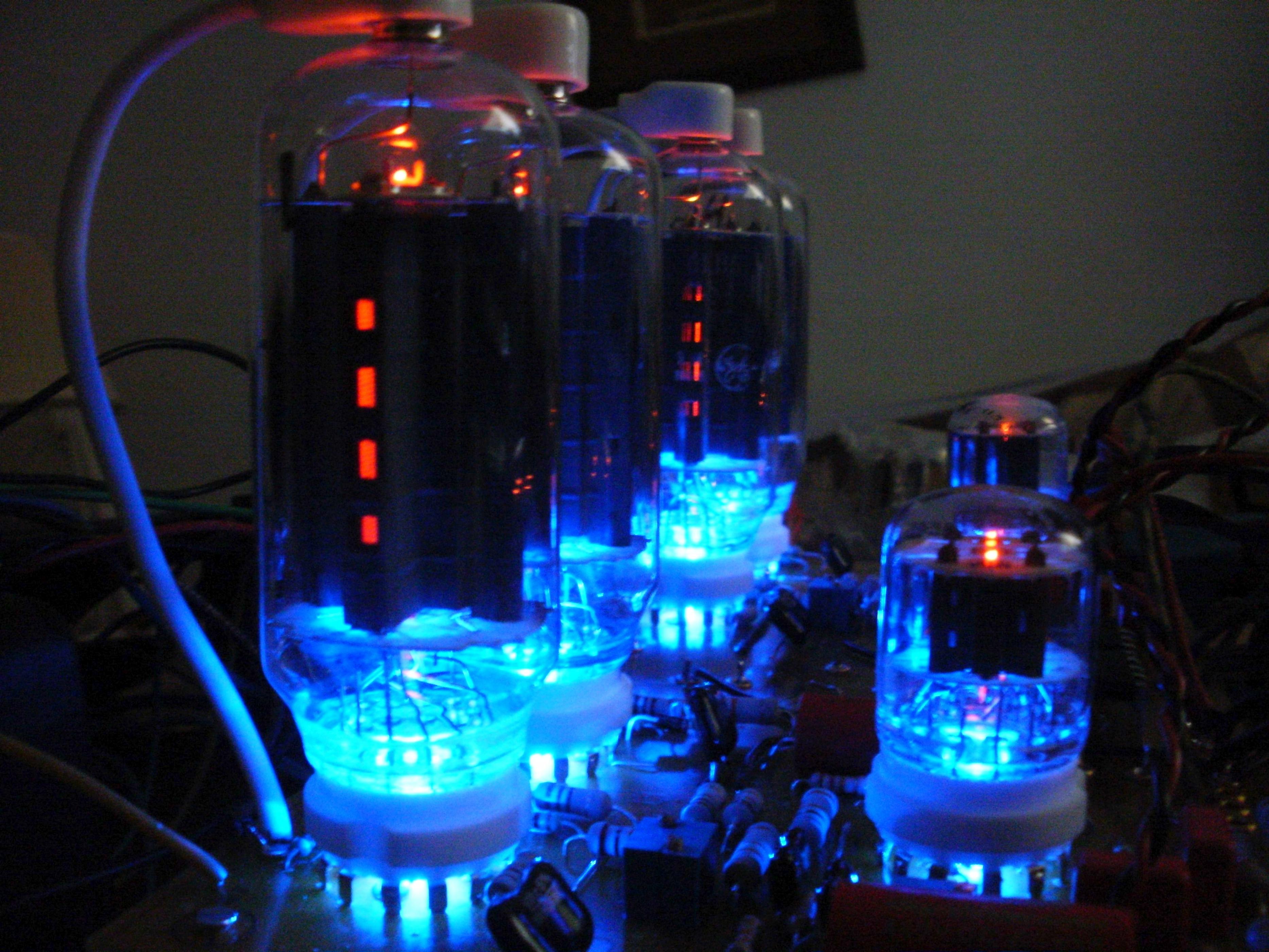

TV tube amps
I've been playing with TV tubes for a couple years and almost prefer them for audio amps. It started with 6U10 triple triodes for the front end and LTP splitter and 6JN6 (6GV5) for outputs. I did my 12 pin amp variants ( 6LB6) for several more designs and played with the 9 Pin variants. I'm still playing with the 9 pinners.
http://www.diyaudio.com/forums/tube...cheap-highish-power-pp-amp-4.html#post3543207
KEGGER inspired me to do a PCB for the 6L6 family of tubes with a little 9 pin driver tube, the 6JT8 and its variants. it was a fun project and I decided to modify it with 6JT6 output tubes and try N-Mosfet grid drivers. 🙄
I'm currently listening to the little 17JT6 PP amp and it is all the amp that I need for my listening setup and room. I'm running 40 watt hammond 6.6KRa iron and the output tubes in pentode mode, 160V on the screens. ( second last pic).
The last pic is a 6LU8 PP amp that I did and it is a great little amp and was my main listening amp for many months. It had enough power for most listening, but ran out of steam when it was cranked up. ( only 14 watt tubes...)
I've asked Edcor if they would be interested in a multiple heater configuration PT for the sweep tubes to allow the outputs to be 6, 13, 17 volts that does leave the 21, 30 and 40 volters out. I was targeting 410V on B+ to use 450V caps with out stacking. 20 watt output tubes it seamed about right. Time will tell if they are interested.
