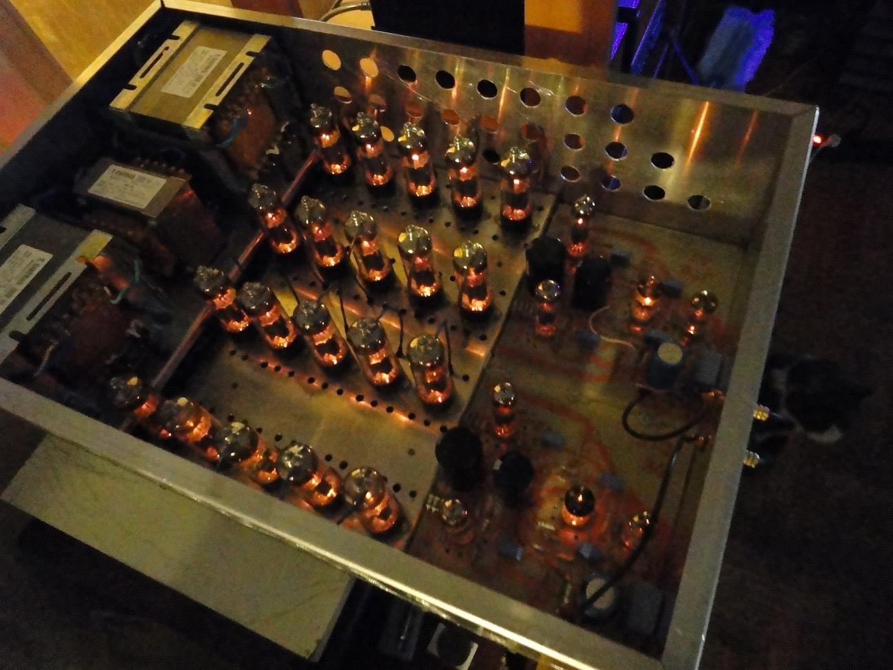

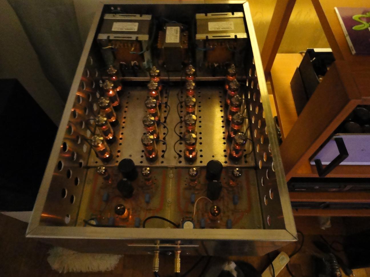

I use mostly television tubes in my amps , like PCF802 in the RIAA preamplifier , and PCC88 and EF183 in the analog stage of the CD , and PCC85 , PCL82 and RFT PL36 in my Circlotron OTL tube amplifier , and I think PL36 is very good and stable tube and performs well too .
Here is some Photos .

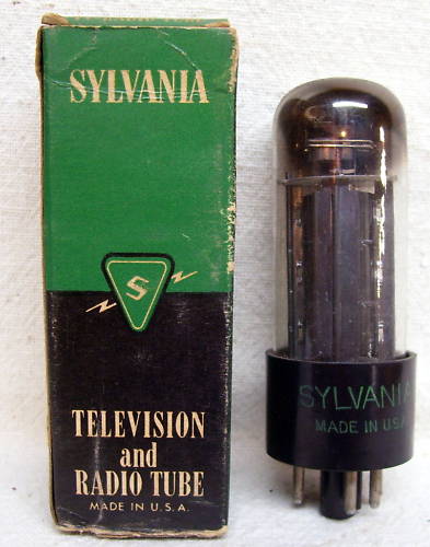

"Would you want to find some NOS black plate RCA 6L6GA's in a tiny bottle with a different pinout for $3 each?"
6BD5GT ?
http://frank.pocnet.net/sheets/127/6/6BD5GT.pdf
6BD5GT ?
6BD5GT ?
Thats it. Can't see who made yours. Mine are ITT branded RCA's.
UH OH, the price is rising already and I only have 2. OH well The 6L6GA isn't powerful enough for my tastes anyway. I have extracted 250 watts from a pair of REAL TV tubes!
Note the pinout is the same as the 6AV5, 6AU5, 6FW5. Dissipation is downrated to 15 watts in the tiny bottle, but I haven't actually tested that limit yet.
With other overstuffed tubes (the 6AQ5) there is a fine line between the max rating and a hole in the glass. Meaning, don't red plate a 6AQ5. Rge red comes in one tiny spot.....followed shortly by a depression in the glass.....then a hole!

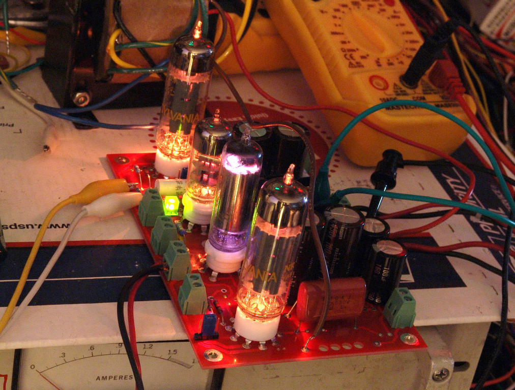

I had been hesitant to mention a certain number since the Chinese had been buying them from ESRC by the 1000's. I discovered this gem when it hit the $1 lists over a year ago, but at 35 cents each I bought 500. It is the 6HA6/6HB6. This guy is a 6BQ5/EL84 with an odd pinout and twice the Gm. It can bang out 20 watts per pair in P-P without breaking a sweat. They can be seen here in one of Pete's red DRIVER boards putting out 7 watts in class A P-P. That will drive the grids right out of your favorite sweep tubes! Pin compatible with a 6EJ7, they plug right into Pete's board.

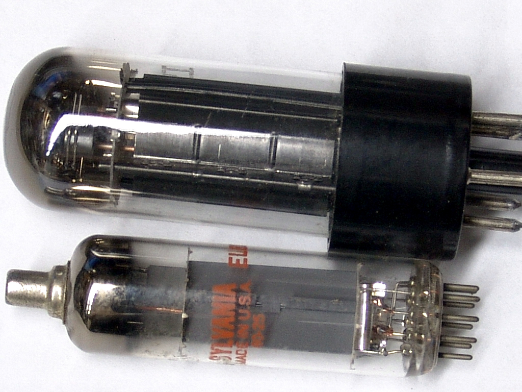

In the sweep tube department I grabbed 100 25DN6's. The specs show 15 watt plates, but the tubes say otherwise. I have extracted over 100 watts from a pair at the edge of glow. The plates of the RCA's and Sylvania's that I have in hand are about the same size as the 6HJ5's plates.
Speaking of 6HJ5's......I bought enough stuff to get a nice price on 100 of them. Expect some more BigWatt amps in the future. I will wire a few 6HJ5's together and see what happens.

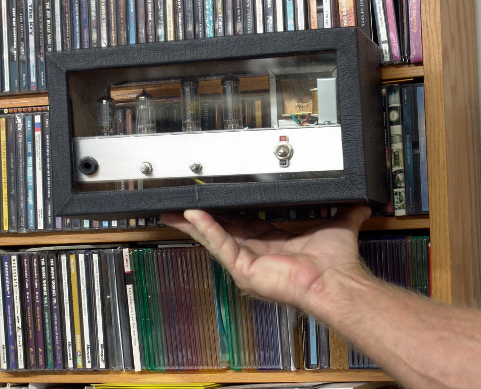

I also got enough 50 cent tubes to make complete kits for the next Tubelab project board. It is amp 1.3 that was created in this thread:
http://www.diyaudio.com/forums/instruments-amps/190738-hundred-buck-amp-challenge.html
The picture shows the amp as it was last November. I still haven't finished the cabinet yet though. The schematic is still going through some changes. I have added a mosfet phase inverter so that the output tubes can run in class AB and crank out about 6 watts.
Did the big dumb blonde one stop to think how much 1000 tubes would weigh? NOOOOOO. The UPS man deposited two very large and heavy boxes on my front porch while I was at work today. Total weight 68 pounds.
I couldn't say no to these guys at 50 cents each! The 6922 is just for size comparison......those were not on sale. Actually they were free......I pulled them out of a junk scope.
Now I just need to find the time to light a few up.
Interesting, they sure look bigger than a typical 15 Watter. Will be interesting to see what your "stress test" will produce. Might check the filament current draw just to see if the later versions still pull as much current as the 1955 datasheet specs. The 1955 date on the Sylvania datasheet would likely be using an old high temp cathode, while the later tube types got lower temp cathodes. Maybe they upgraded these later too.
