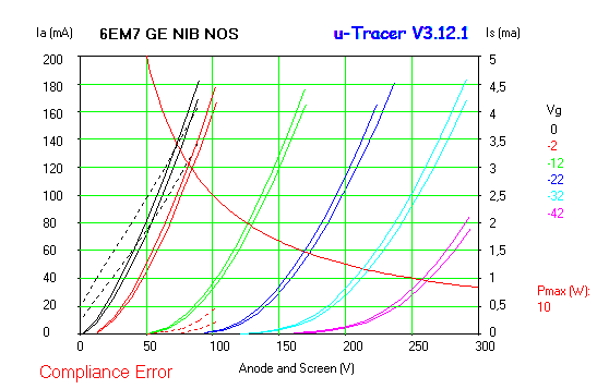

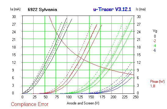

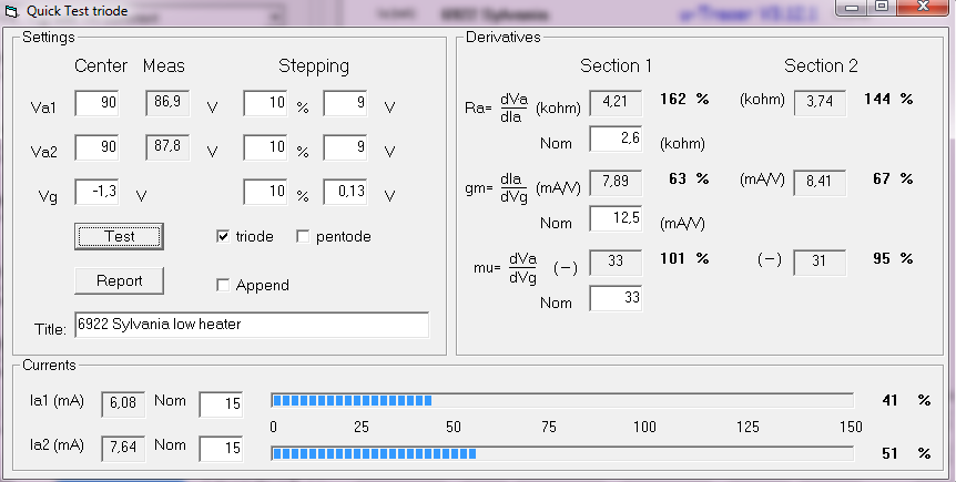

I've measured some tubes with low and high heater power, like 5.5V and 7V for 6.3V tubes
First, results from a mid-aged 6922
In this graph, the low and high heater results are superimposed, and the high heater are the most left coloured traces, eg.: for 0V is solid black for one unit, and dashed for another the "right" solid black are lor heater and the "left" solid black are high heater. Same for dashed and other colours.
I made for see if it alters matching and to appreciate differences resulting from similar but not exactly equal devices.
I've also included two quick testings, one for low heater and other for high heater.
OOps...
I included the graph for a 6EM7 and not for 6922. I include here the graph for 6922
By the way, the 6EM7 graph follow the same rules but since are dissimilar triodes, is more difficult to make, but at least is visible. The high-mu section is clearly the most affected. The low-mu section are barely affected by heater voltage
PS.: this is a Magnificent Television Tube, for spud and driver projects

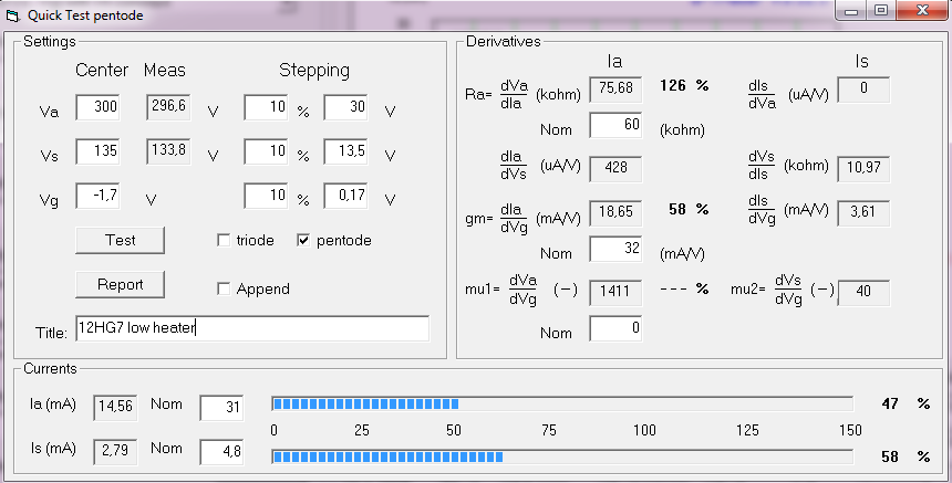

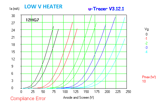

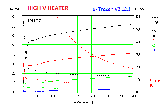

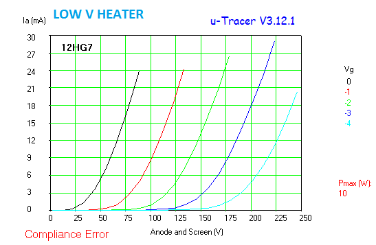

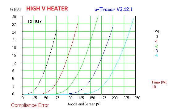

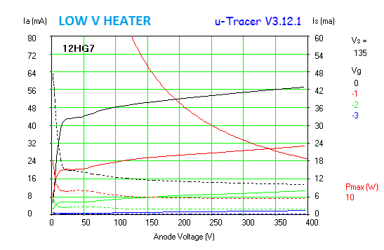

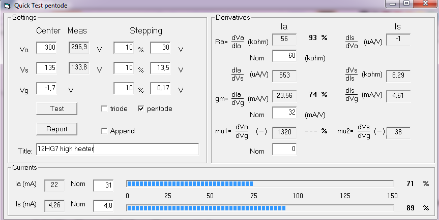

And now for a 12HG7/12GN7 (Westinghouse, used), a high-gm tube
Smoking-amp, about cut-off region, I not explored this but I under impression which this is exactly as you said, since the curves are not compressed diferently than usual, only changes a little the position of cut-off ...

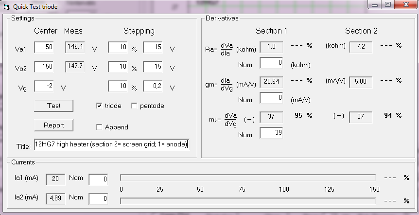

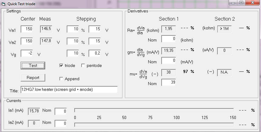

How current distributes between anode and g2 in triode mode?

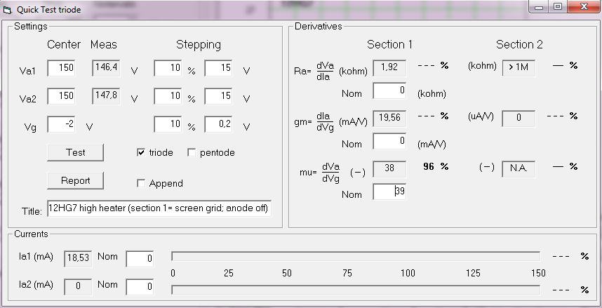

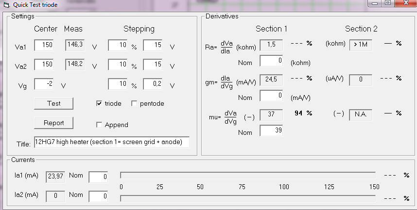

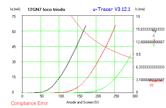

A last one, resulting from some test connecting errors 🙄😀
But probably the only interesting ones...
By "accident" I've measured the 12HG7 in triode mode with g2 and anode in different mesaurement probes in my tracer (like in pentode mode measurement)
The results are interesting. Some distribution of parameters exists, like current per electrode and gm and so on
After that I connected the anode + g2 in unison, like the correct triode connection, and finally I connected only the g2 as a anode (this lower max pd but the µTracer measures with narrow/short pulses, so is OK). All resulted in some parameters differences.
Note when the anode are in one probe and g2 in another, the measured g2 gm are low, and the gm from anode are high. Also the rp from screen grid are HIGHER... strange, is the most close element to g1! And the measured current confirms the anode being the "section 1"
Only µ (mu) is the same...
Very interesting DIYBras (the heater variations). Looks like what I was seeing. Nice to see super-imposed graphs.
Can you re-scale the triode plate current curves for the high heater V by maybe 0.8 or so, and overlay on the non-changed low heater V plate curves? I'm wondering if the one curve set can be transformed into the other set by a simple magnitude re-scaling.
With the separate probes on g2 and plate, how do you get triode characteristics? Not sure what is going on there. Are the g2 and plate connected together?

With "strange" triode measurement (only when measuring the "quick mode") I set the tracer for measuring double triodes (one with each "high voltage" probe), and apply one probe to anode and other to g2. Maybe is interesting to graph this...
With normal triode-connected pentodes measurement it uses only one proble attached to anode+g2
Maybe this is a measurement/hardware artifact, but the current distribution makes some sense, so I start thinking about 😕

Oops, for completion/clarifying: the superimposed triode measurement for 12HG7 figure has a LOW V HEATER written in it, but is low and high at same time, like the 6922 and 6EM7 casesAnd now for a 12HG7/12GN7 (Westinghouse, used), a high-gm tube......
Later when at home I will make the scale graph test
