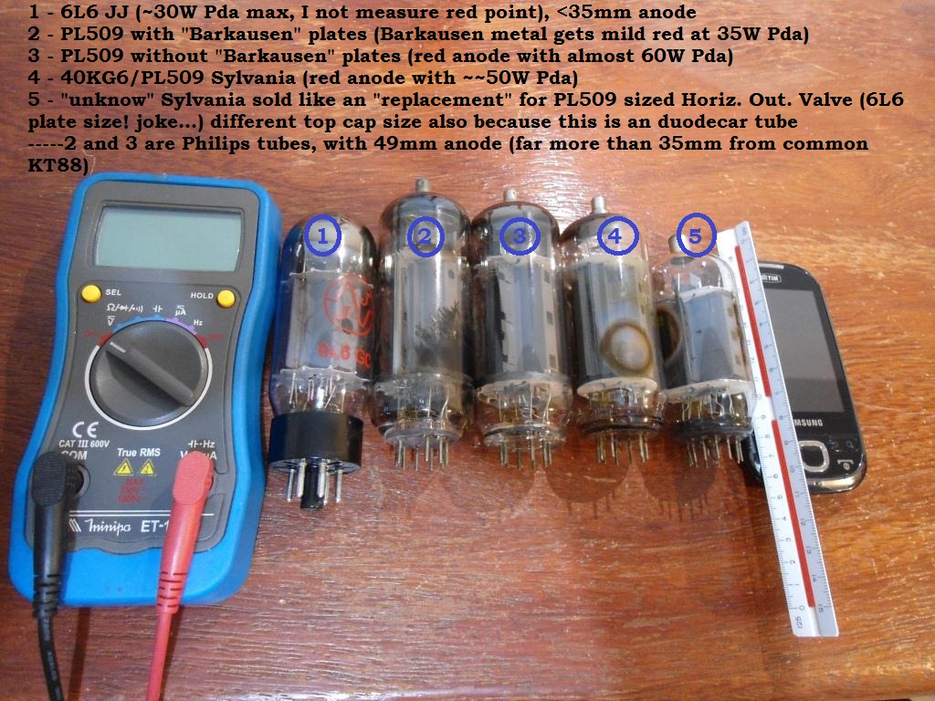

My experience with the PL519 is that the datasheet is -just like for all TV sweeps- very conservative. The plate can handle at least 1/3 more heat than the 45W abs max. No glow at 60W.
700V shouldn't be any problem either. Even the EL34 is rated for 800V like the KT88.The limit is the socket: the TT21 is the same as the KT88, but is rated for much higher voltages due to the plate coming out on the top instead of the socket.
I got way more than 100W out of a pair of PL509 in classic pentode, running at less than 500V into 2k. I'd have to look up the exact numbers.
I've got some experiments planned for higher voltages 600ish) when I got some OPTs that can handle that kind of power.
Yes, true and proven, but for one PL509 type. The ones with "Barkhausen" plates, those extra fins without black "coating", probably made to supress some image "snivets" in colour TV's using them, will show mild red glow at night with more than 34W, with the red spot located only in these fins. The "non-Barkhausen" will start to glow with the claimed >60W, or at least far higher than the datasheet spec.
But even the "Barkhausen" ones don't glow with average audio power (peak power), so in class AB/B amplifiers, we can consider high peak power with them, also (oops, less class A :mad::D:) ).
